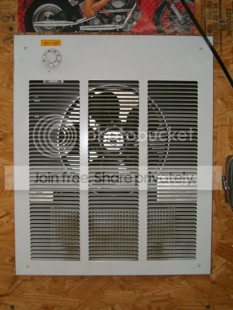

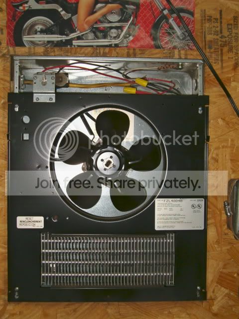

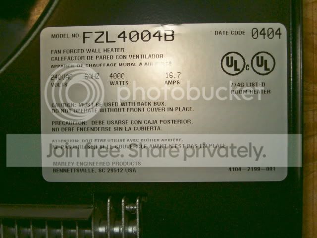

First off, I'm thankful for having these in my shop....heat is king when its 10 degrees outside:

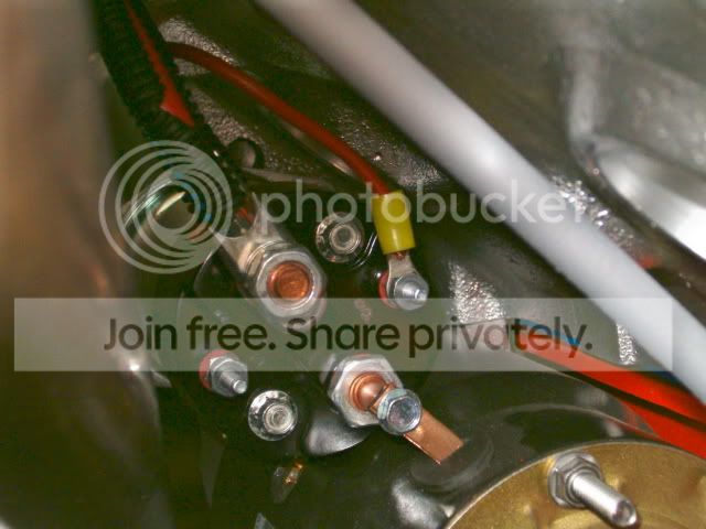

I think I got the wiring done enough to fire the engine in the frame.....
DOES THIS SOUND RIGHT:
4 ga. from battery POS to starter main; and NEG to block, and frame. (I will be using 1/0 for final cables)
10 ga. from battery POS to junction block, and from junction block to pushstart to starter S terminal.
14 ga. from junction block to ign on/off to dist. battery term.

So the wiring is right?

Yeah, the wiring looks fine for now, assuming you are not wiring the alternator, and are just going to keep the battery charged with a 120V wall charger while you run it?
What water pump are you running? Are you running all accessories and just not wiring hte alternator for now? Or do you have a water pump only belt? You serp water pump needs to drive backwards right? I know you know this, but as a friendly reminder, make sure you don't spin your power steering pump dry.
Also, for the final run in the truck I would use 10 or 12 gauge or so for the HEI to make sure you have enough ignition power, but a short run of 14 for the break in will work fine. Personally for that engine I would would want an MSD 6AL box to go with your HEI in the truck.
