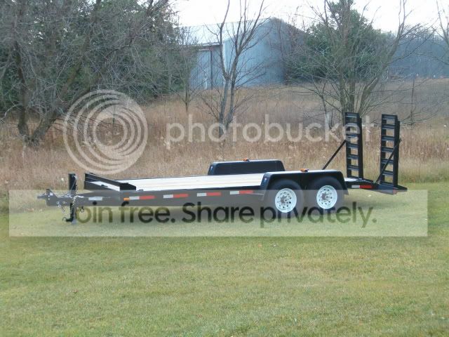

A new chariot for the Iron Maiden:
this should get me to Moab without having to worry about overloading my present car hauler, or spending $1000+ for heavier axles, and tires/wheels.
I should be able to pay for more than 1/2 of this one by selling my other trailer. That would make it about a wash for putting new 5200# axles, tires and wheels on my other trailer.
Got it for 3200+tax+license.

Nice trailer Dave, so nice to have something you don't have to worry about.

I'm glad I went this route on the trailer too, One less potential problem for the Moab trip, and even closer hauls. This load will be all my truck wants to pull I can feel that.
