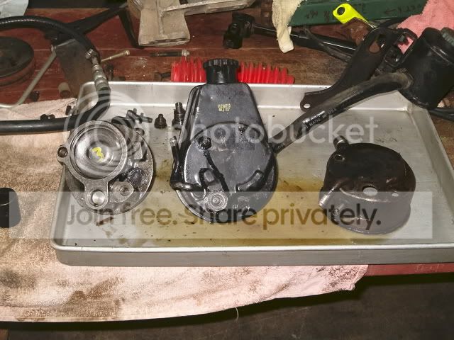

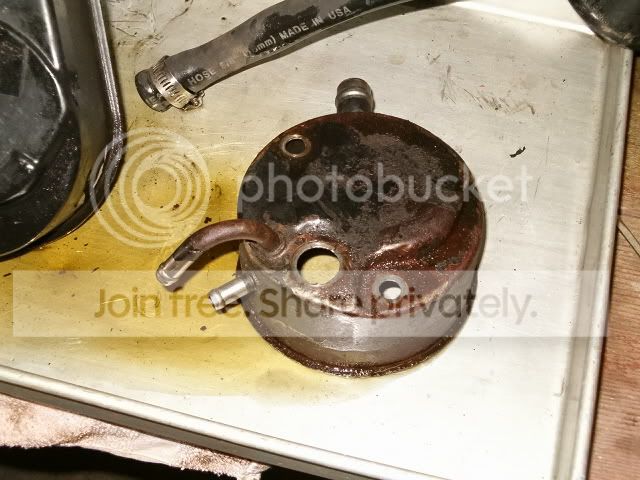

I worked on PS pumps today. When I bought the serp setup, it had a recently rebulit pump with it, so I want to use that pump. I took the pump reservoir (and remote reservoir) from a Diesel setup, and added it to the newer pump.
Dis-assembly of the pumps:

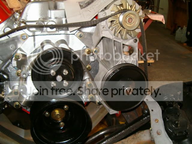

On the engine:

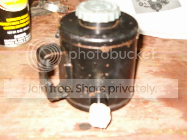

In addition to the remote reservoir, did you get the pump reservoir too?
I was looking at the inner fender panel tonight, and it looks like it should mount OK in front of the hood hinge.
Here is the remote reservoir:
so you plan on installing the remote reservoir, in addition to your stock pump reservoir, the one with the cap on it?
Thanks for the input Fred....a secondary reason for changing pump reservoirs for me was to have the 3 ports on the reservoir for the hydroboost lines.
