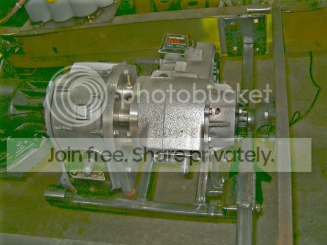

Todays shop progress....alot of trial and error and redesign :doah:
I'm frustrated.:confused:

I will Eric, just have to reposition a couple of the frame plates, of course that meant moving the temporary crossmember I had in there, so I jack up the bottom of the cradle, using plywood/milkcrate/plywood to be able to get the jack high enough, and as I let the jack down a little the milkcrate breaks letting the whole assembly drop down about a foot....Well DIY4X engine mounts are made pretty damn stout, because it was all hanging by those 2 engine mounts....I used 4x6 pieces to jack it up the 2nd time....what a dumba$$ to use that crate anyway, but hey it was the first thing in sight to use, and it was only just a short jack to reposition the temporary crossmember I had on the output yoke.....got away with that one...whew.

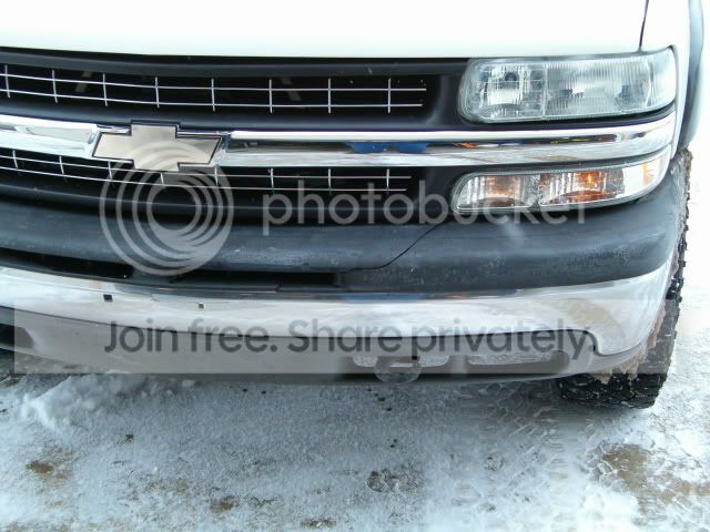

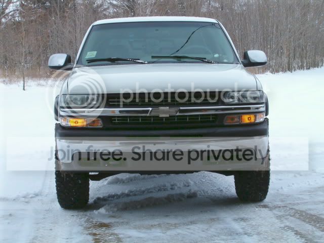

Got the parts to fix my deer hit today, so I worked on getting my truck right again....no more coon shining headlight, and busted out turn signals.
I'll replace this bumper cover at a later date if/when I take the bumper off.

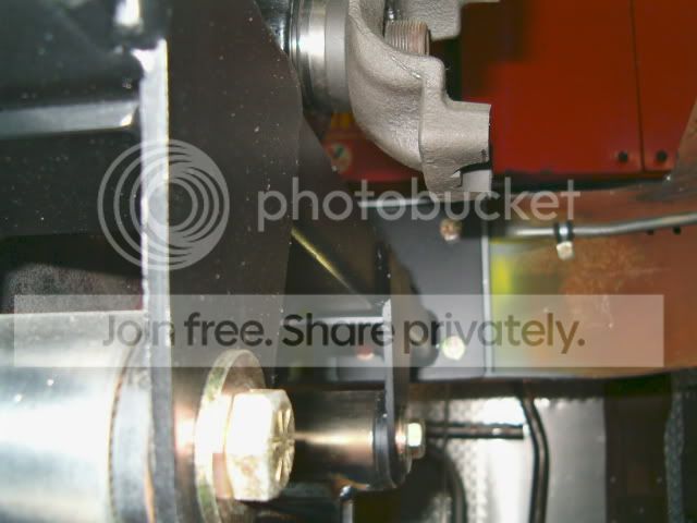

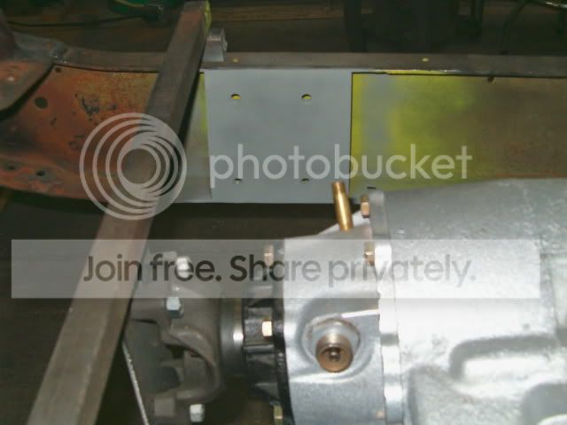

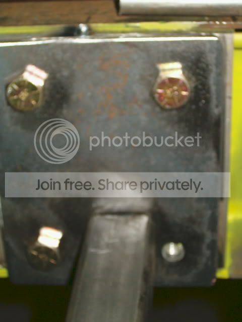

Here is the situation with my mounting plates on the frame, just a miscalculation on location of bolt holes....I'm glad I only have the plates tacked right now to the frame, I can easily move them back enough to use that partially blocked lower bolt hole....

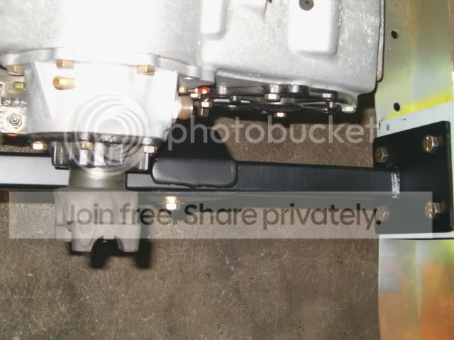

Here is the rear crossmember support to the cradle in its location:

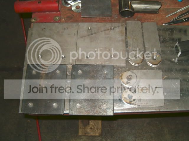

I got these made up today too for the front mounting links to the frame/cradle
dig the slots.........

I got the frame plates for the rear crossmember relocated, welded in, and ready for the crossmember

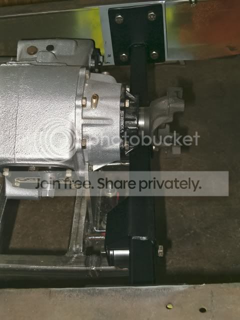

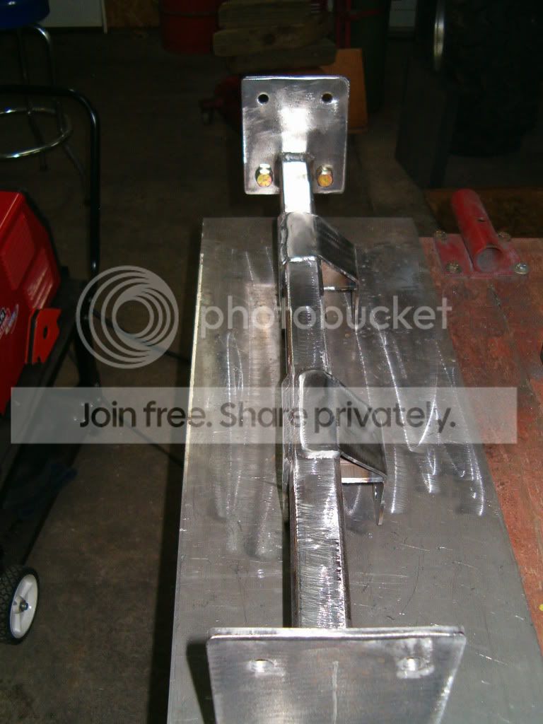

Then I bolted the crossmember plates to the frame plates, and tacked the crossmember to them. I then took everything out for bench welding and cleanup and paint. This shows how the bolts will clear the crossmember now.
Not to shabby for a newb...

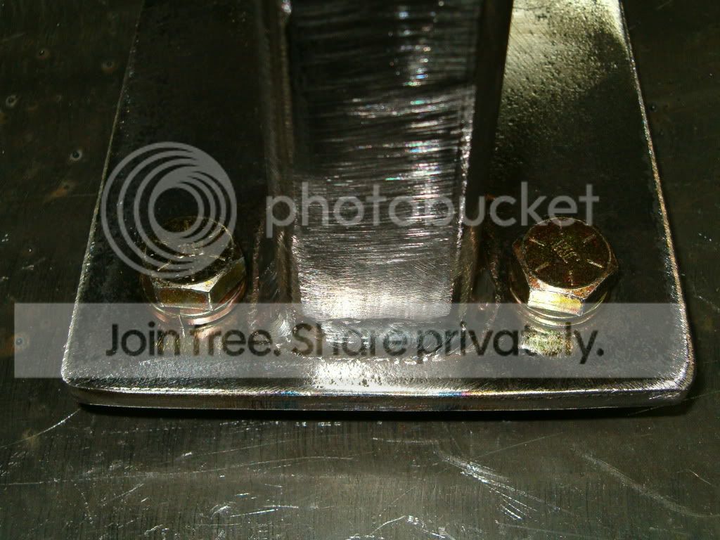

Installed, I really like how this is turning out:
I should have about 1/2" of room between the ubolt nuts on the yoke and the crossmember:

I made my holes by scibing them out 1" from each corner on the crossmember plate, then I tacked the crossmember plate and the frame plate together, then drilled the holes for each pair on a drill press, to keep them perfectly aligned. That part worked out well.
The problem came from having tacked the frame plates to the frame in a position that caused the crossmember to be too close to one of the bolt holes on each side.
That made me have to move my temporary crossmember (and the subsequent testing of the DIY4X engine mounts) to a different location to allow better placement of the permanent frame plates. As the pics above show, it all worked out well, but it was just another one of those "take a step backwards" moments that I find all to often.:D
