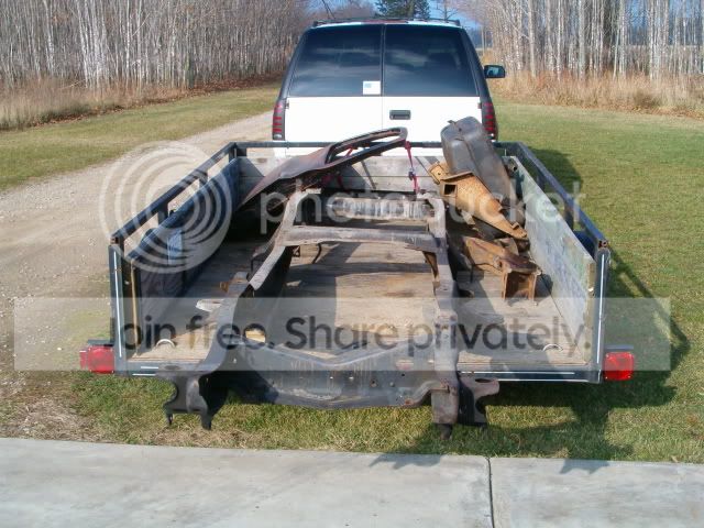

I got to unload the trailer of all the crap that was inside the Blazer, and now put it back inside, so I can use the trailer to haul the frame to the strippers. Double the work, no result.....:rolleyes:

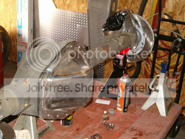

Disc caliper mounting brackets, 3/8 rear cover, shackle flip brackets with shackles. The shock mounting kit, and the frame boxing kit are coming soon.

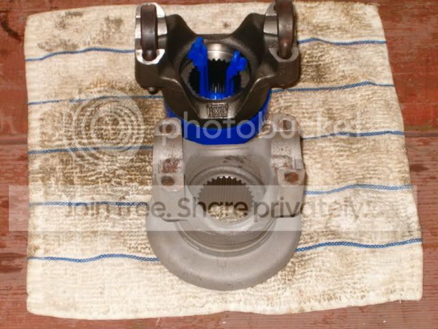

I got a 1410 U bolt yoke from Jesse @ H.A.D. and some axle seals, front pinion seal, pinion shim kit, crush sleeve, new yoke nut, and a Pinion pilot bearing (GM calls this a straddle bearing).
So off to the strippers the frame, gas tank, tank straps, an extra door (spotted with rust inside and out, otherwise new) a reciever hitch, assorted frame brackets, and hardware.
The 1410 U bolt yoke compared to the stock 1350.

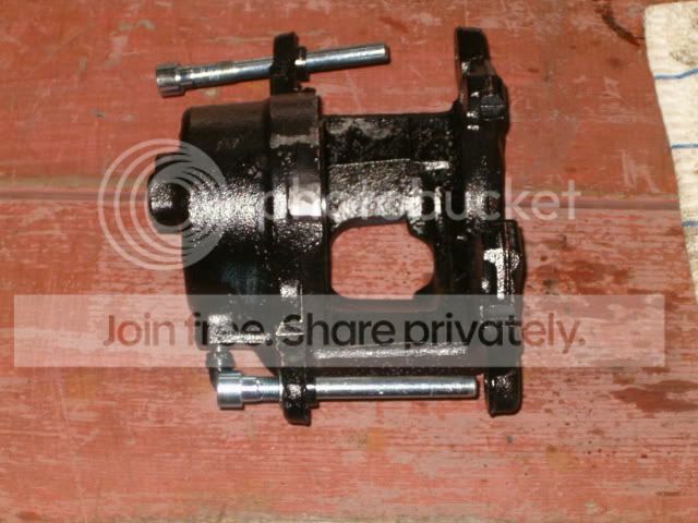

The calipers needed to have a 3/8" tab removed from them to clear the mounting brackets: The ground off area is on the inboard pad mounting area of the casting.
Some of Kerts craftsmanship:

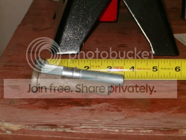

And some new wheel studs. These are Dorman # 610-194 and measure 1/2 longer than the SRW studs. They are applicable to a duallie. I need the longer ones because of the thick flange on my aluminum rims. These were only 1.99 each at Autozone.
