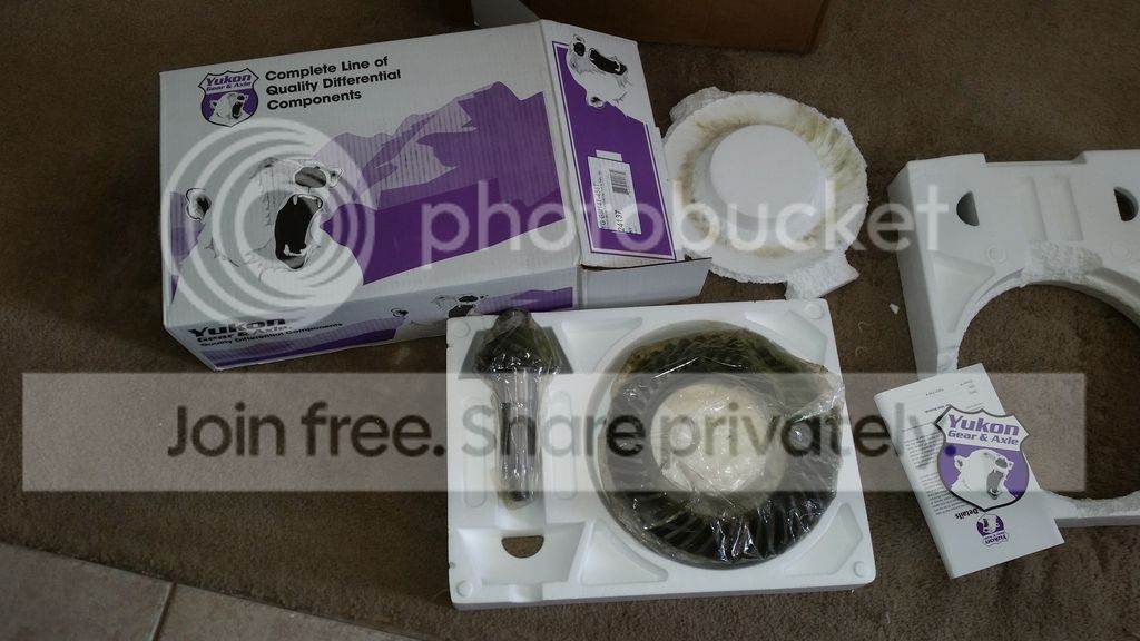

Hopefully going from 4.11 => 4.56 will help a little in the acceleration dept. But at least I won't be a 2wd poser anylonger. Gotta gather a few more parts and do some reading. Was thinking about attempting this myself - as my first rear regear. 14b and Ford 9" are supposedly the easiest ones to setup, so MAW.
FedEx left something.
You put these in yet?
In a word... No. Ordered some install parts for it from amazon, they sent me the wrong part 2xs. Looks like they were mislabeled from the factory. Need to order from summit this time.

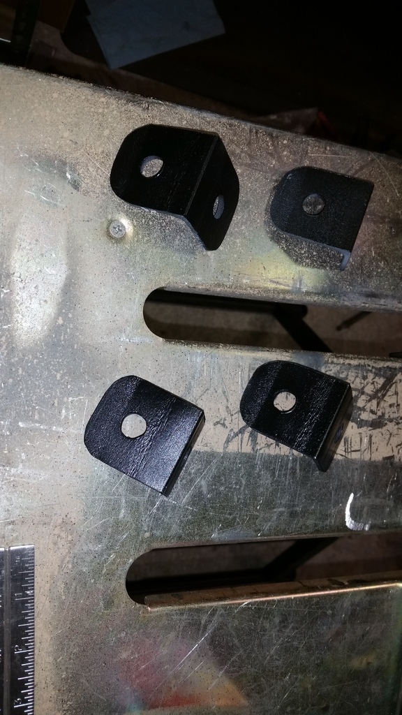

Built some brackets
For the new seatbelts
