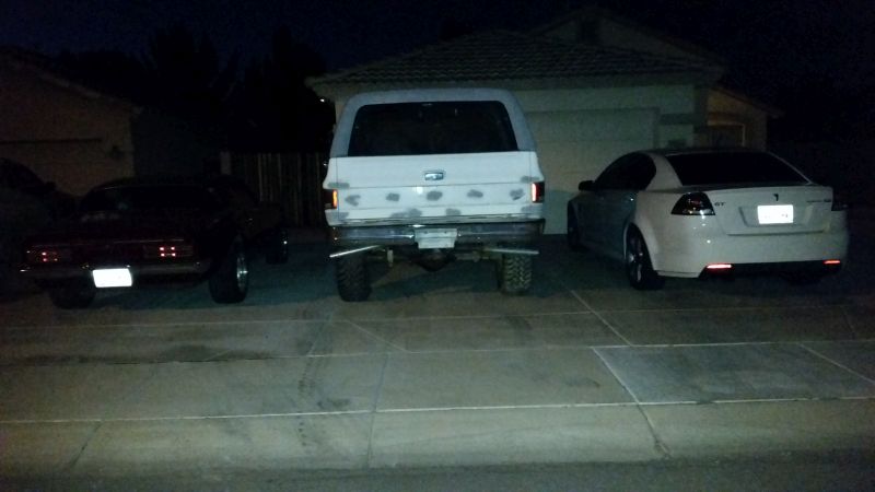

This is probably the latest picture as how it sits now. And yes it has leaks... I know you're kinda obsessive about them... lol

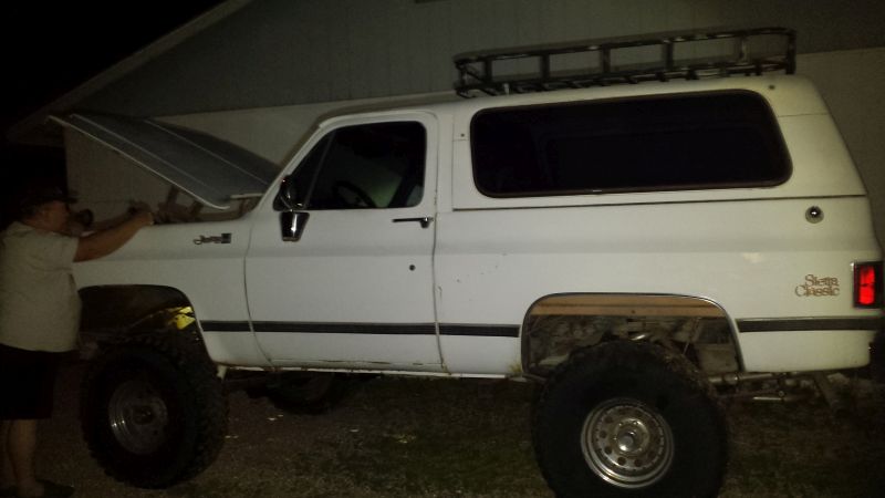

Ok, I thought it was about time to start a build thread. So, here it goes.

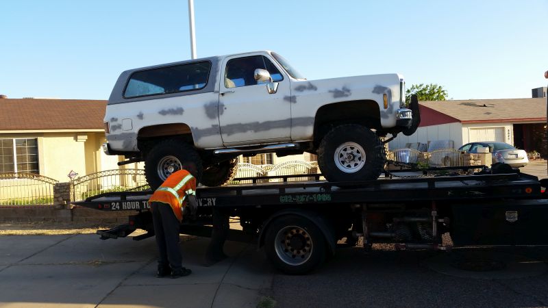

One day my Wife's uncle came over and handed me the title to the truck. Said he needed to get rid of it, couldn't work on it, couldn't climb into it anylonger. He knew I missed my 77 so he thought I'd have fun w/ this.
This is where it was when I got ahold of it.
He'd put some work into it but it sat for about 2 years getting garage rot so it wasn't running the best, even though it had basically a new goodwrench crate motor in it. Didn't like to start.
So, I started w/ the basics, tune up, carb adjustment, timing. Found the timing was waaay off. was like 12deg AFTER tdc. Found out there were 2 timing sets for sbc's and he'd mixed them up..
So I ordered a new balancer and timing tab matched to each other. Still had to crank a bit to fill up the carb but once running seemed ok more or less.

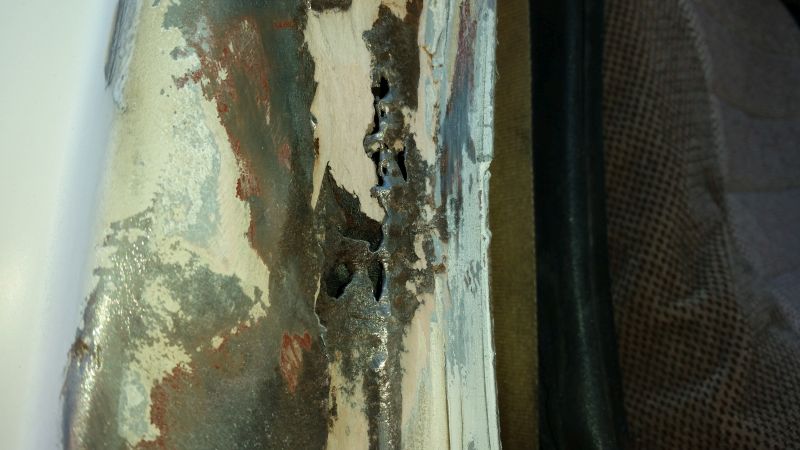

Then started looking at the body, wasn't a fan of the plastic strip running down the side and some suspicious spots on it got me wondering. And found some rust holes that someone had just bondo'd in.... oof..
It was about that time that due to circumstances I had to bring the truck home to work on.

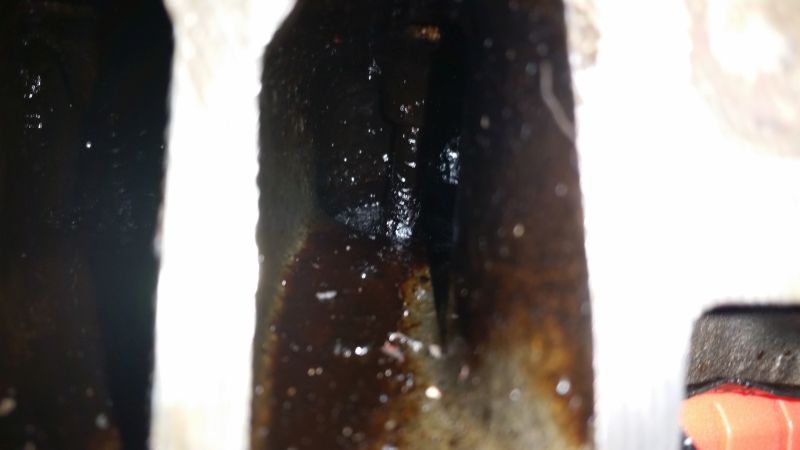

Then I found that #8I was doing the same thing. Pulled the heads off and found the back of the intake valves were heavily fouled. Never seen anything like that. Still not sure how it happened, but may have been an intake leak into the valley…? Those heads were crap smogger heads and by the time I got them rebuilt w/ screw in studs wasn’t worth the money.

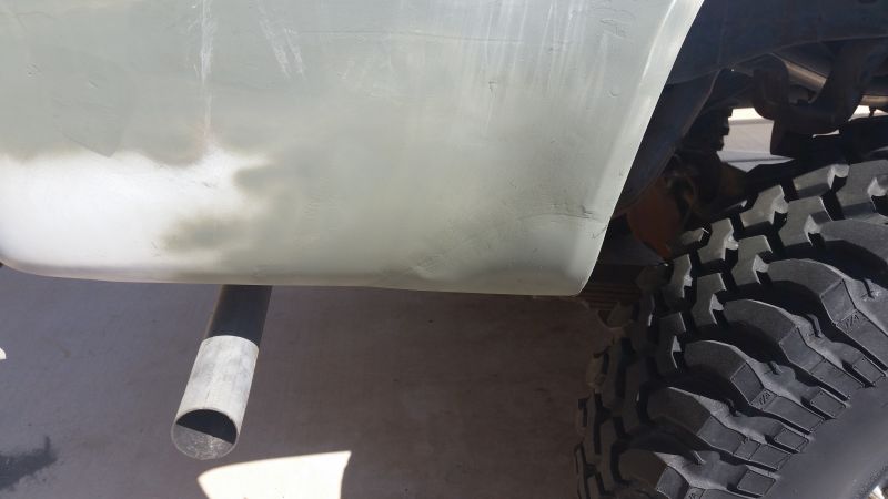

Then I started looking into the body. Uncle was not a fan of the ‘truggy’ thing where you couldn’t recognize the truck, so I told him I’d give it a shot. And decided to replace the bottom of that quarter panel. Not much welding experience and body work. If it came out looking like poo then I’d just cut it off.. He was ok w/ that.
This was before any filler... don't seem to have one afterwards...
Came out looking ok I suppose. If you know where to look you can see it, but for a first shot, it’s acceptable. Esp for something that may get dented up at some point.

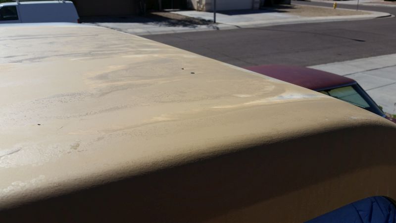

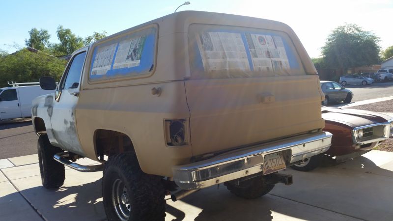

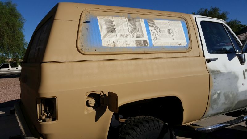

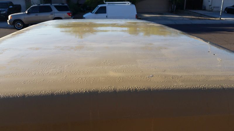

Had read about some of the military guys using Behr house paint on their big trucks (2.5 and 5ton) And that it held up pretty well. So for about 75$ in supplies I decided to give it a shot. Cheap, and easy to repair if it got to torn up.
First attempt didn’t go well. Was too cold and moist out. Morning dew got me and much of the paint ran off the truck into the driveway… DOH!
So, second attempt I bought a cheap Horrible Freight hvlp sprayer and gave it a shot. Came out pretty decent. Has a bit of a texture to it. Not as much as bedliner but it’s not completely flat. Latex sprayed out kinda rough even after thinning it significantly. But I like it. Had a few people say they liked it.
