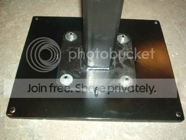

one of the best things I did when I put my anchors in the middle of the floor was to make a larger than the bottom fishplate that the bender bolts to.... I ran 8 studs in it, so you could clock the bender in 1/8 increments if needed as opposed to 90 degree.. when not bending, I just unbolt the whole thing and store it... just leave the 4 anchor holes in the floor...
