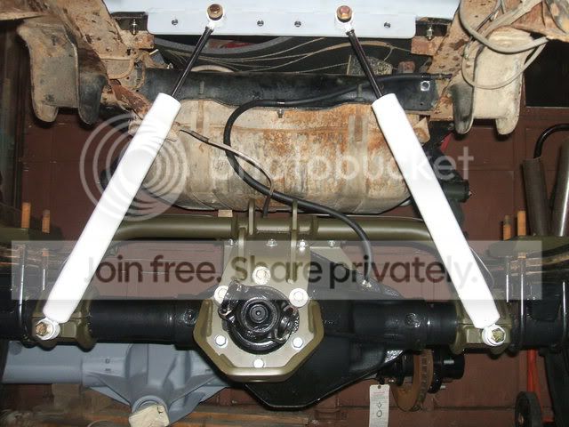

I don't have any pics yet since it's not finished but here are some from another CK5 build. My plan is to run the Wraptor anti-wap backbone from DIY4x with the lower shock mounts integrated on the backbone.

Are their any advantages in running the shocks like this compared to the stock setup? why did you go this way? Because of the bazer fuel tank?
I am very interested in your build of this truck as I am going to be using mine in the same fashion as you.
Edit: I see your going to run them on the wraptor. So then I ask whats the reason for that?

The shocks hang down to low on the axle and the way they mount to the frame, it tends to crack. In fact my frame has already cracked and been repaired once. Also by inboarding you increase wheel travel.
I'll be running the wraptor setup to increase strength and I need a anti wrap setup with the longer soft 57's I'm running.
I got the shock mounting idea from muddermilitia's build http://coloradok5.com/forums/showthread.php?t=314071
