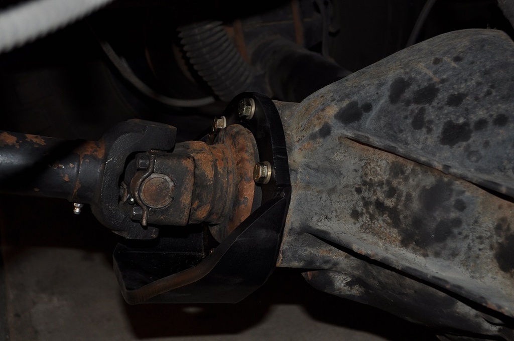

Ordered a Guardsman Pinion Guard from DIY4x. Came today but haven't opened it up yet. It weighs 10 lbs.

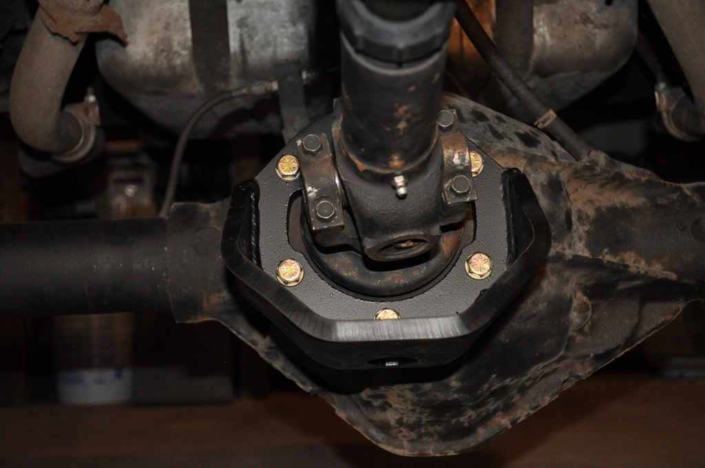

Finally got the Guardsman pinion guard installed. Just remove the u-joint straps, if that's what you have, and move the driveshaft out of the way. Remove the 6 bolts holding the pinion assembly on. The guardsman fits right over the pinion assembly. Use the new bolts, which are longer, and tighten to 65 foot lbs. Easy peasy.

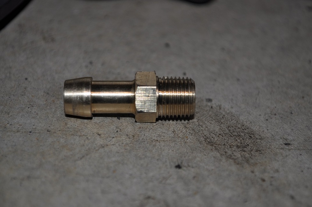

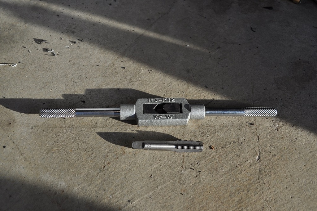

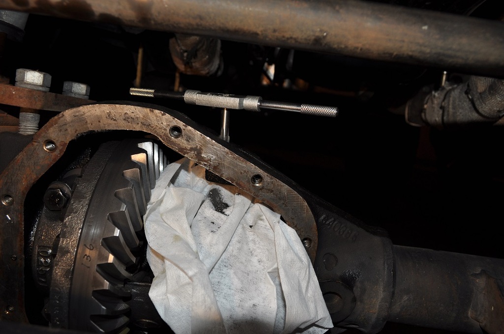

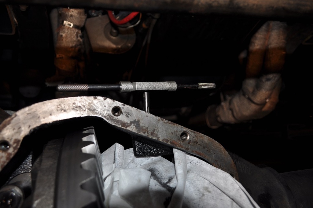

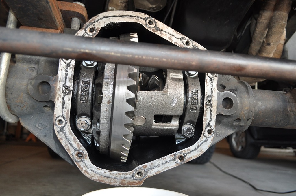

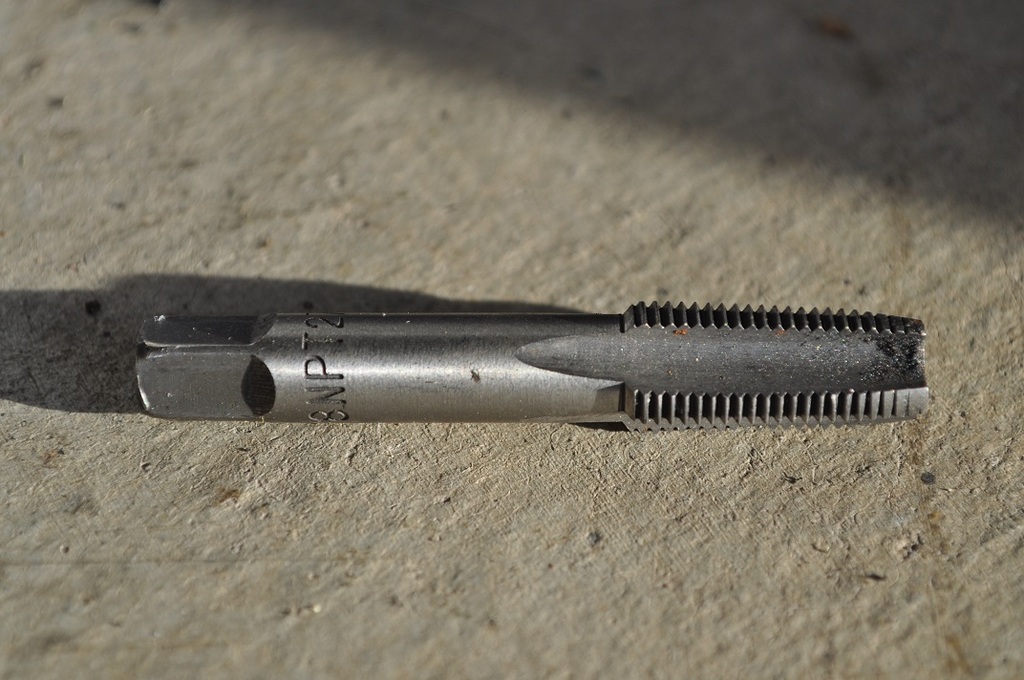

Now, another small project. The dana 60 is missing the vent tube and hose. And my fear is that there was water inside. Yep, there was. So I tapped the hole with a 1/8 NPT tap and used a pipe to hose adapter.

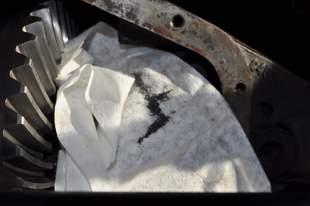

I placed a paper towel under the vent opening and made sure it covered a wide area to keep the metal shavings out of the differential and gears.

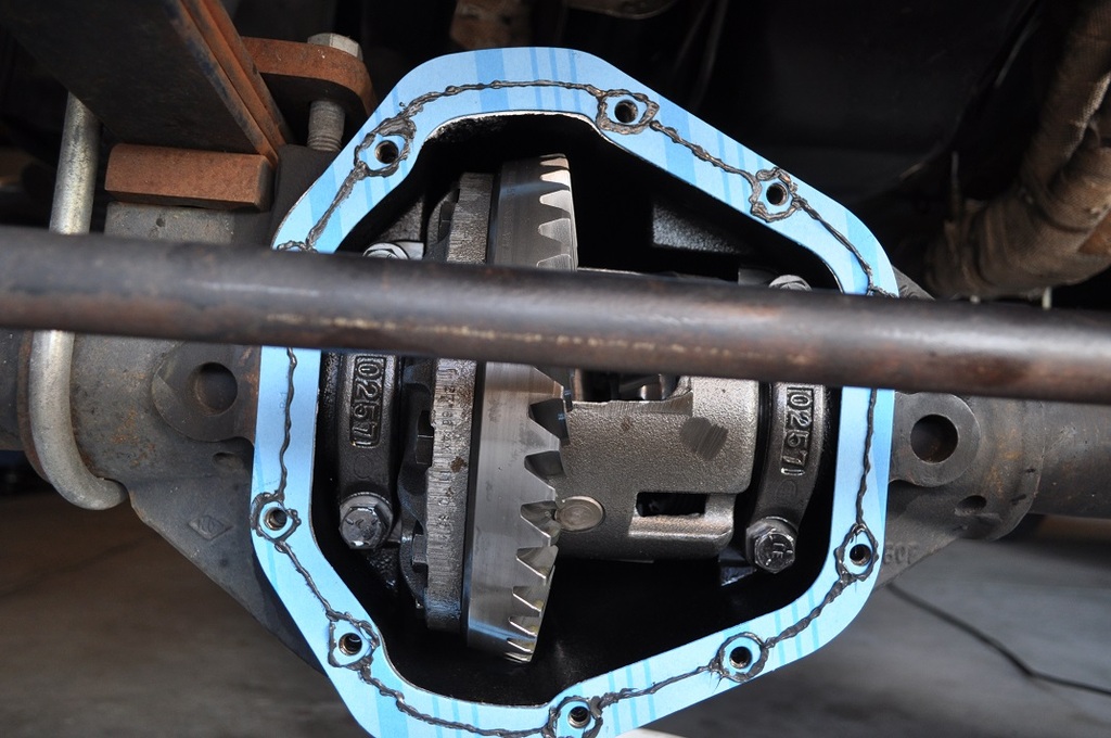

I have had good luck with the Felpro gaskets. I put a very small bead of silicone on the case which holds the gasket in place and then another small bead on the gasket. You really don't need a whole lot of silicone.

Replace the cover and done. I installed the new adapter but I need to get a hose long enough to make sure it won't be under water.

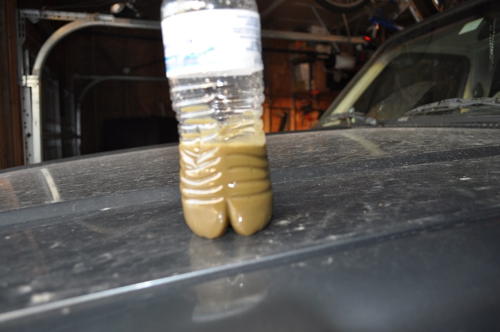

Here's what gear oil looks like when mixed with water.

I like to install the paper gasket without silicone. They can generally be reused multiple times than.\
Martin
I agree with you, Martin. But there were times I used a good gasket and it ended up leaking. So I started using a very small amount and it makes clean up easier and never had a leak since. Especially on a wide flat surface like the dana 60. When I removed the cover this time it came off very easy and clean up was also easy.
I ordered the Lube Locker gasket for the dana 60 so in the future I won't be using any more silicone.
i redid a 60 cover here a few months ago and used a o.e.m spicer gasket . . . . . . its leaking a puddle under it on the shop floor on the project truck :angry1: . . . . . that's alright has to come apart again to swap out open diff for a eaton e-locker unit .
anymore I just use right stuff form a gasket . yes its $$$ but the stuff just works.

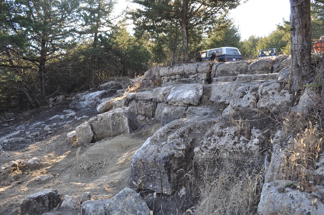

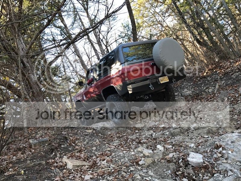

After the first trail run and meet we went to a place called Twin Ledges. There were two different places you could go up so we tried the one that 78SWB went up. But no dice. I couldn't get the grip needed so we headed over to the second ledge. They could really be called Boulder Stairs because that's what it looked like. Giant shelf of noting but huge rock with ruts. I finally made it up that ledge. Video below.

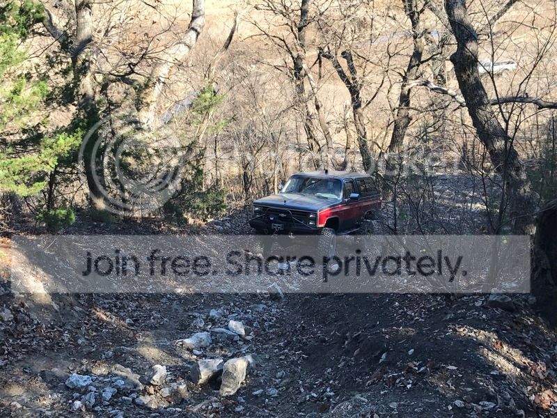

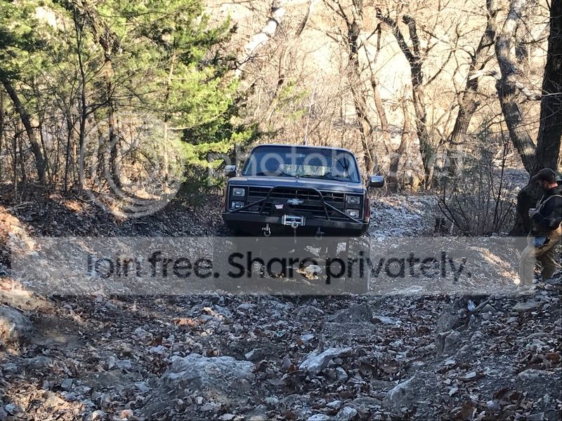

Now.......The third trail we took to the finish was what I would call "No way you're going up that!!!". With a little help at the end from 78SWB, we made it. Only got a little bit of carnage on the passenger side of the rear bumper.

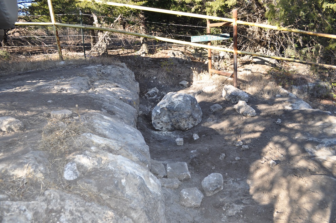

78SWB went first and after watching him for a few minutes I figured we were TOAST. He made it up then GWeakland620, aka Greg, went and after a few minutes he made it. So it looked promising. But. We hadn't even seen what they were actually climbing and why it took a few minutes to get up until.......I walked up the trail and seen this......Cliff? This is the side the truggies went up.
full
This was the side we attempted.

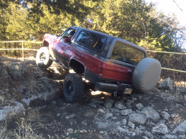

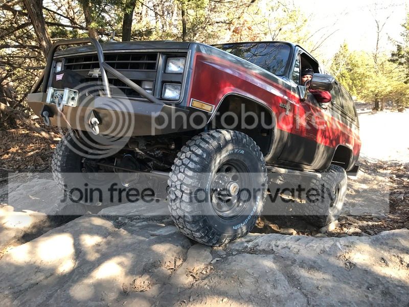

So we went for it. No chickening out now. I built this K5 to try and go anywhere and this qualified as one of those anywhere places.
full
Got the driver side front tire a little bit off the ground.
full

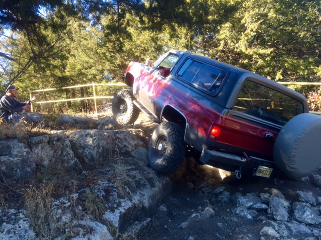

This is making it to the top with the help of 78SWB. I busted off a section of the shelf and this small boulder kept me from going up on my own. And I almost became good friends with that fence on the right.
