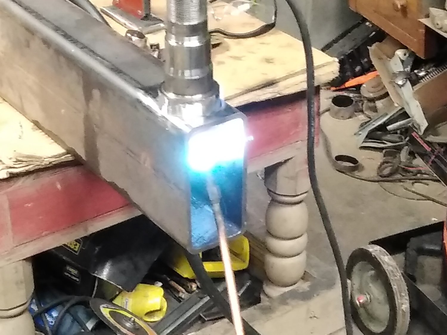

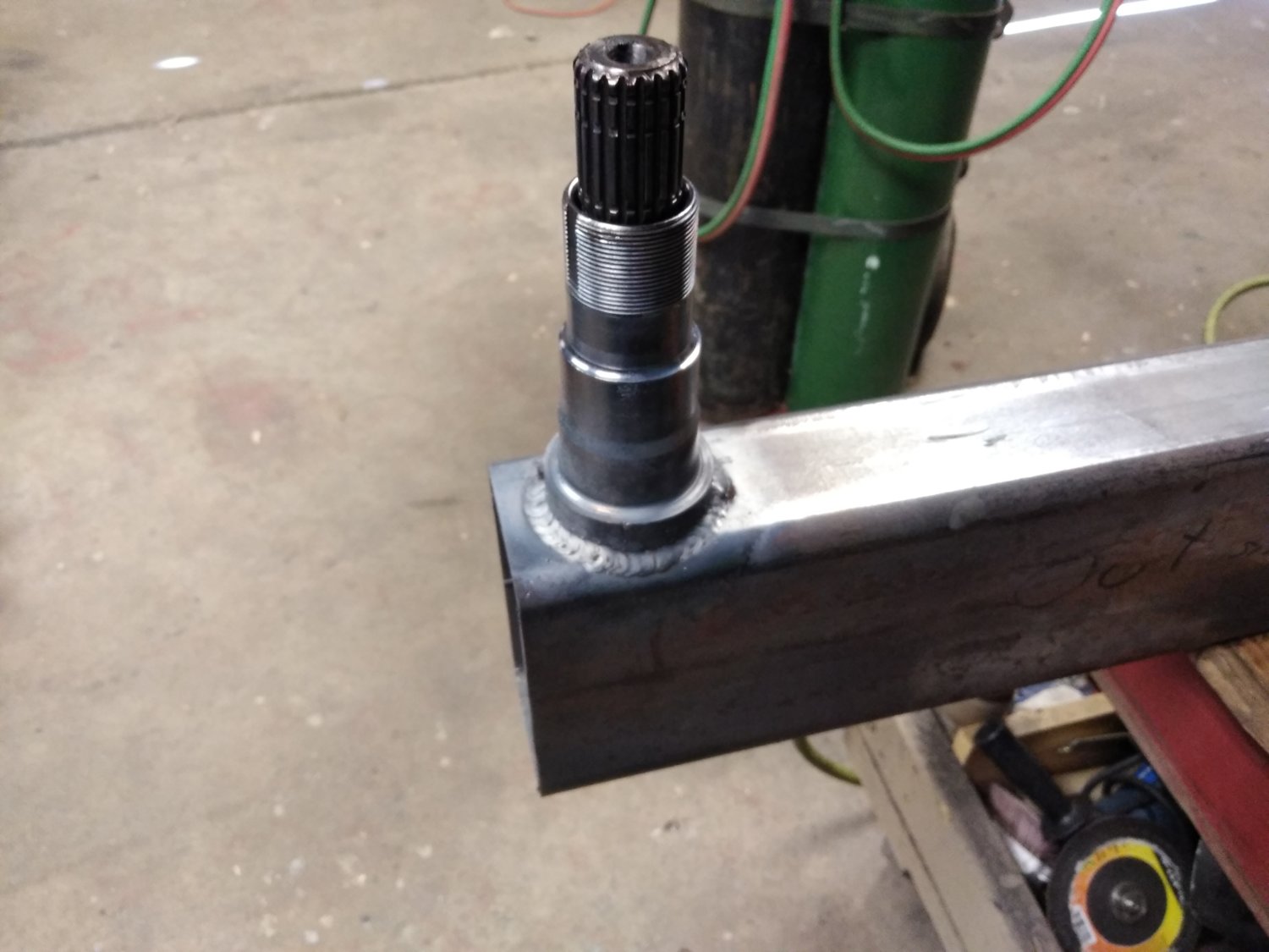

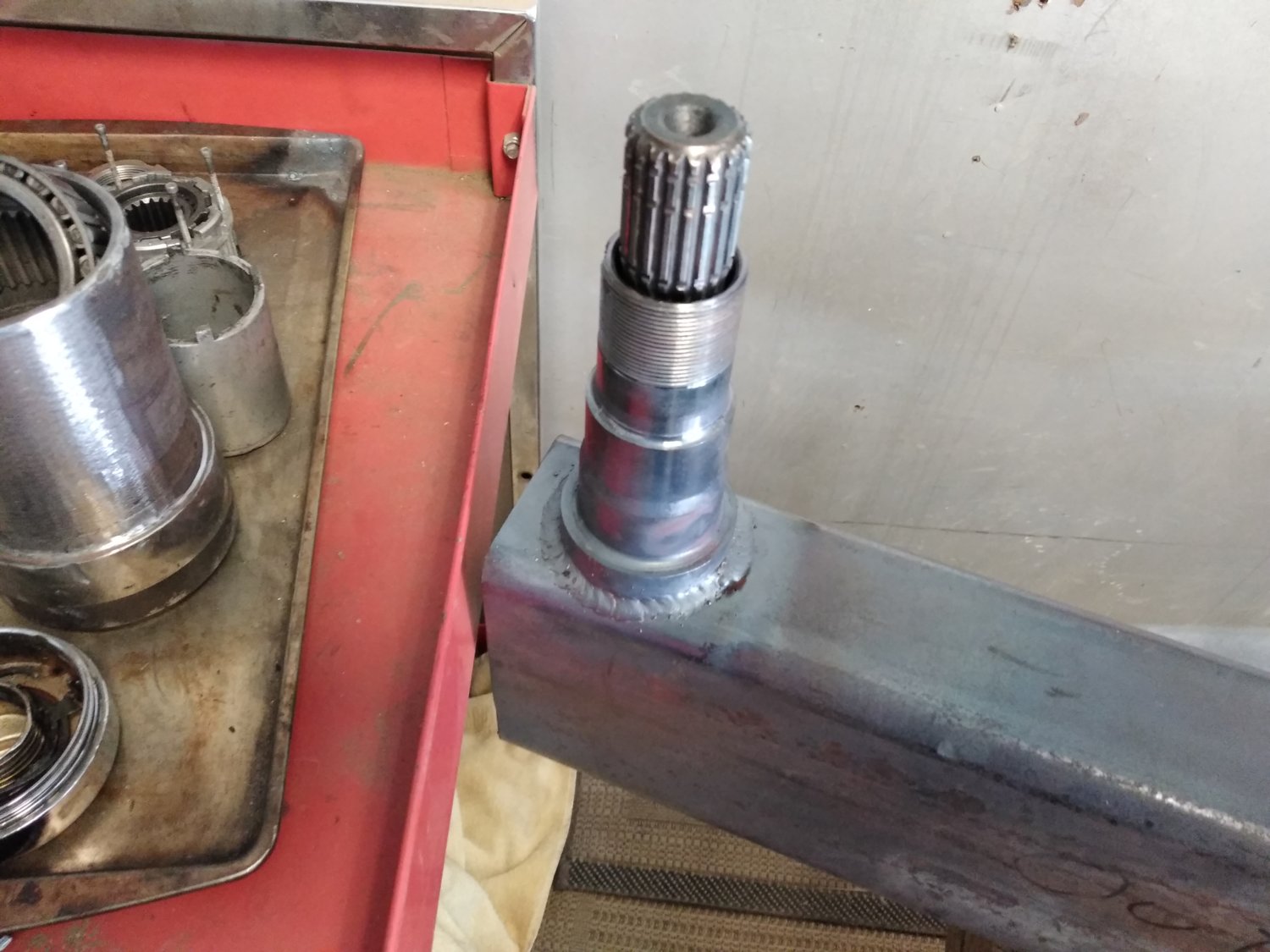

Getting back into doing something. Went over to Bill's place to get some stuff done on the bumper project. He wanted to weld the spindle today.
So since we had a fairly heavy chunk to weld to the box we cheated a little and broke out the torch to get things up to temp.
He added another section of 1/4" plate to weld to the bottom of the spindle inside the tube and to the tube itself. We think the welds came out pretty good with the added heat.
We let the whole thing cool naturally. I think it came out pretty good. It should be nice and strong.
