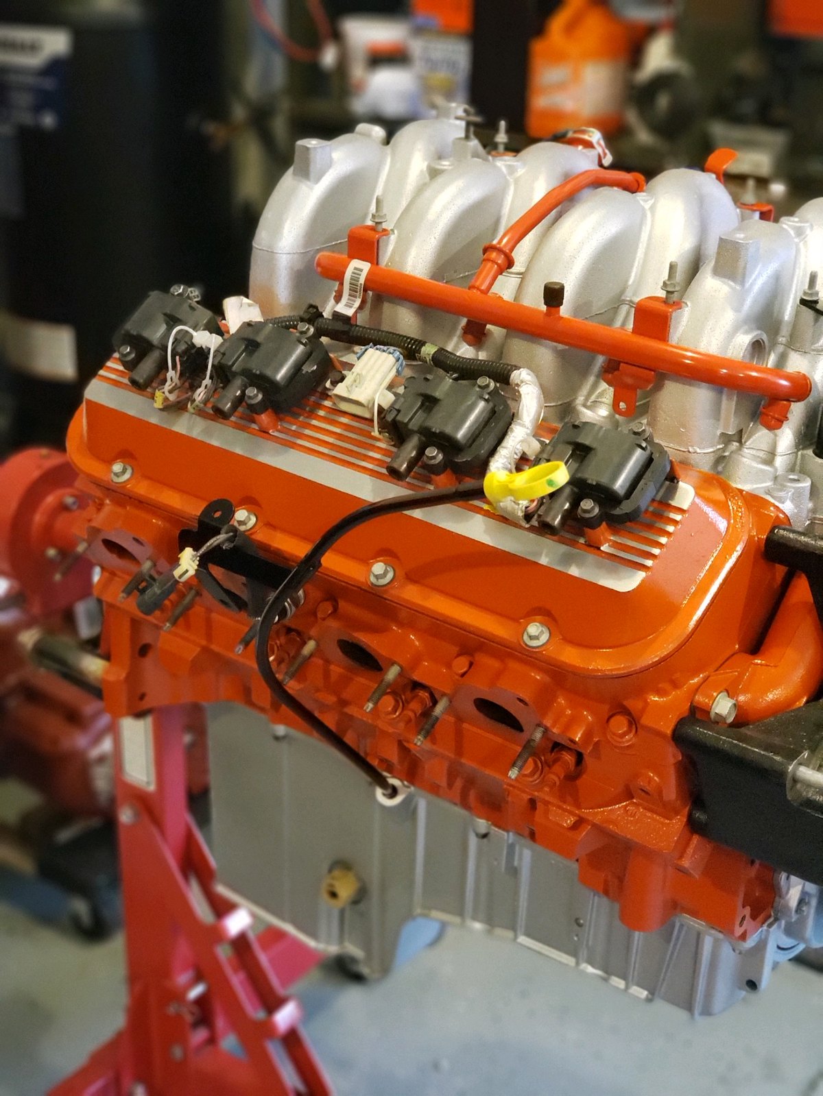

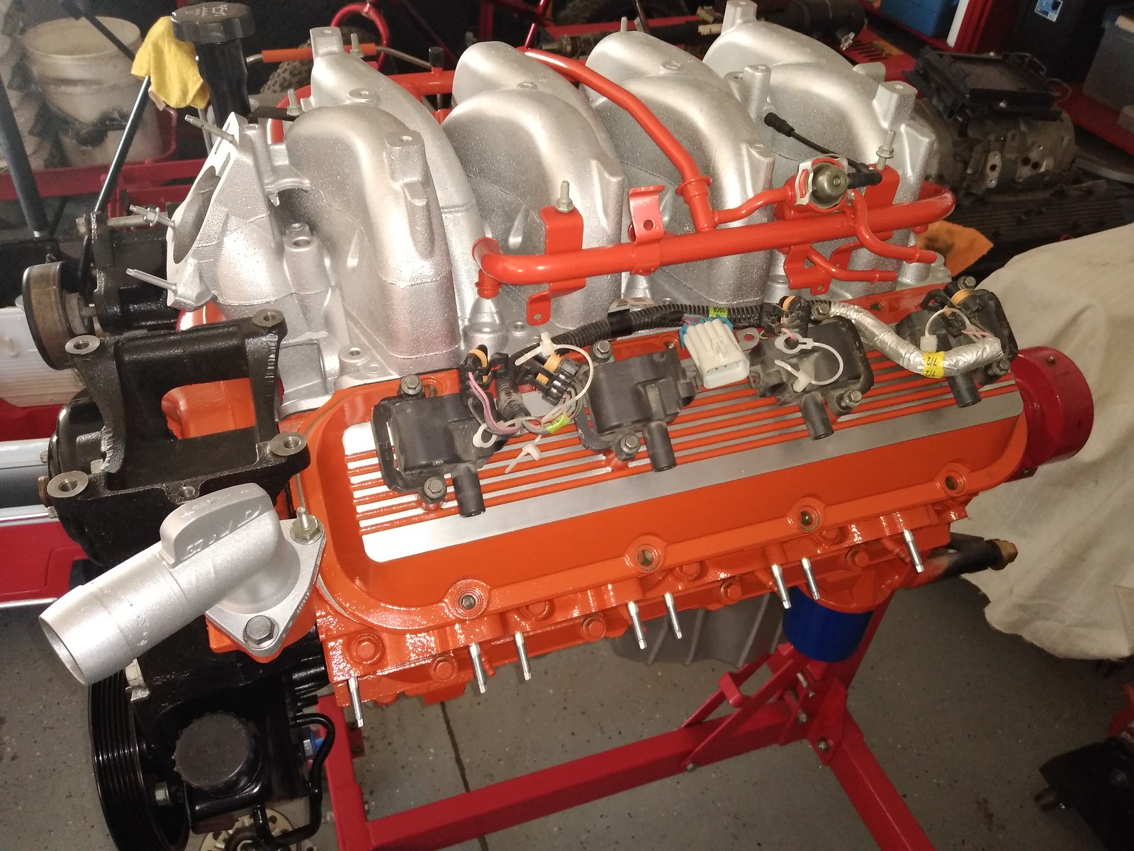

I finished up the valve covers yesterday. Just before laying down the clear I took more 220 grit and hand sanded all the bare sections to take out the swirly marks from the palm sander. Plus I noticed the raw aluminum soaked up any of the oils on my skin and left a dark spot when I touched it. The hand sanding took all of the marks out and I cleaned it up quick and shot the clear on it.
The baked in the front seat of my truck all day before I stopped by Larry's house on the way home tonight. He mocked up the coils really quick with a harness and it gives one an idea of how much of the work I did will be visible when assembled.
It still shows quite well and the little bits I couldn't get into the corners of are hidden by the coils and the harness.
I love how it looks. It reminded both of us of some of the GM performance crate engines.
That looks awesome
That looks awesome
Thanks! There are a few little flaws, but most are hidden by the coils for sure. I know this if I was to do another set I'd do it differently. Since the paint was in decent shape on the covers, Larry shot the orange over it. So when I come in with the sander to expose the aluminum I went through two distinct layers, the orange, and the black. So if you get really close in on the fins, you'll see a hint of black on the edge. It's almost impossible to see from the distance you would be viewing it from the side of the fender, but there really isn't much I could have done about it but start over. So I shot it with clear and called it a night.
IF I did another set, I would have blasted all the original paint off first in Larry's sandblast booth. Then paint and resand the ribs again.
Agreed, I blasted both sets BBC covers I’ve refinished. Without the coil mounts on the M/T and L29 covers it’s easy to sand the fins with a belt sander as well.
looks good.

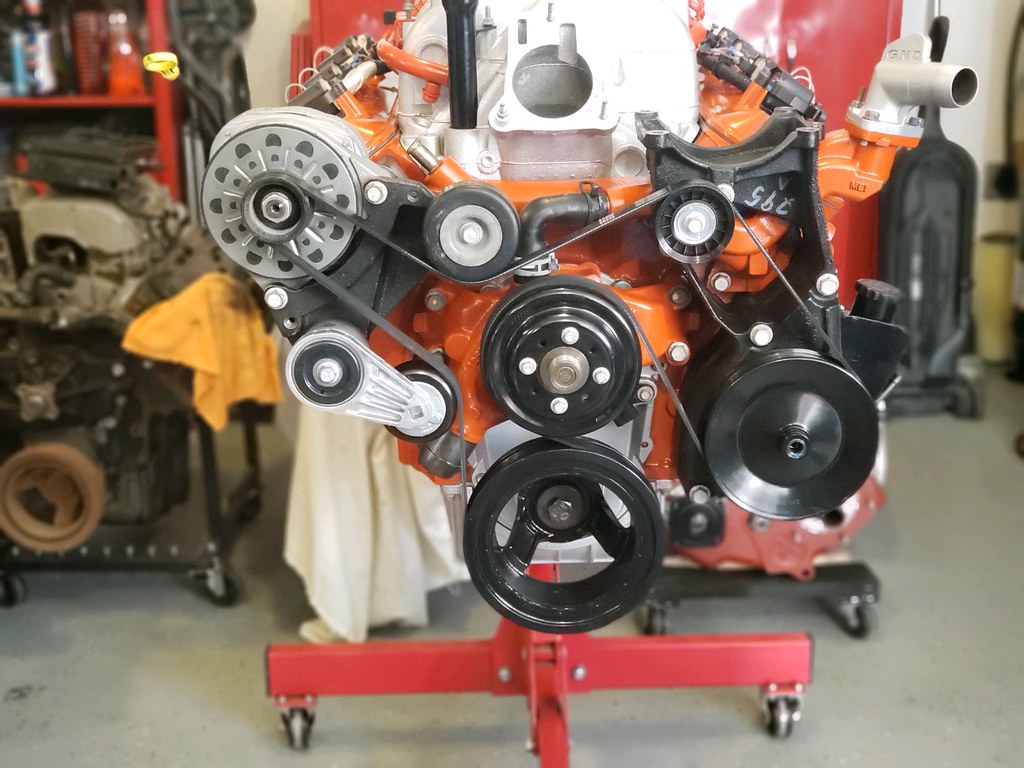

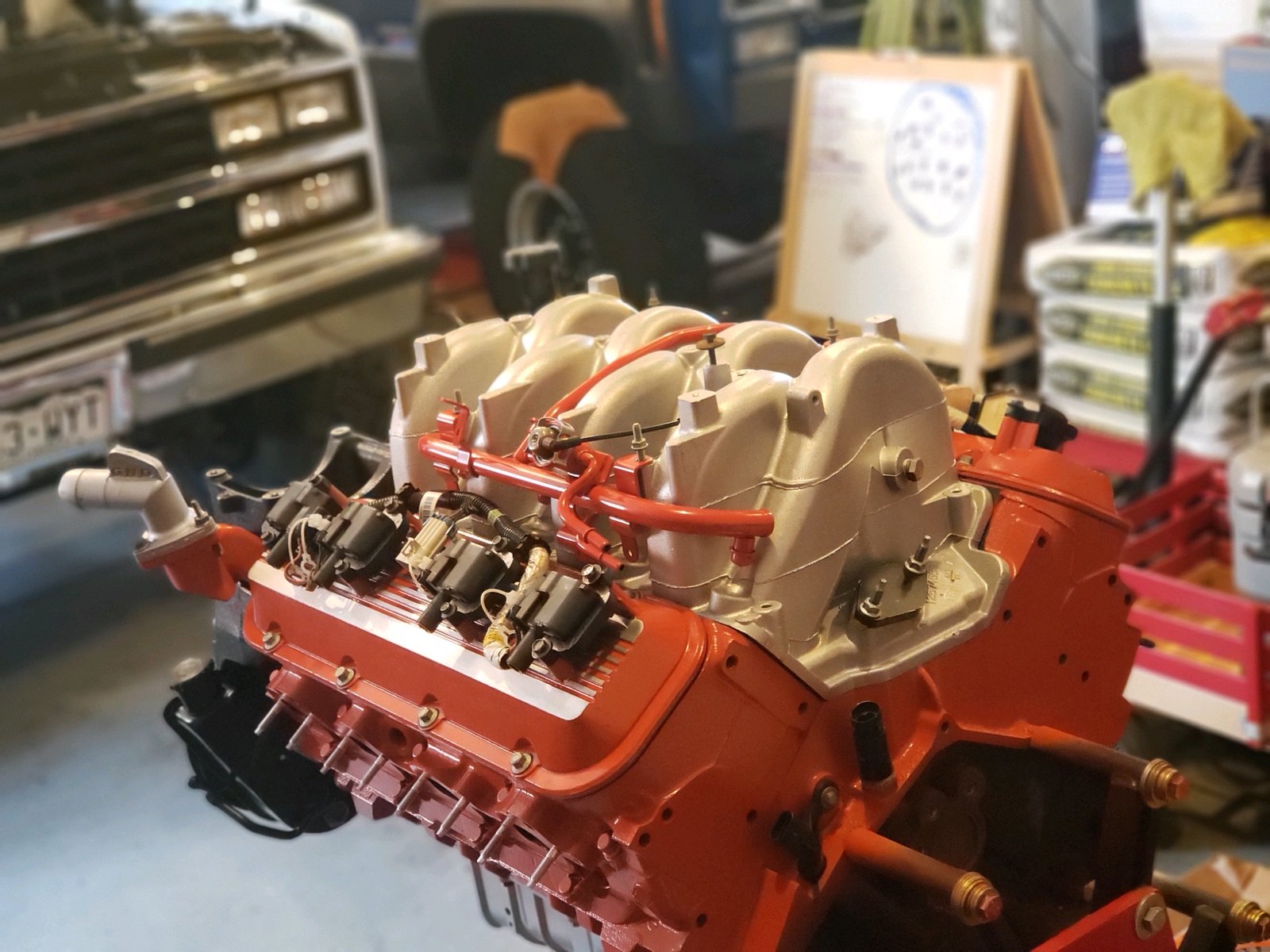

Larry got some small details done buttoning up the engine. The serpentine drive is complete. Since A/C isn't in the plans currently, we went with an idler pulley and shorter belt.
The dipstick tube was crusty so it got cleaned up and painted.
Fresh crank sensor installed now because once the engine is in it won't be as easy to change.

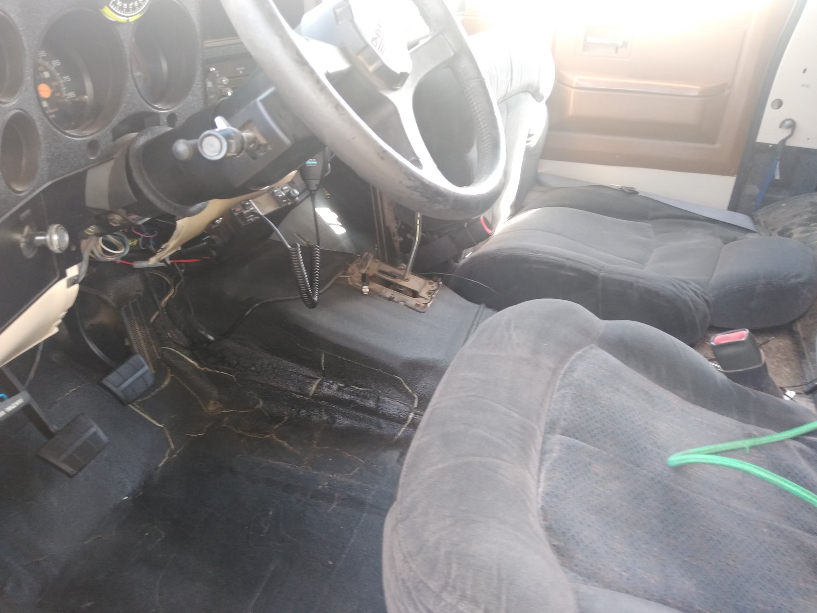

I spent the day pulling apart the interior. Seats came out along with the console. I used the shop vac to clean up and then wiped down the rubber floor. With everything out of the way, I labeled all the wires going to the console so I can remember where they went when I reassemble. I pulled the rubber floor and jute backing and sucked out the rest of the dirt that was under it. I put the driver seat back in with a couple of bolts so we can move it without having to sit on a bucket. The seat covers are in the washing machine for a much-needed cleaning.
I need to still bleed the brakes since I installed the master cylinder, but other than that its ready for a ride on the trailer to the Bigassgas garage.
Do you have future plans to add AC?
Martin
Oh hell yeah I do. But the budget is all going into the drivetrain swap currently. I've got an add on aftermarket A/C unit that Larry pulled out of a '91 parts Blazer last year. It is pretty unique that it does not replace the existing heater box. It installs above the box behind the dash and hooks up to the stock a/c vents in the dash and has its own blower motor. The problem is the system isn't complete. All we were able to salvage is the parts within the interior and didn't get all the parts under the hood. So I'd have to source the condenser, have lines made, and adapt to the 8.1 compressor. Checking prices, it could run pretty close to a Vintage Air system. I'll be doing further research but I may end up going with a complete system for the modern electronics and availability of replacement parts.
