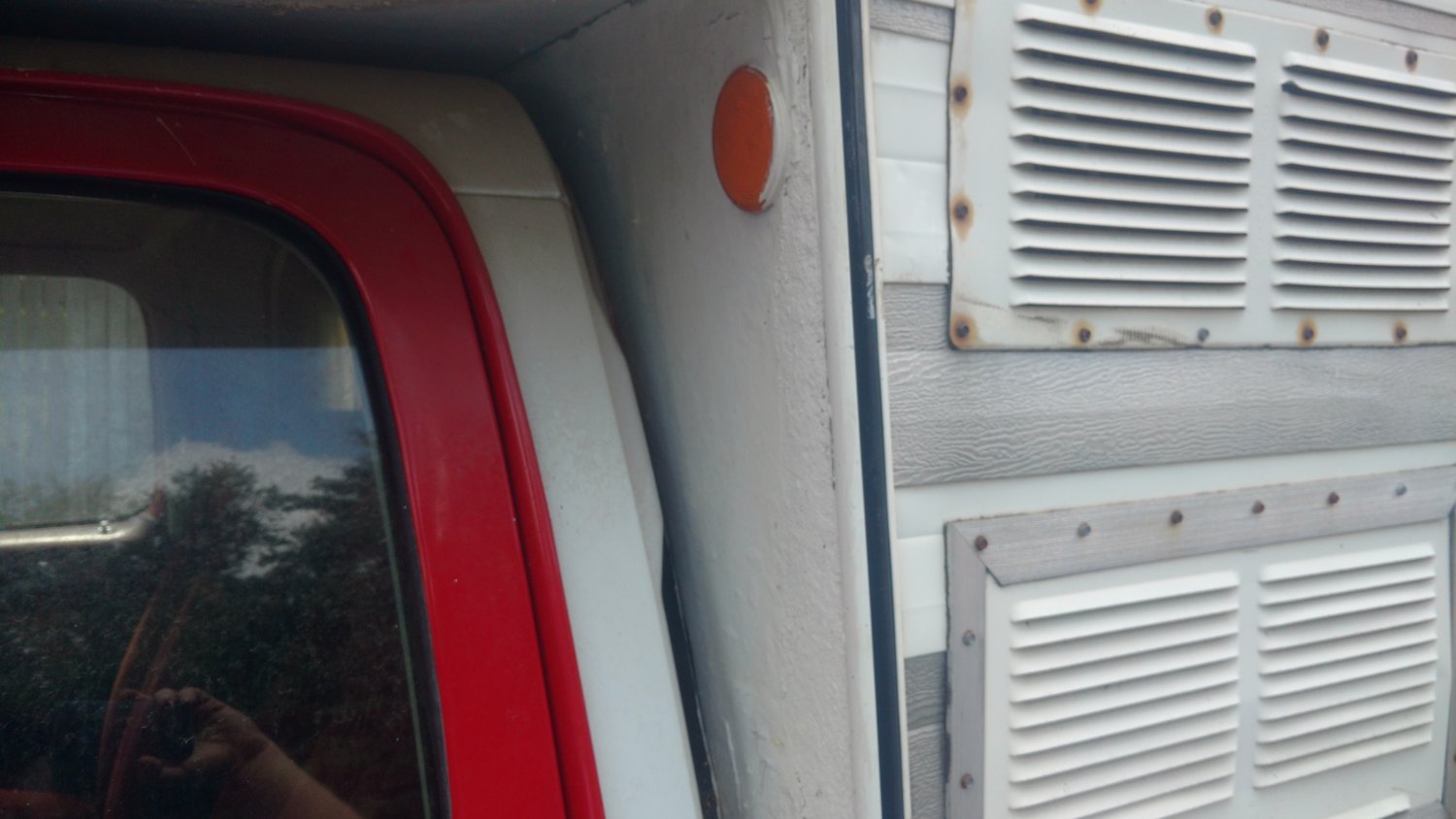

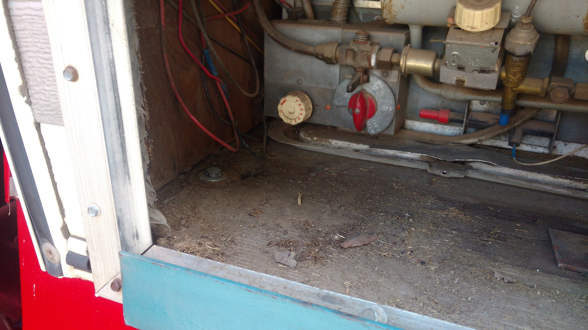

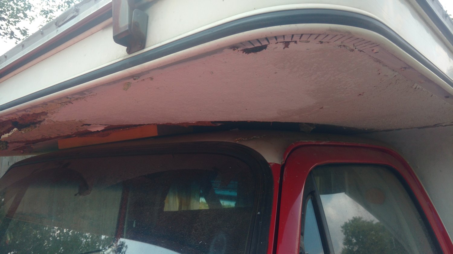

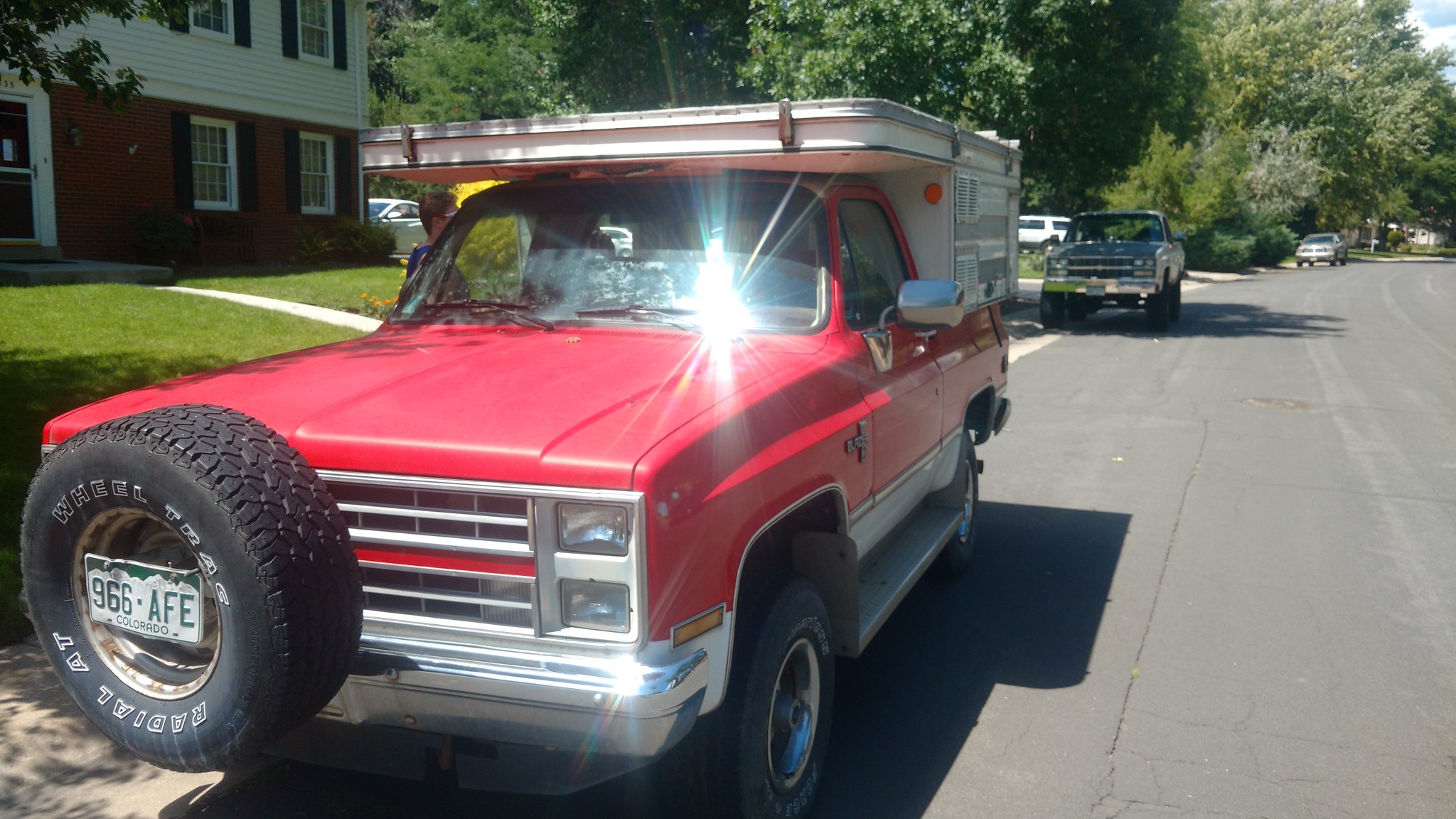

So the good side of the camper was the price. $300. But for the price one should expect a problem or two. This one has it. There is a limted amount of wood used in these units, but what wood is in this one is rotten. Mainly the front wall to the cab of the truck and the bottom of the cabover section. Why they used particle board in these areas is beyond me. Guy selling it said the damage was recent, but the cab wall section has been painted over. Thankfully the vinyl skirt between the top and the base is in decent shape with no mold or tears. It is the insulated skirt too.
Sharp eyes will spot the main problem here.
Close up
Stuff is swelled like mad.
Cab wall.

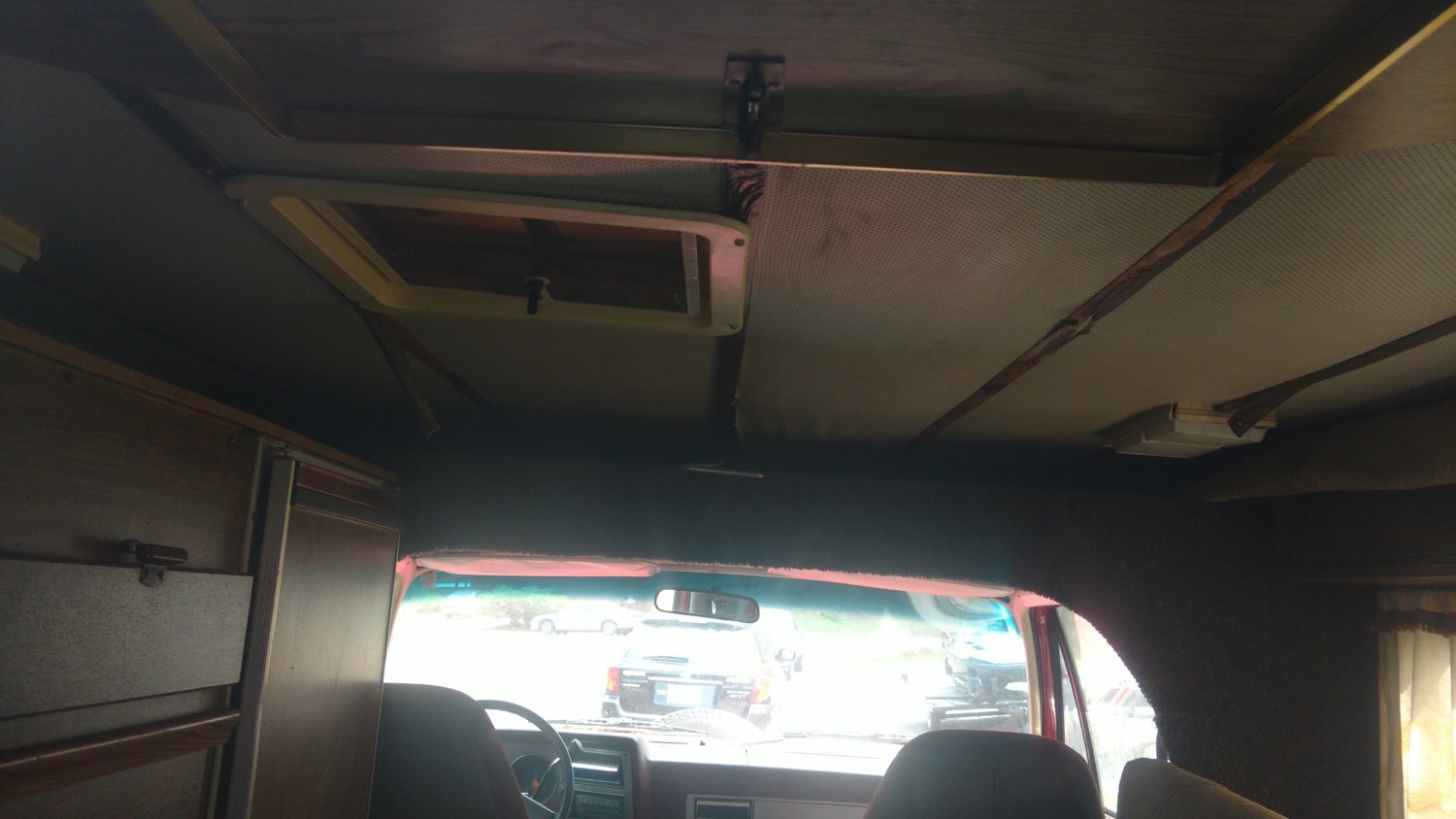

Roof needs resealed. Going to do some research on the hot ticket to fix this. Bedliner is one idea Larry said is common. Needs a new roof vent too.
Headliner is sagging, but is pretty easy to replace after the leaks are mitigated.

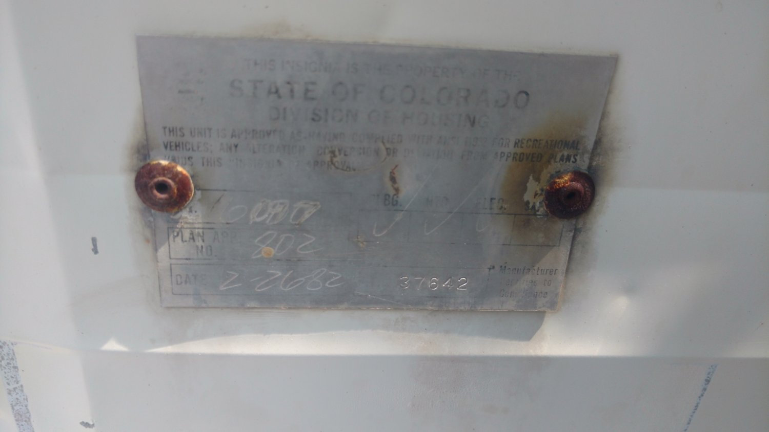

The tag shows it is a 1982 model.

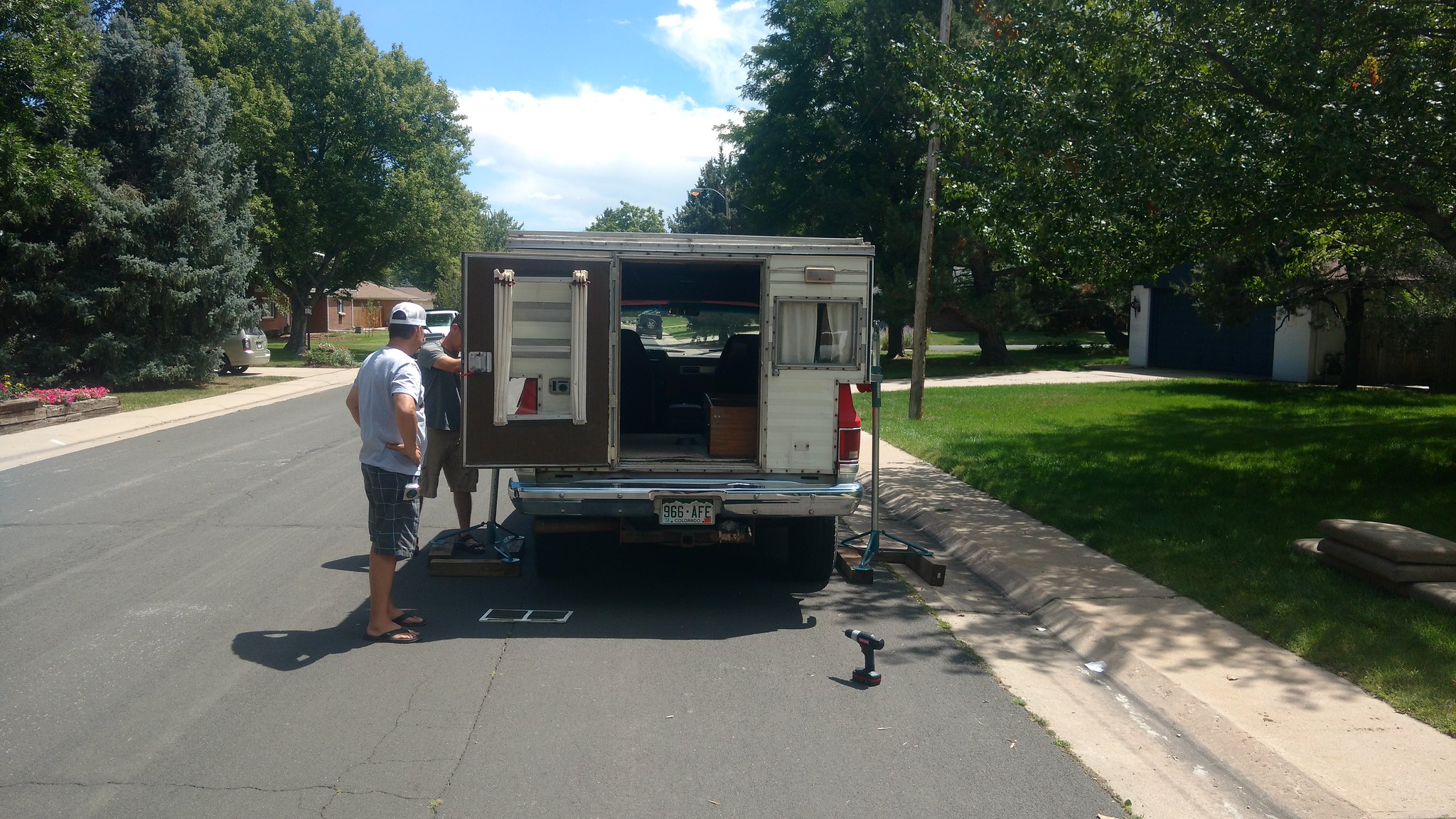

Wow that was a long day. But we managed to get to Denver, swap the stock top onto my buddy John's trailer, pick swap on the camper, come back home, take the camper back off and put the stock top back on in about 12 hours. Had one minor hiccup, but it went pretty smooth.

Since the Blazer was sitting at my Dad's house this week, he helped while we were on the way up by crawling in the back and removing all the bolts to the top. Pretty impressive since he's 78 and still recovering from his 2nd knee surgery in a year. It was a big help since we had the top off within a few minutes.
Top off, Utah dust still inside.
IMG_20170813_112605615 by Rob Zulian, on Flickr

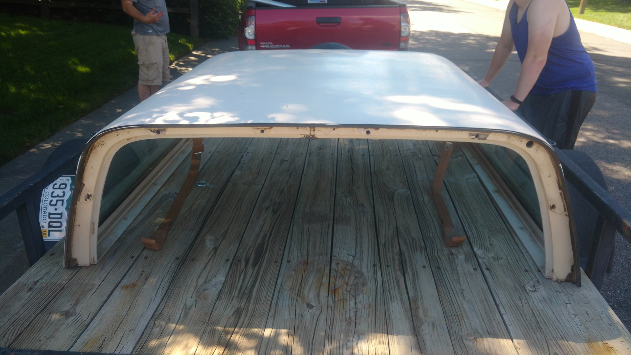

Top on Trailer.

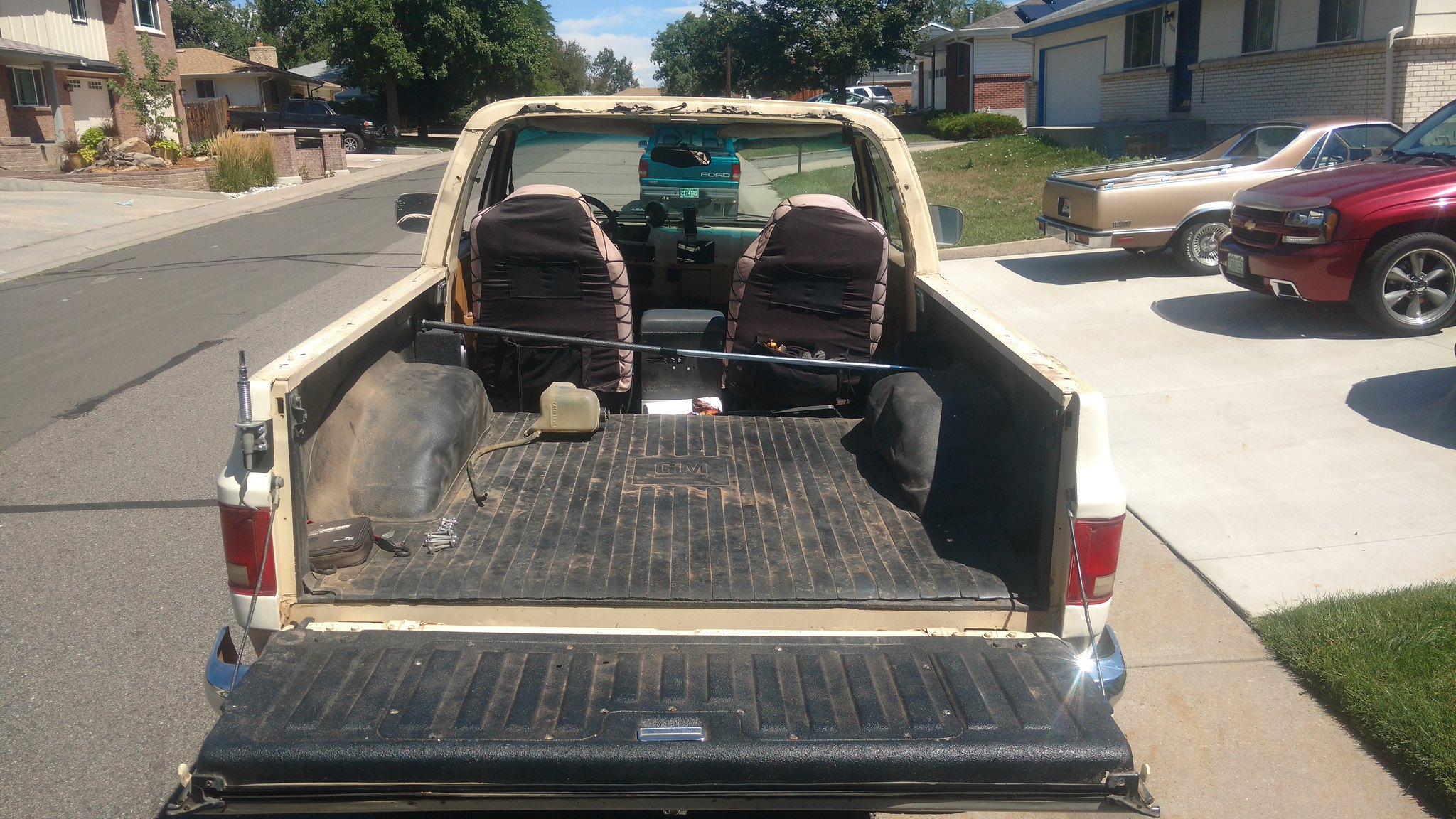

Topless.
IMG_20170813_114728557 by Rob Zulian, on Flickr

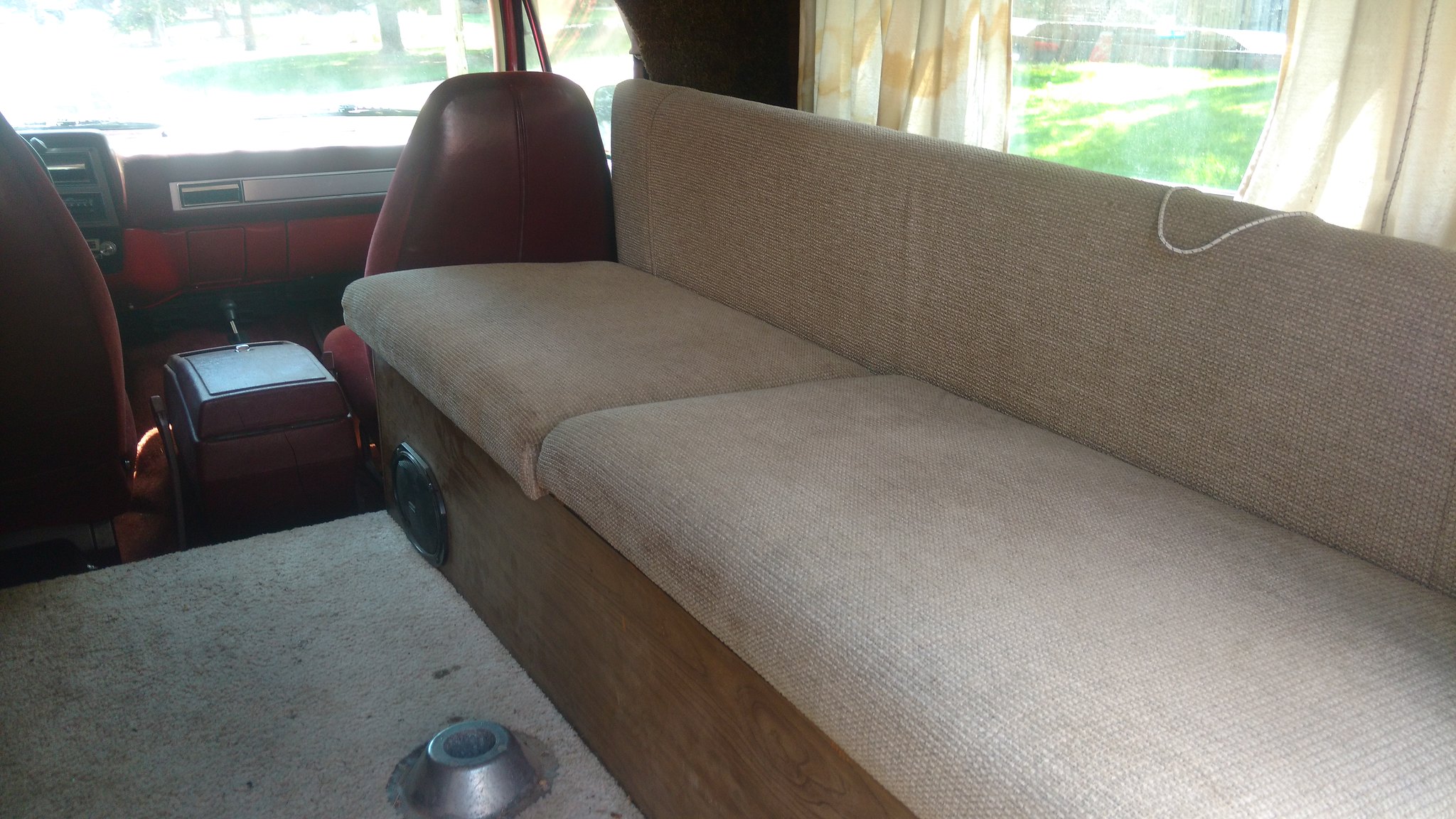

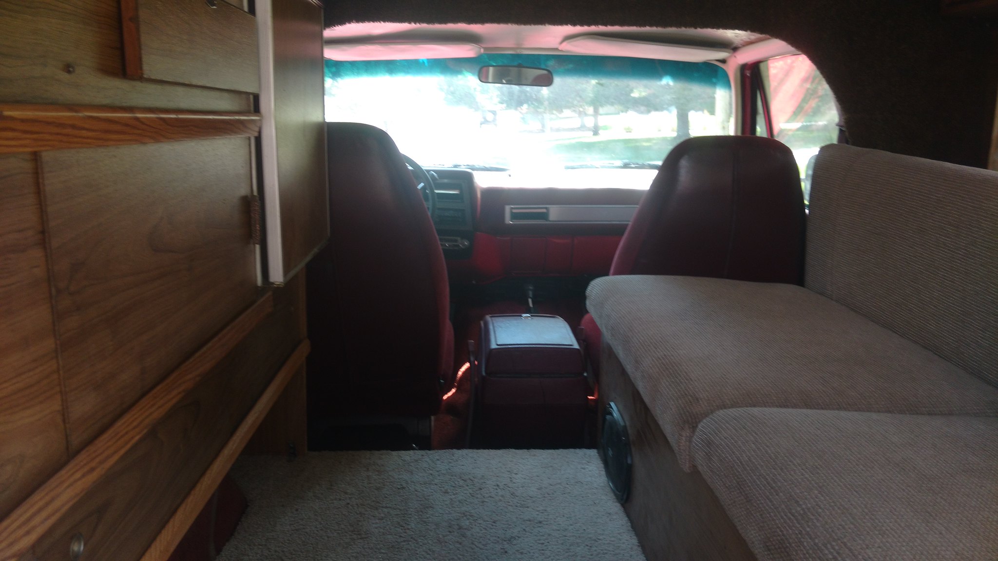

Pretty clean inside, but the carpet is going out, the shag on the walls is going away as well as the dingy curtains.

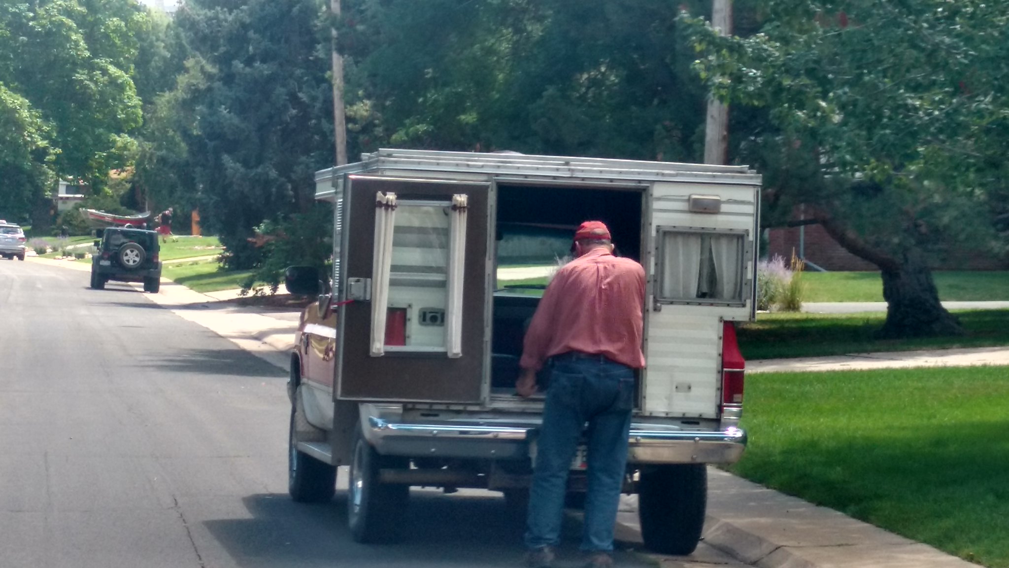

The resident engineer checking out the donor. (aka Dad)

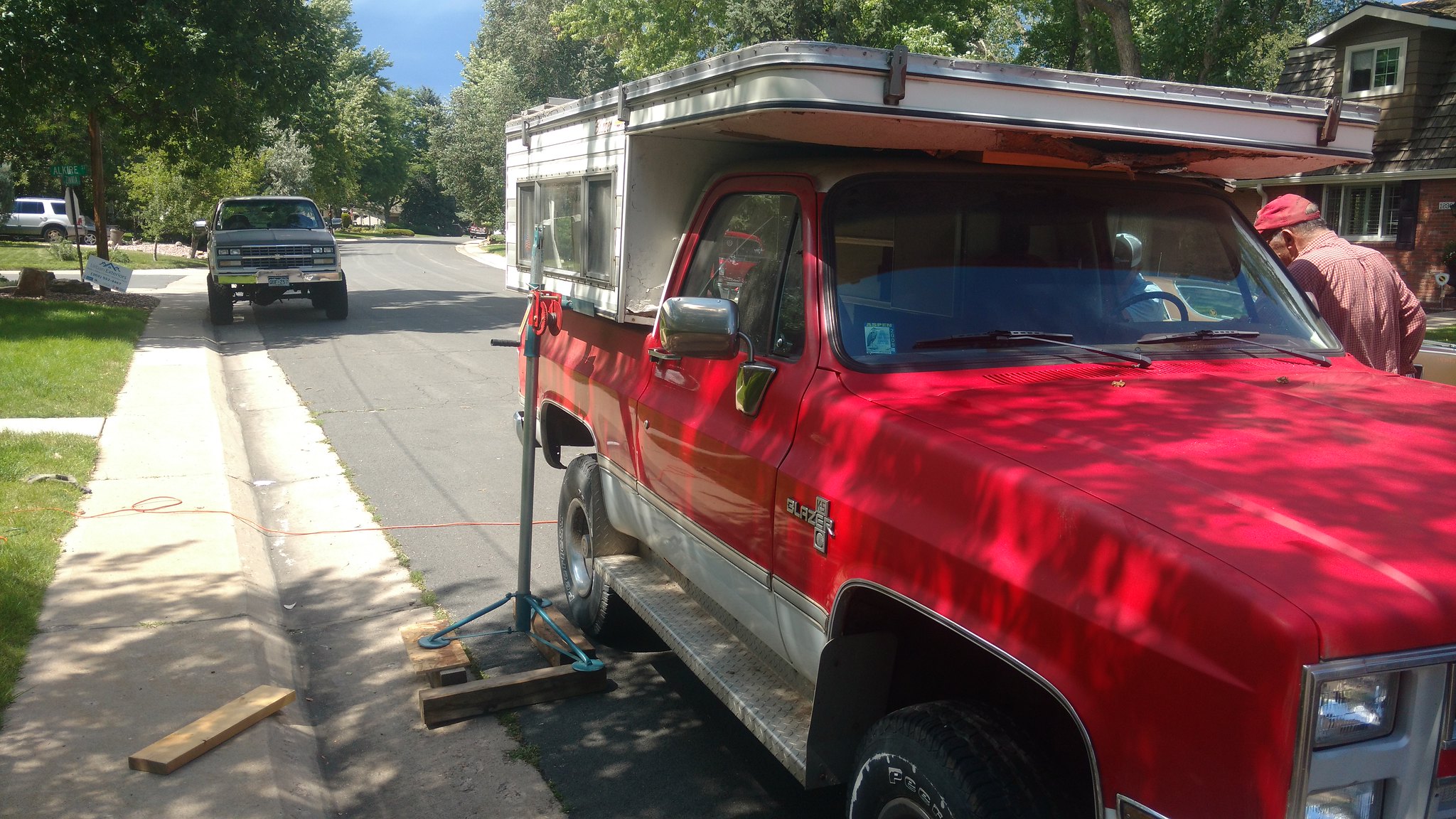

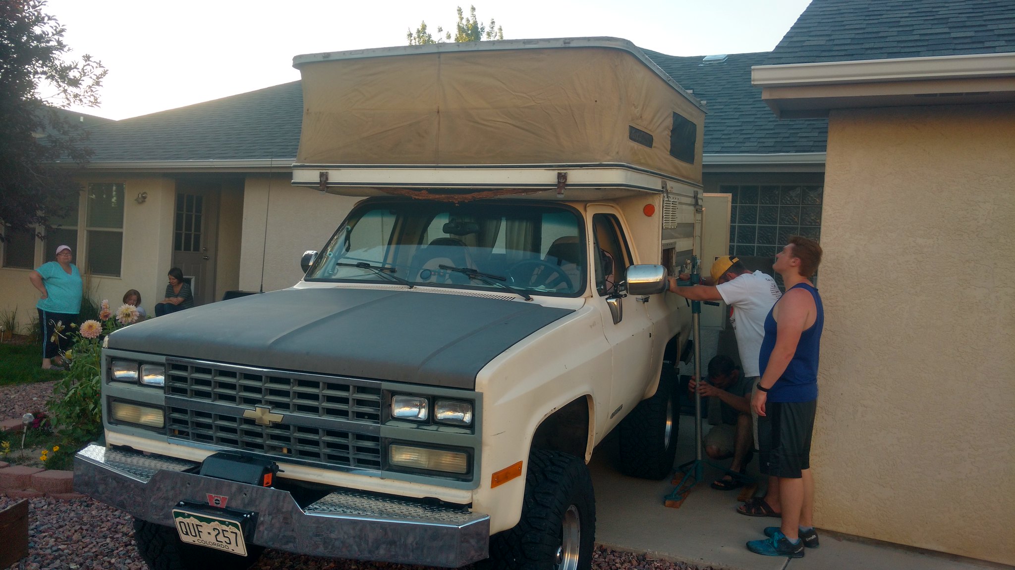

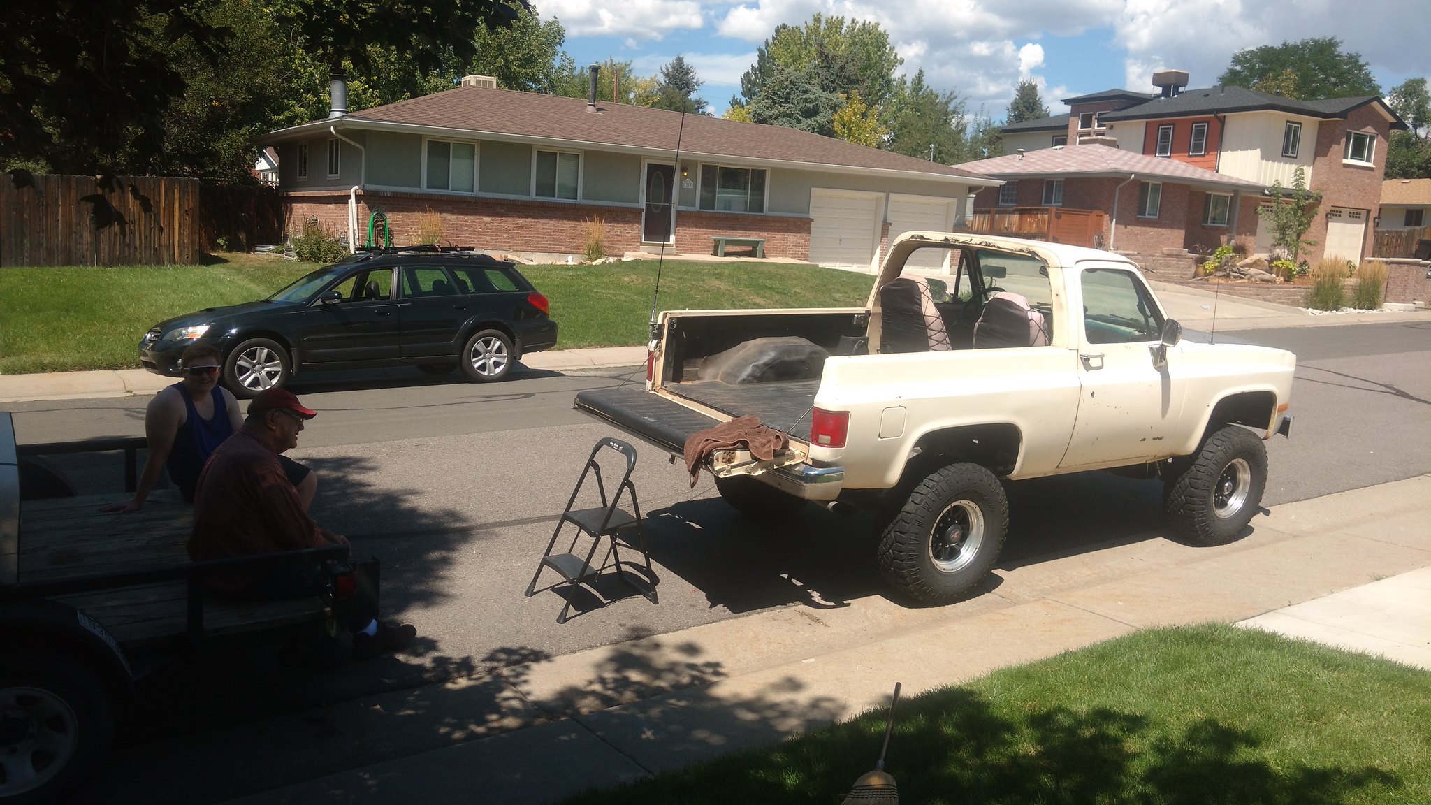

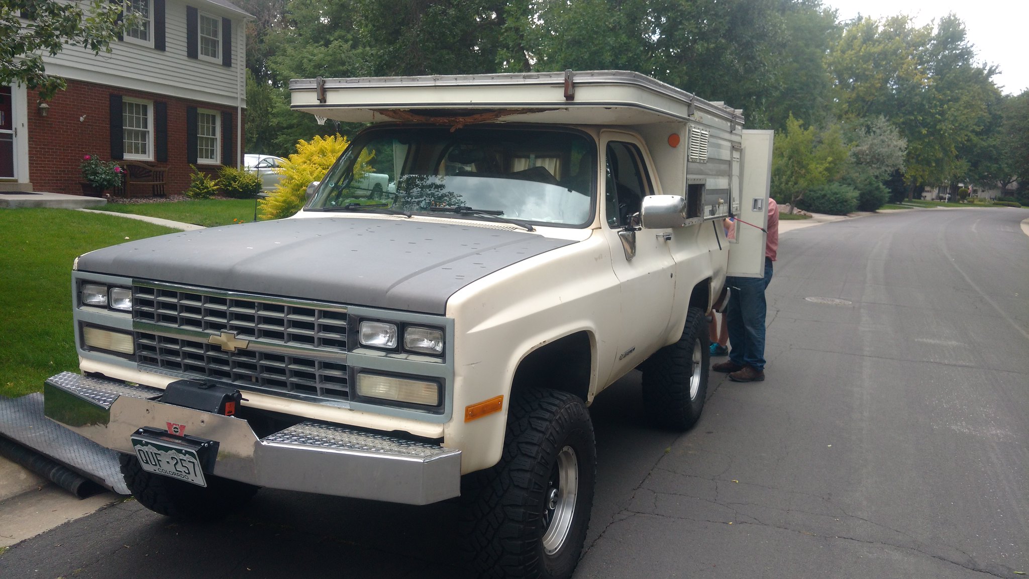

This is where things would get interesting. We needed to figure out if the jacks had enough lifting height to get the camper high enough to reach my truck. The donor is stock all the way down to the tires. Mine is sitting on 35" tires and 4" worth of lift. It was quickly found that the camper jacks just barely reached the stock Blazer, so some technical jenga work was in order. Multiple chunks of wood to get the jacks up higher so we could get one truck out from under it and then crank it up and pull mine in under it.
IMG_20170813_133200019 by Rob Zulian, on Flickr

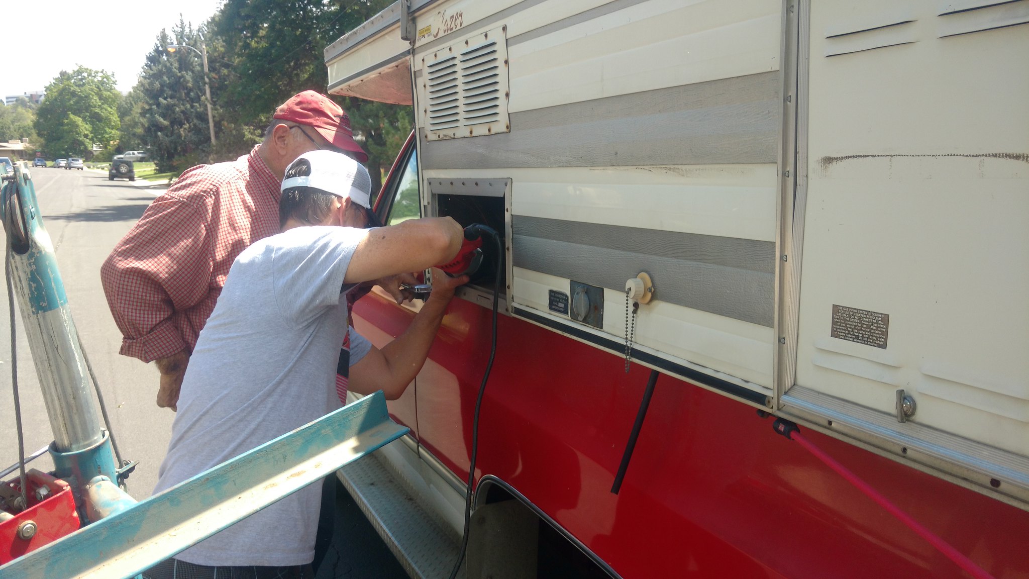

This is where we ran into the biggest issue of the day. The most forward bolt had it's caged nut in the body strip out. I had tried to snap it loose with my 1/4" drive matco cordless impact but it just spun. His Blazer still had the interior side panels so the only way to see the bottom side of the bolt was to remove the ashtray, but we still couldn't get anything on it to hold it. So a sawzall was brought out to take the head off. We lost the better part of an hour screwing around with one bolt.
IMG_20170813_141908767 by Rob Zulian, on Flickr
Me goofing around taking pics while the guy gnaws away at the bolt.
IMG_20170813_142008963 by Rob Zulian, on Flickr
It's off! We then had to remove the floor from the other blazer to set it into mine prior to dropping the camper on.
IMG_20170813_142906896 by Rob Zulian, on Flickr
After a nerve racking few minutes of backing up, re-aligning and backing up again we finally got it lined up to lower the jacks.
IMG_20170813_150719087 by Rob Zulian, on Flickr

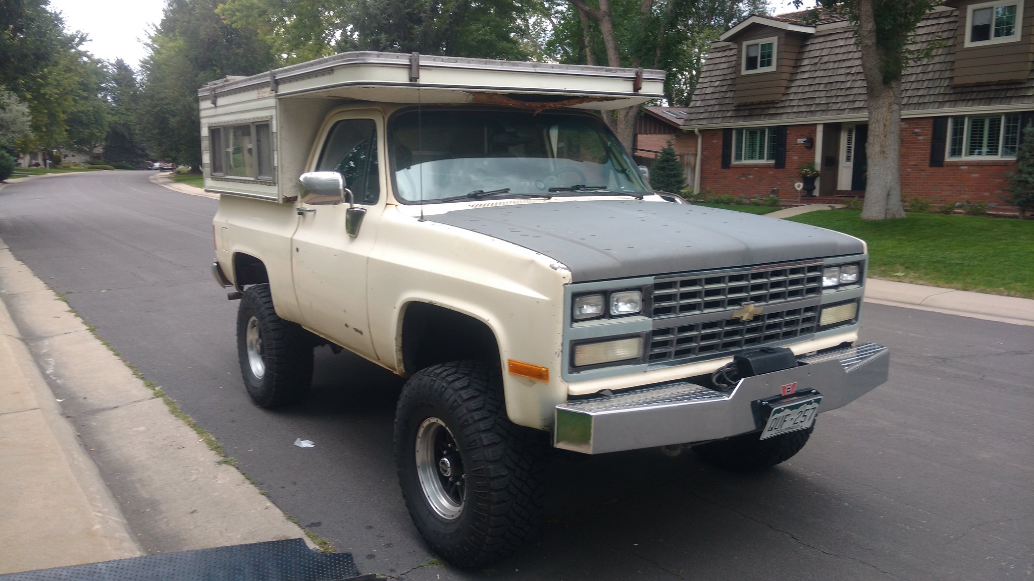

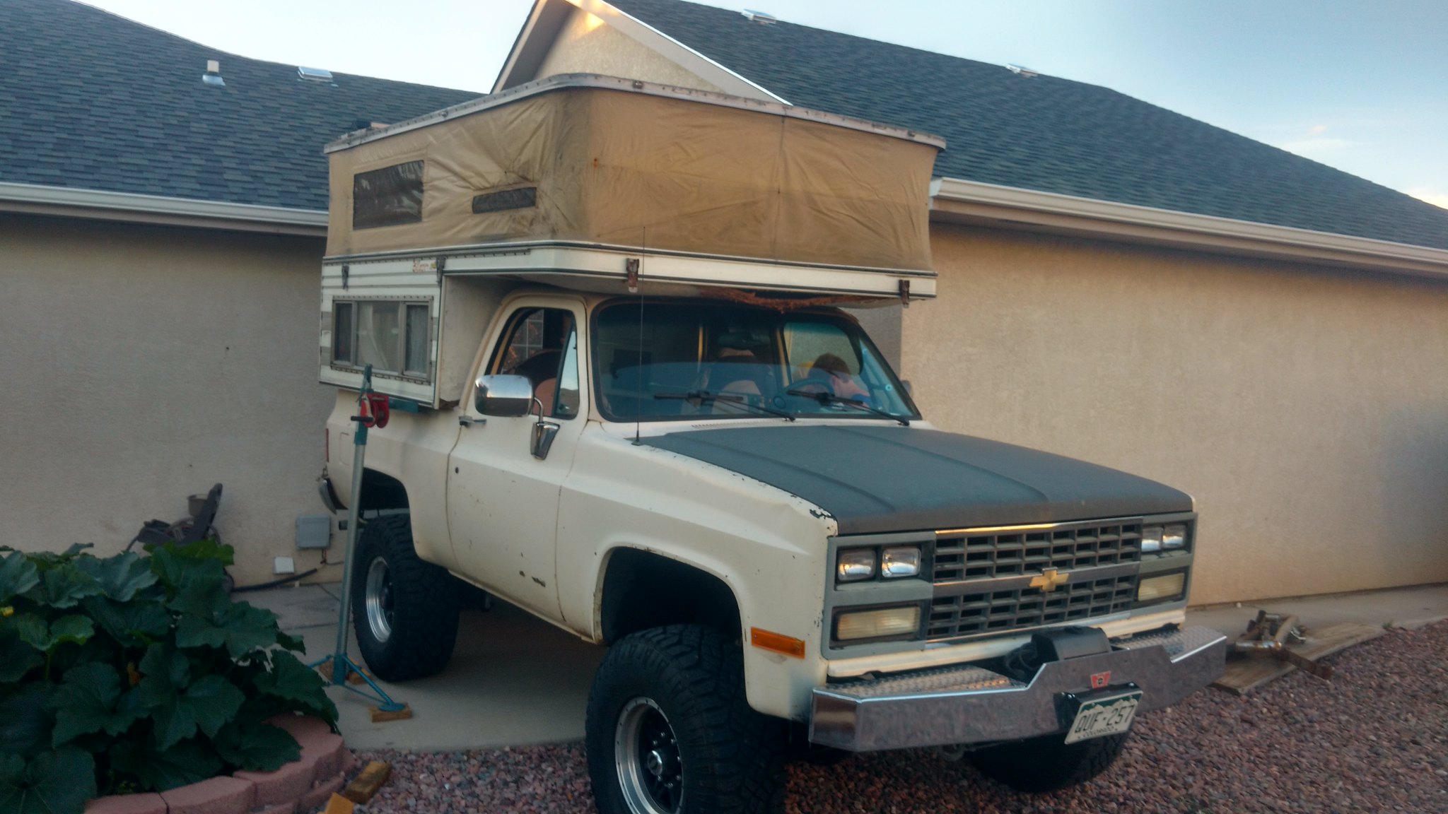

Back in Pueblo. This time at John's place. I was able to pop the top fully with both lifting panels. It's not as smooth to lift as Larry's is, since the lifting mechanisms are completely different, but it works. We will have to rebuild the front lift panels due to water damage. Top needs cleaned, but is free of rips and tears.
IMG_20170813_192341476_HDR by Rob Zulian, on Flickr
Other side.
IMG_20170813_192354186_HDR by Rob Zulian, on Flickr

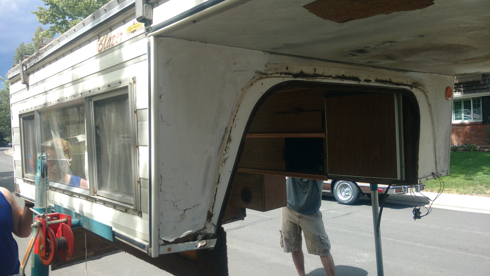

After some organized chaos getting the camper back off again, we dropped it down closer to the ground and could see all the issues with the roof that caused the damage. Screws loose, exposed and the vent that is blasted but covered with a chunk of tarp and tape are the main issues. No tears in the roof itself though. We got the stock top back on in the dark and called it a day.
The 2hour drive down was interesting. The hole in the front of the roof was gulping in more air than any part of the windows would let out. Anything past 65 mph caused the top to develop some lift I could see in the mirrors. So we kept it at 65. This will go away when the wood is replaced. I will say it didn't feel much different to drive with the camper on.
