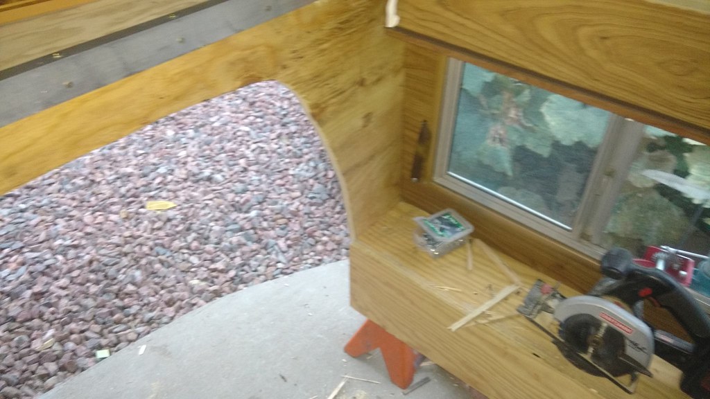

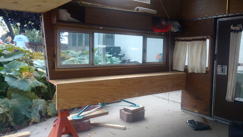

John and Shane got some done before I got there. The entire passenger side wood section was replaced with 5/8" plywood.
IMG_20170909_172350175 by Rob Zulian, on Flickr

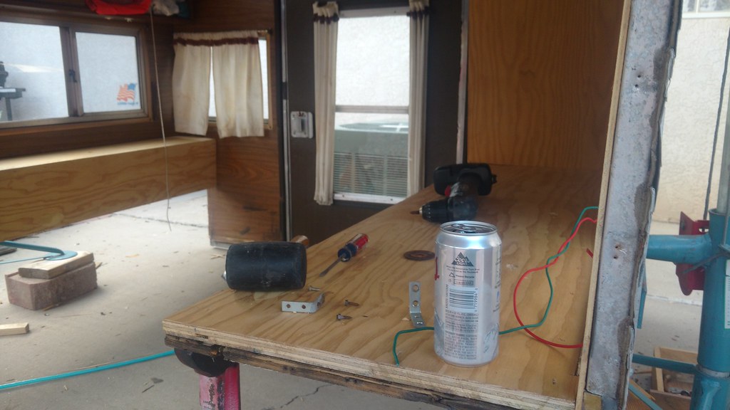

We doubled up the wood on the drivers side for the floor of the cabinet.
IMG_20170909_172354905 by Rob Zulian, on Flickr

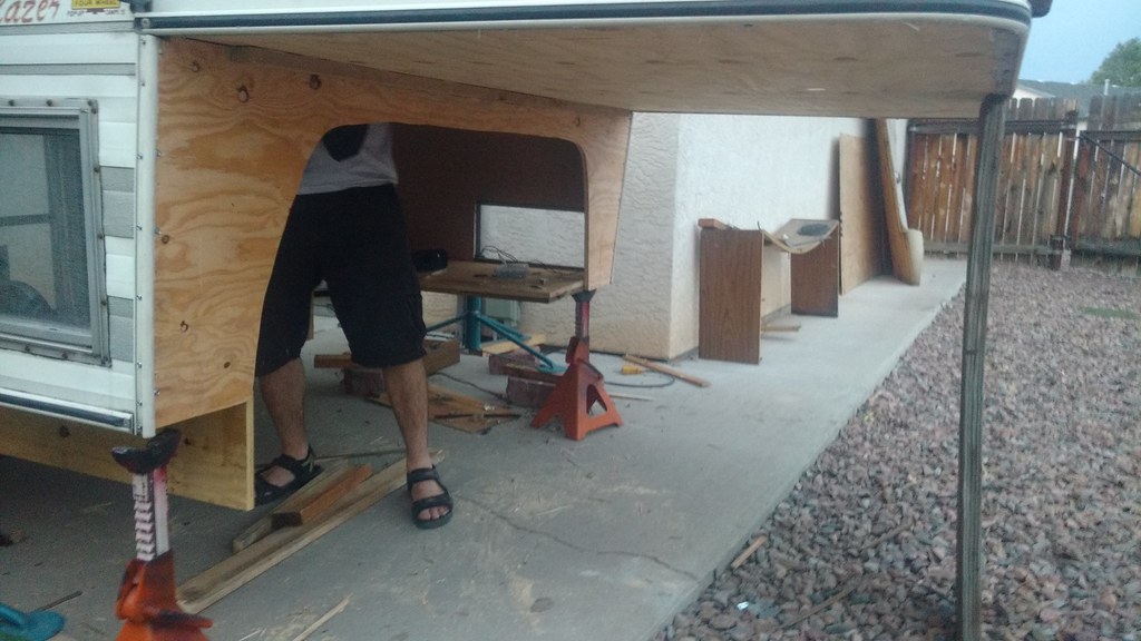

Most importantly we were able to cut a replacement panel for the front wall of the camper to the cab. 5/8" thick, stapled and screwed into the frame and floor. We did add an oak block to gusset the corner between the cab-over floor and the front wall. We then added back in the aluminum angle that the factory capped the inside joint between the front cab wall and cab-over floor. The camper is now rigid again. The side walls are tied to the front wall and no longer move independently.
IMG_20170909_191516905 by Rob Zulian, on Flickr

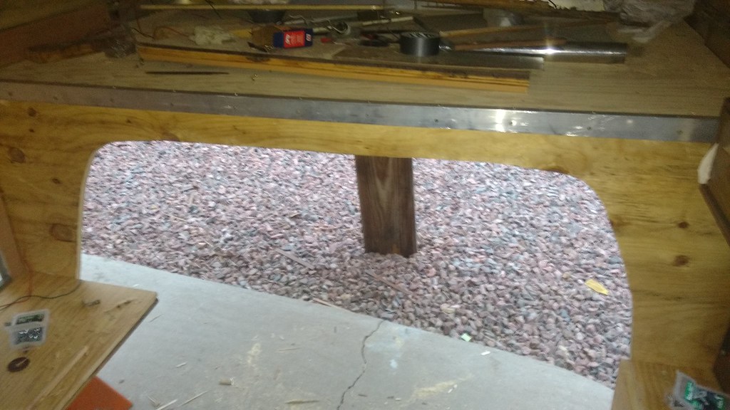

We cut the opening for the pass through larger than the original was. Main reason being the narrow opening on the stock panel on the driver's side blocked my seat from tilting back when it is in the rear most position. (which is exactly where it's comfy for me to drive, of course)
IMG_20170909_191559917 by Rob Zulian, on Flickr

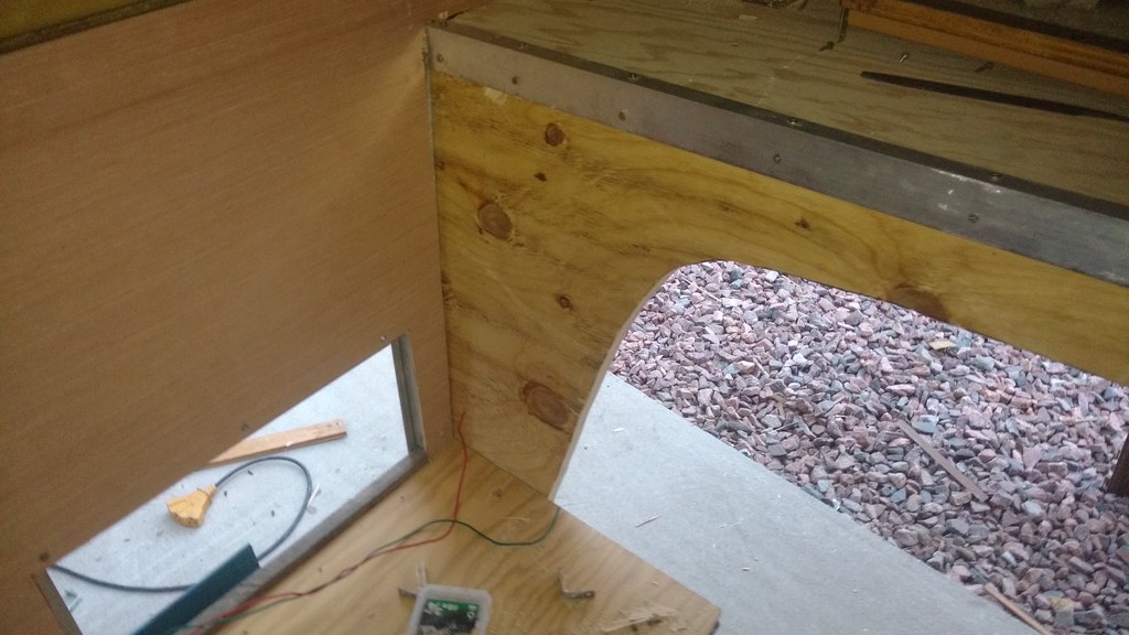

Passenger front corner. We will be adding more oak blocking in the horizontal and vertical corners here so that the joints have additional support.
IMG_20170909_191608145 by Rob Zulian, on Flickr

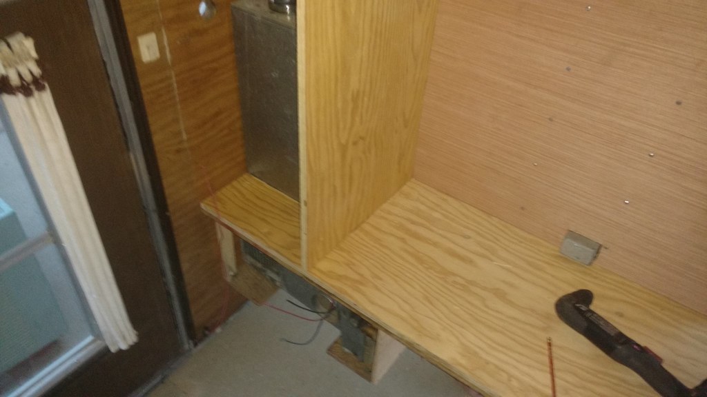

Driver's side front corner. Again, corner gusset blocks are to be added here as well. The access panel that was for the business end of the 3-way fridge is going to be retained. One for camper to bed rail bolt access. Second, the main fuse panel will be located here. I'll be able to access it from the inside or through the outside panel.
IMG_20170909_191613533 by Rob Zulian, on Flickr
