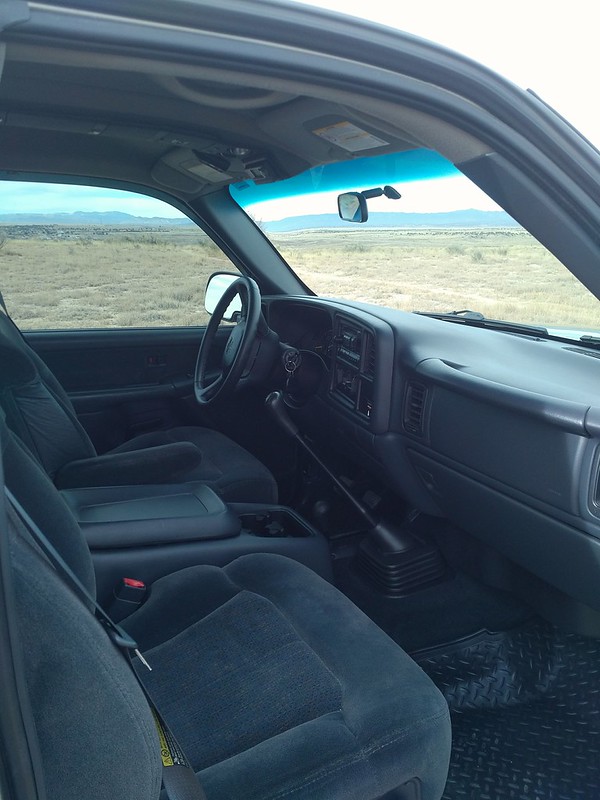

The red and white was really what I was going for. The rest of it just makes me laugh when it's on. I'm done putting lights inside I think. Now I need to move on to adding all the USB ports and 12v outlets I have for it. Then I can finalize the wiring, loom it and tie it down.Party time! Excellent!
