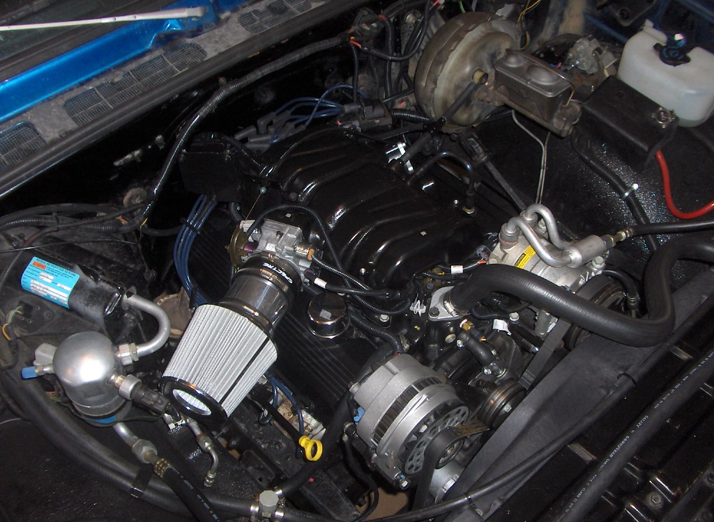

For those that aren't familiar, here's what a L29 looks like. Stolen from Larry's flickr when he had the L29 in his.
