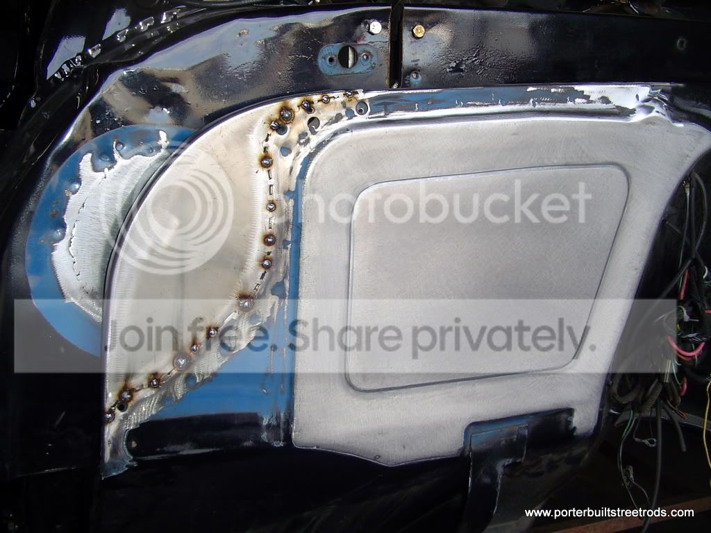

Ordered this to get my firewall like this.
LCN-K2185-1

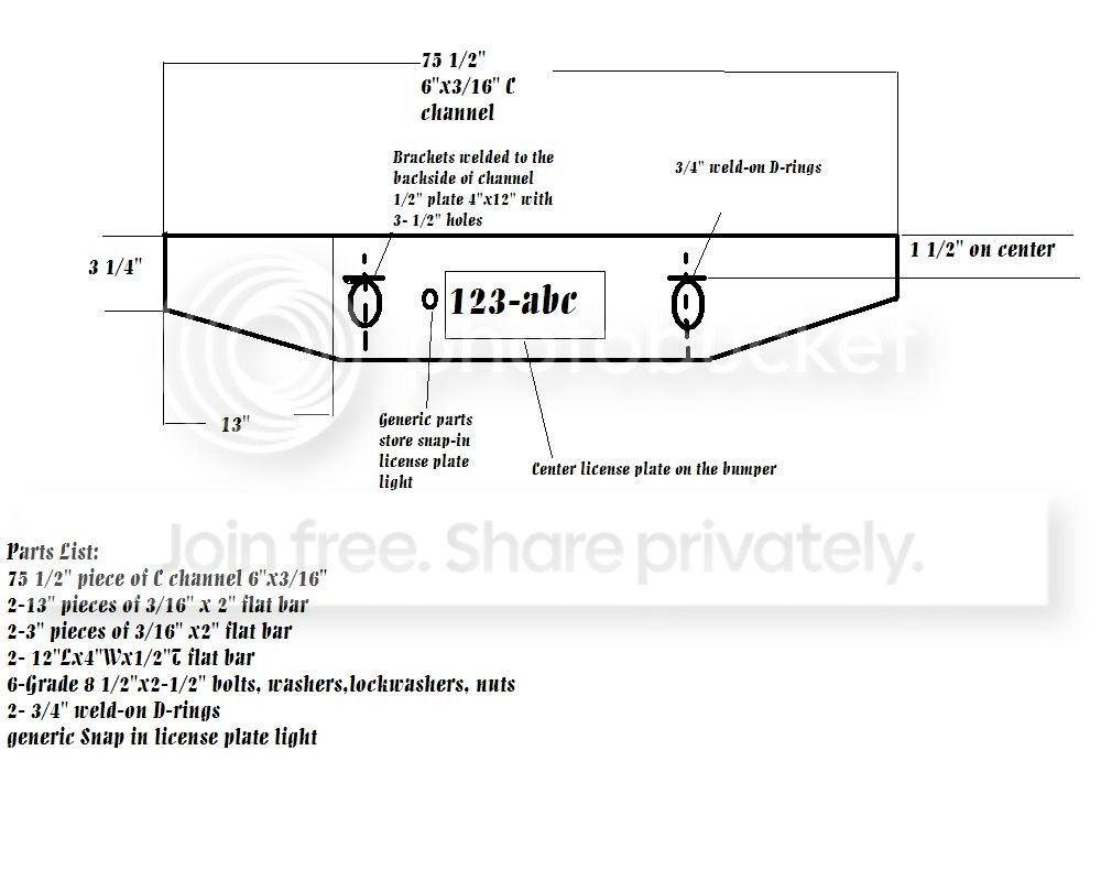

and going to try and build this with a tire carrier added. Yes I know the mig is too small, but we have a 220 amp stick welder in the shop. Might try and build the bumper first as there seems to be more room for error. But, need to get my firewall patched and painted before I put my engine in so I might start there.
Thanks to bigbadchev84 - his design and pic.
Good stuff:waytogo: Just remember to go slower than you think for welding the sheet metal. Just spots all around. And even doing that you can burn through if you get in too much of a hurry.
Good call on the bumpers, I really like the ones on bigbadchev84's truck. You're getting there!
Awesome build so far, Just to give you a heads up I got my last pair of D rings for the Jimmys bumper off of ebay for $21 shipped. The local steel yard was asking $27 each for them.
