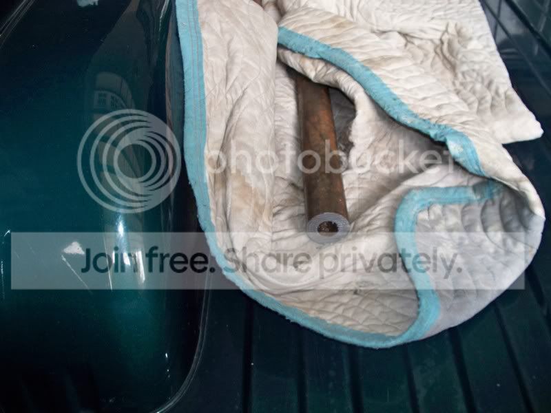

I picked up 60 pounds worth of lower links today :D:D
I was lucky to find this, most of it is solid.
I ended up paying 45 for the steel and 6 dollars for two cuts.
