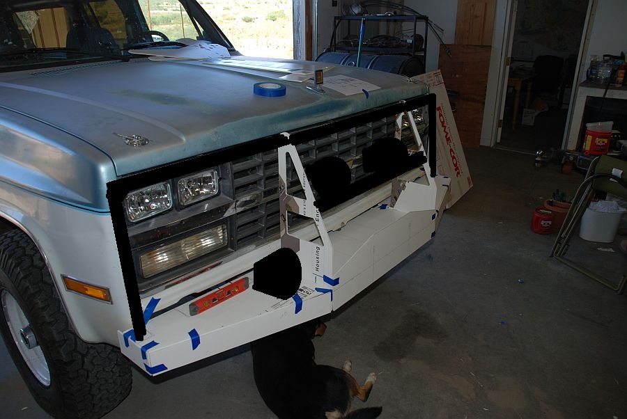

1) You lose clearance and approach angle with that Warn design.
2) A M15000 winch wont fit between the frame rails.

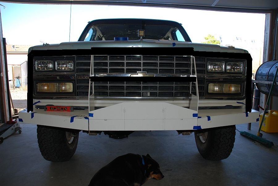

After looking at it for a while it does seem kind of "flat". What I mean is the front edge is 3" tall from end to end. Most bumpers these days are really tall in the center then taper off to nothing at the ends.
I decided this route to keep approach angle and clearance in regards to the center section at a minimal. I could taper the outer ends but that would look a bit odd with still having fender hanging down below it.
The bumpers sections are just kind of there to finish off the whole package to make a complete looking bumper.

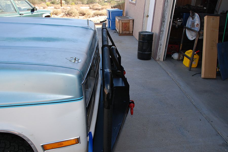

Ok, bumper ears are getting a bit of a revamp. Going to try and have them sweep up a bit but still keep that classic "brick" look.
I am also considering have the grill guards go out then straight down to outer edge of bumper
What do you guys think?

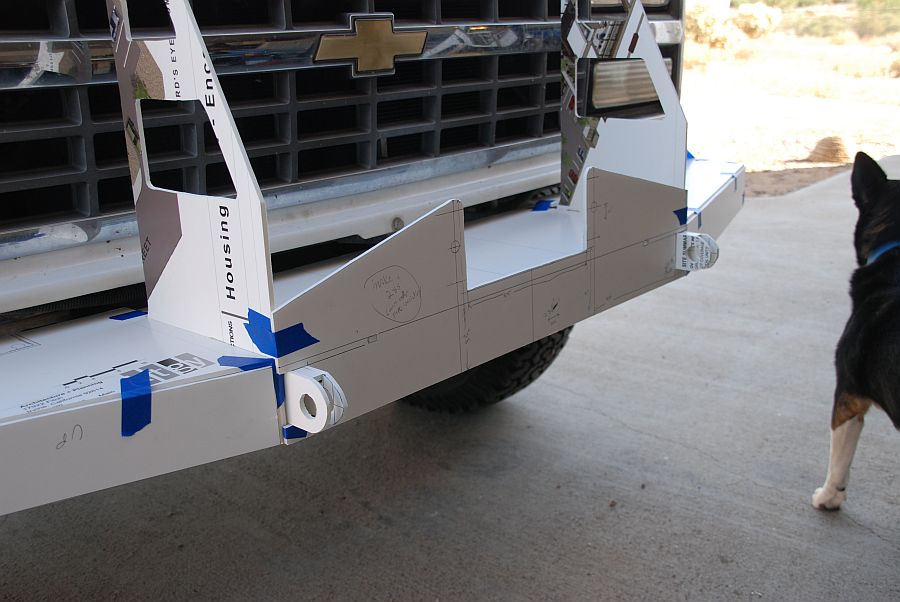

You have to use your imagination but this is another possible alternative for the grill guards.
The idea is you can get just the center section with the uprights. Then later you can add the bumper ends and then the grill guard tubes.

Will hopefully have the final revision of the bumper all taped together and even painted to give the full look this weekend.

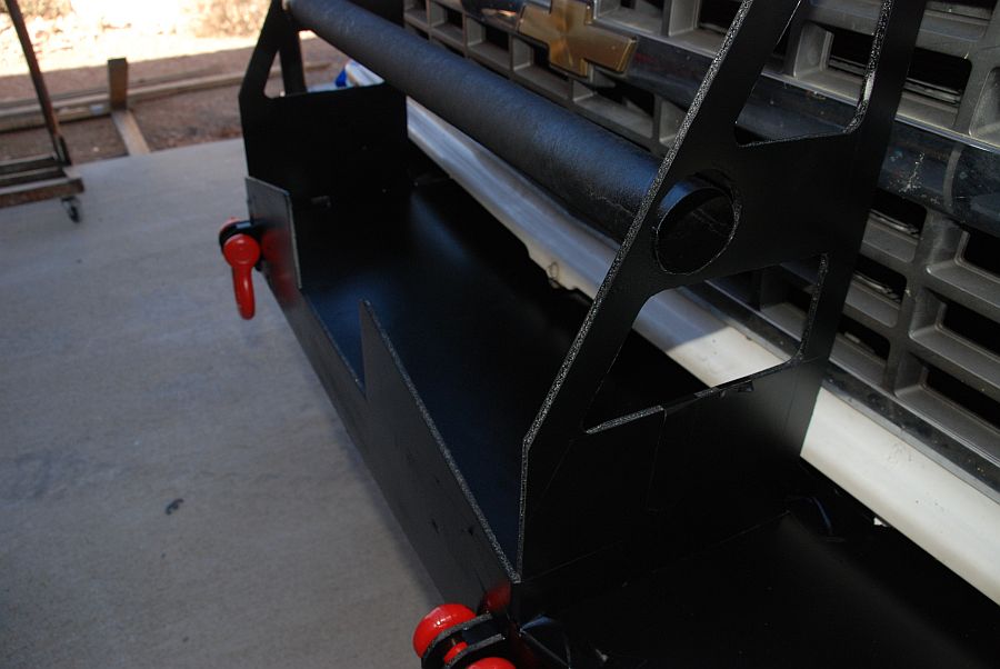

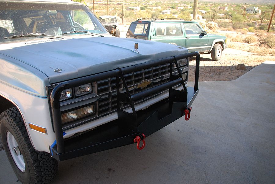

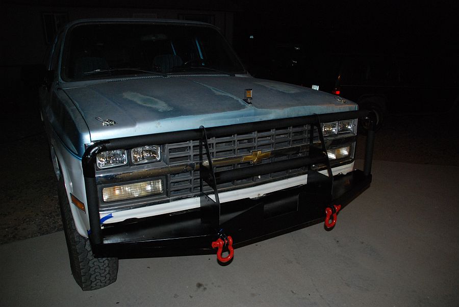

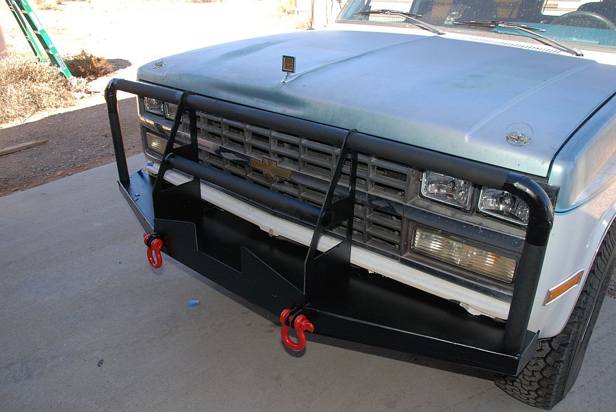

Its a bit of old meets a bit of new. The old Warn Trans4mer bumper meets newer style angle swept bumpers with Bull bars. It will accept up to a M12000 winch and should have just enough room to clear a M15000. the frame mounts are 4 bolts on each ear and the frame is sandwiched between two 3/16" plates.
center section uprights and winch plate are 3/16" material. The bumper sections will be 1/8" the Tubes are 2" dia. with .120 wall. and it has a modular design and can be added to as wanted.

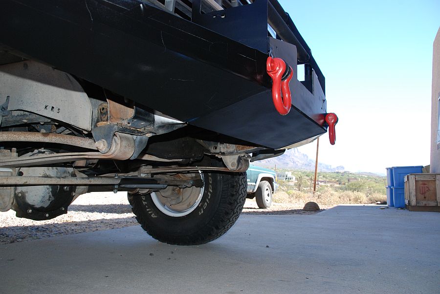

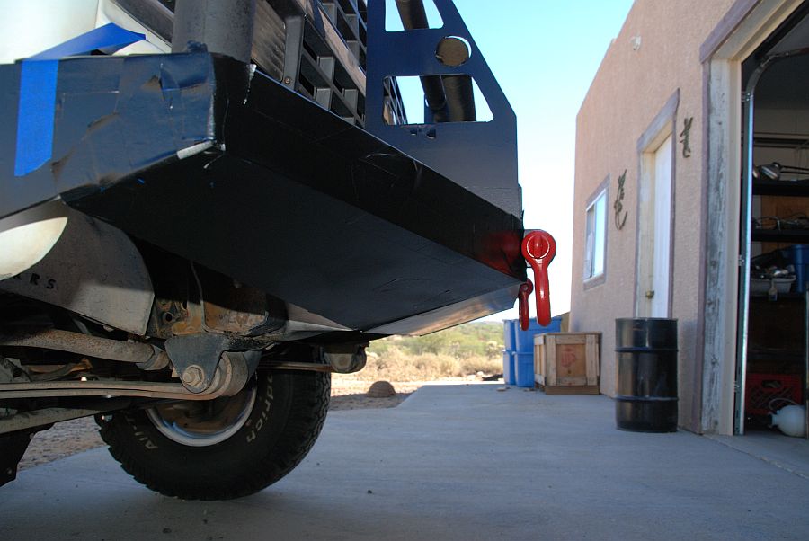

The underside can be boxed in and at an angle to help keep approach angle at its best and to provide extra protection below.
It will have a total of 5 light mounting locations and two 3/4 Shackle mounts automatically.
Total estimated weight with Bullbars is 111lbs
I just started on a close replica of the old Warn winch bumper and estimated weight on that is 70lbs
