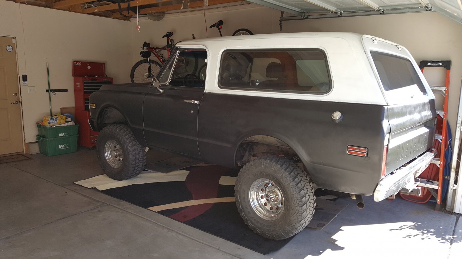

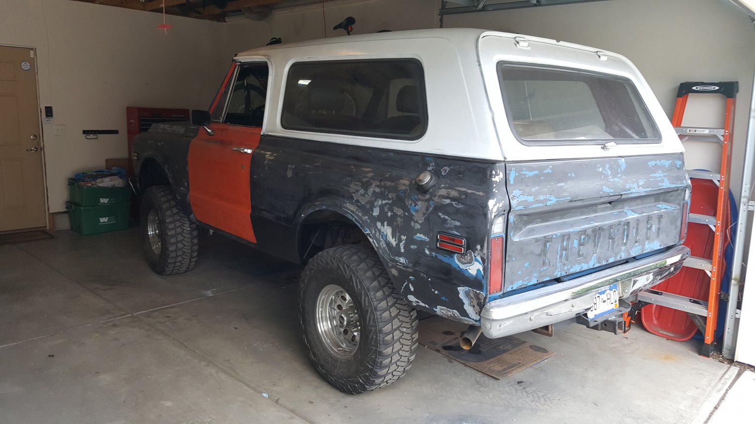

Finished sanding all the paint drips off from the previous owner, plan on re-rattle canning the whole thing tomorrow, just want to make it presentable again.
Pre rattle can
full
Looks better all one color. What did you end up doing to prep besides sanding it all down?
