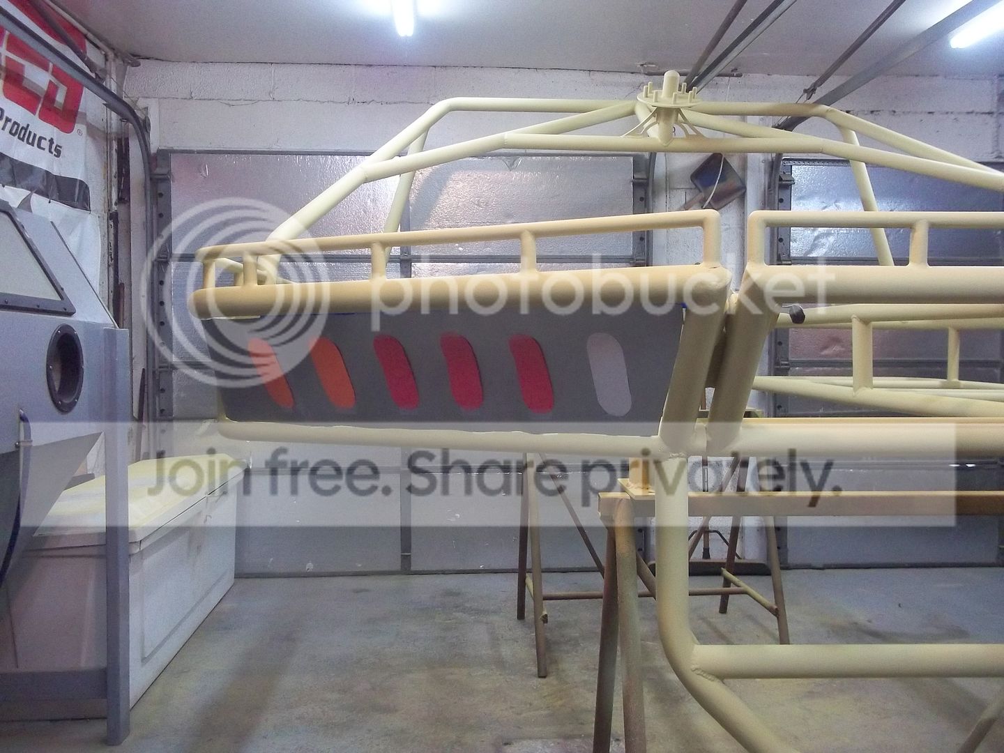

I like the big squares the best, but multiple oval ones vertically would look cool too.
And not to add even more work for ya, but how hard would it be to inset the top inside corners of the lights? I think it would look pretty sweet if the lights faced directly rearward even though the panel is angled out and down.
This ^^^
Recess one side of the lights to have them all point directly rearward

I think it would look killer with those 3 big ones facing straight back.... I'll have to do a mock up of that to see how severe those recess's would be...

ok, here's how it somewhat looks....
it looks like the "deepest" part of the recesses, which is the upper right corner of each light, would be about about 4" or 4.5" deep...
here's a different angle to give you an idea of the panel angle..
so effectively, each recess would be 4 triangular "walls", than a 7" x 7" or so base... so 15 little pieces to weld into little cubicals..
as of now.. I'm totally leaning toward doing those 3 6.5's.. if I plan to do recesses, at some point, I definitely want to do 3, not 5...

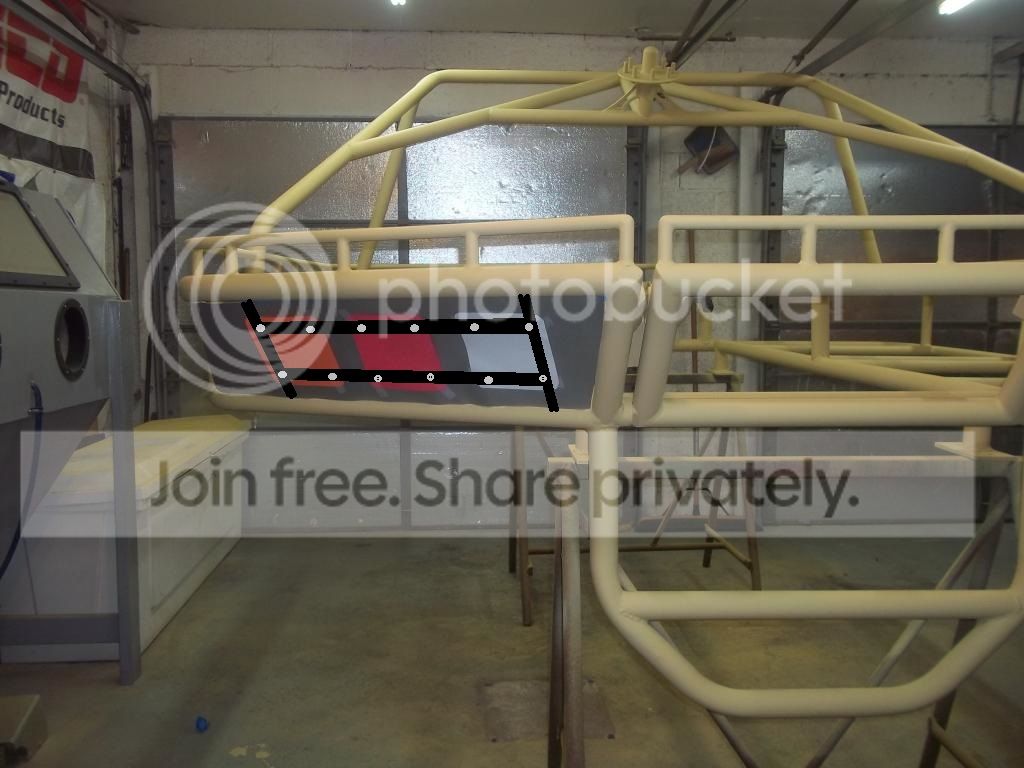

I may be able to just do a steel frame structure from the inside of the upper tube down to the lower tube to mount them to... that would sit 1" behind the surface.. which is what the lights thickness is after rechecking dimensions.. so the lenses would sit flush with the alum..
it could be as simple as 2 vertical pieces of strip steel per light where the mounting holes are... or even 2 parallel ones the length of the 3 lights, with a vertical at each end or similar..
that actually may work even better, cuz it may be trickier to flush mount em in the alum only.. you would probably need to make a removable frame for the back to retain them, bolt to.. cuz you wont be able to pull them out the front..
with a steel frame that they are bolted to, you would have to remove the 4 countersunk allens and remove the alum panel to take the lights out, but I actually think that may be easier, considering the alum fab involved... and you can still access the backside wiring easy peezy all the time...
maybe something like this.. out of some 1" x 1" x 1/8 angle for rigidity.....

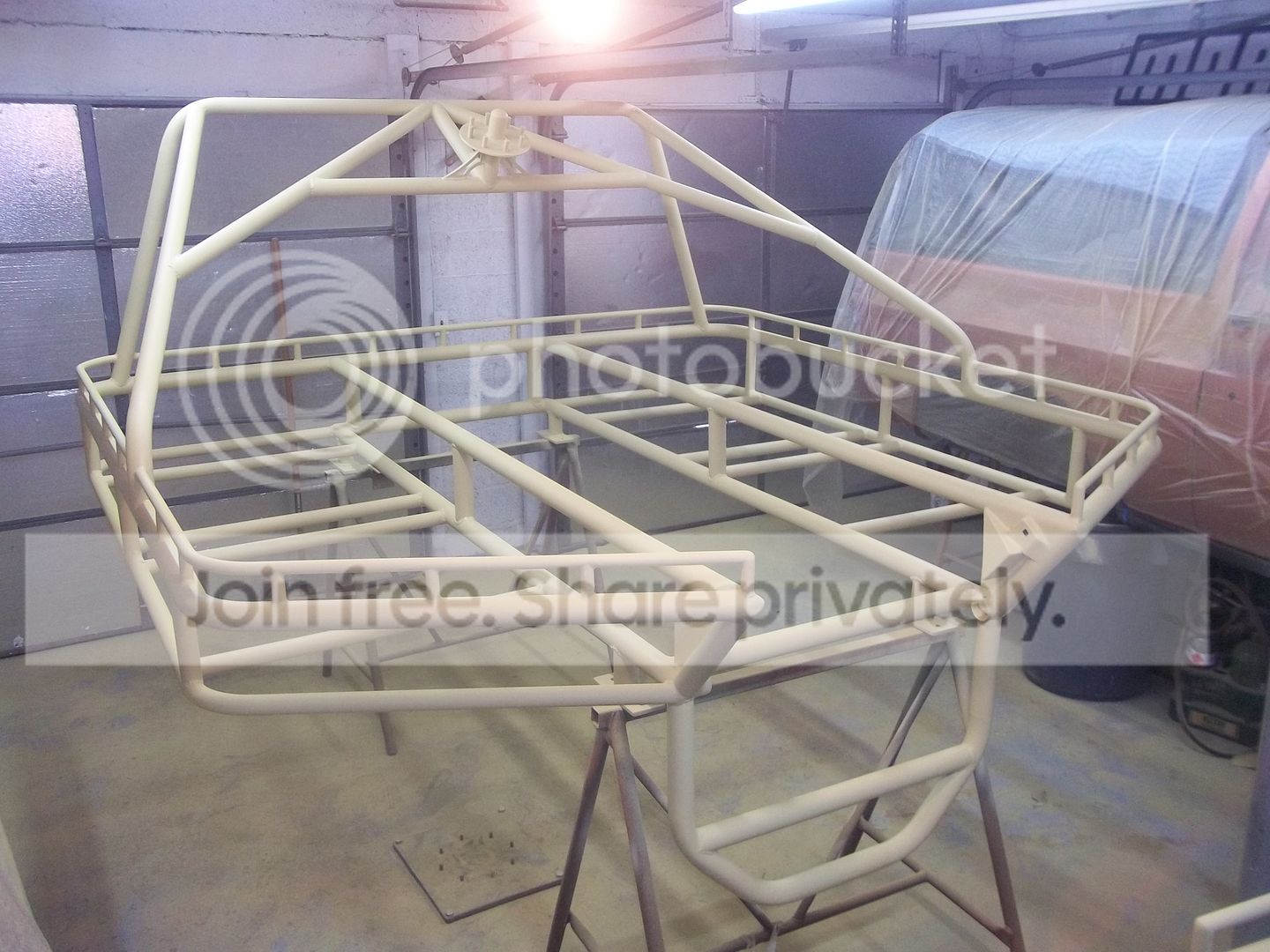

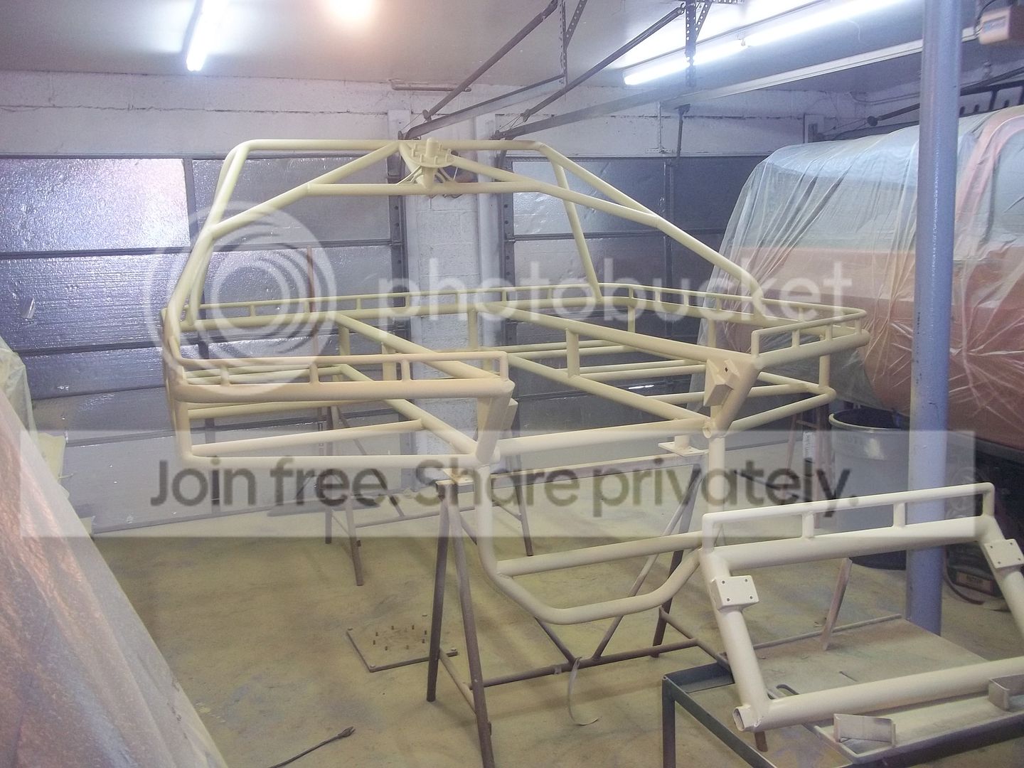

feel like I'm back painting cement mixer frames again! :doah: :haha:
time/material consuming.... went thru a 1/2 gal of primer getting it all coated in jet mode on my back...
still a whole bunch of panel mount tabs (probably about 42 to 46), box mounts (24) and support bars to weld in, but I'm glad I got it overall coated now...

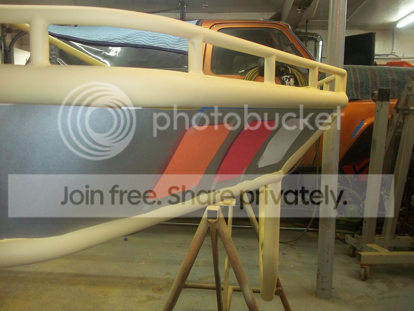

that said, that's tomorrow's agenda... now that I have that gray panel in there and plenty of orange and red paper, I'm gonna mock up all kinds of different configs that we talked about today.. to take a peak at a bunch..
I have nothing going on till I get the alum next week or so, so taking a couple days now to mess with it is good... supposed to be pretty warm tomorrow too, good day to hang in the LAB™ and cut out paper dolls....

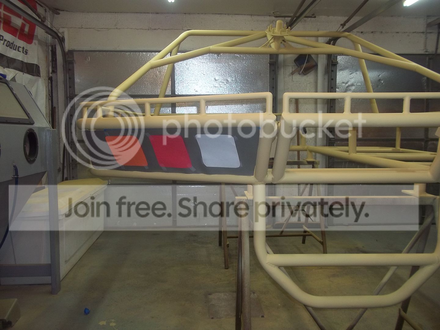

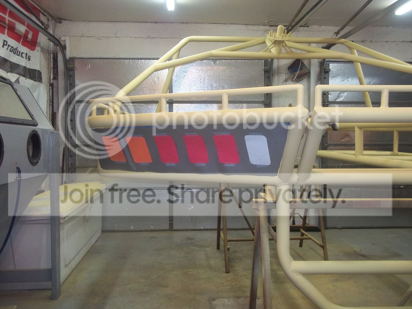

hmmmmmmmmmmm, they all look kinda cool........... :dunno:
I'm kinda digging the first one, 6" ovals... keep in mind, the first 2 would have a say, 3/8 border of black rubber around them, as they are the flush grommet styles...
I like either the top or the bottom one. The first one looks real good.
But now that I look again....I like the middle one too....
When it comes to lights, I tend to like to see a lot of lens
well, I do too in this app... but #2 may be a bit tight and busy.. they are the 5" rectangles..
when I went down this morn, I was guessing that was the one I was really gonna like... but you have to keep them spaced pretty close, and will get much tighter looking when you factor in the grommet's.. plus it starts getting tight to the rounded corner...
still it looks good there.. they are 24 LED's per light...

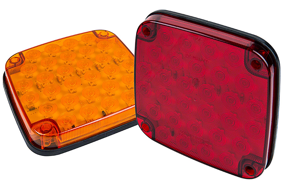

amber and reds $20 a piece... reverse $31 a piece...
total price $231
#1 6" ovals... I really like this one, didn't think I was going to... with the grommet's, they would probably space well, and not be stoopid crowded...
these priced out as... the reds and ambers are $20 and 56 LED's :eek1: :bow:
where as the damn reverse lights are 10 LED, and $30 a piece..
for a total price $260....
the known #3.. which will be by far the most amount of work to flush.. by far... are $250 for the 6....
tho #1 is the most money, I'm kinda leaning toward that look at this point... they seem to space well, top to bottom and side to side...
#2 is still a possibility, just wanna make new paperdolls that incorporate the black grommets and see how tight it really is...
