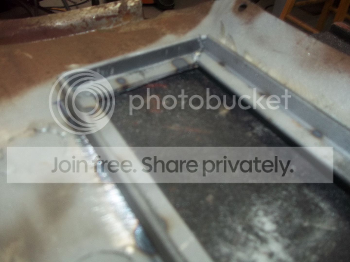

the set I posted I'm not worried about at all, they are often used on deck type surface hatches on boats.. notorious for sand, etc getting in them... they get chit in em, ya rinse it out with a hose... no big thang...
a nice feature about those Southco ones is they are a tapered, spring-tensioned catch, so they "click in" and will not rattle..
the other aspect is that I'm pretty certain I'll be running that same cut-down, thick, rubber truck bedmat that I run in the back of the K5 in that compartment floor.... so being flush, is vital..
tho it'll be a 2 piece, fitting over the large fixed, and that piece seperately... 1 piece would be nice, but obviously becomes a storage issue when towing.... that should also help mitigate any crud loading issue... when I rinse the truck off I can just pop em out, wash em, and the coffin out, etc..

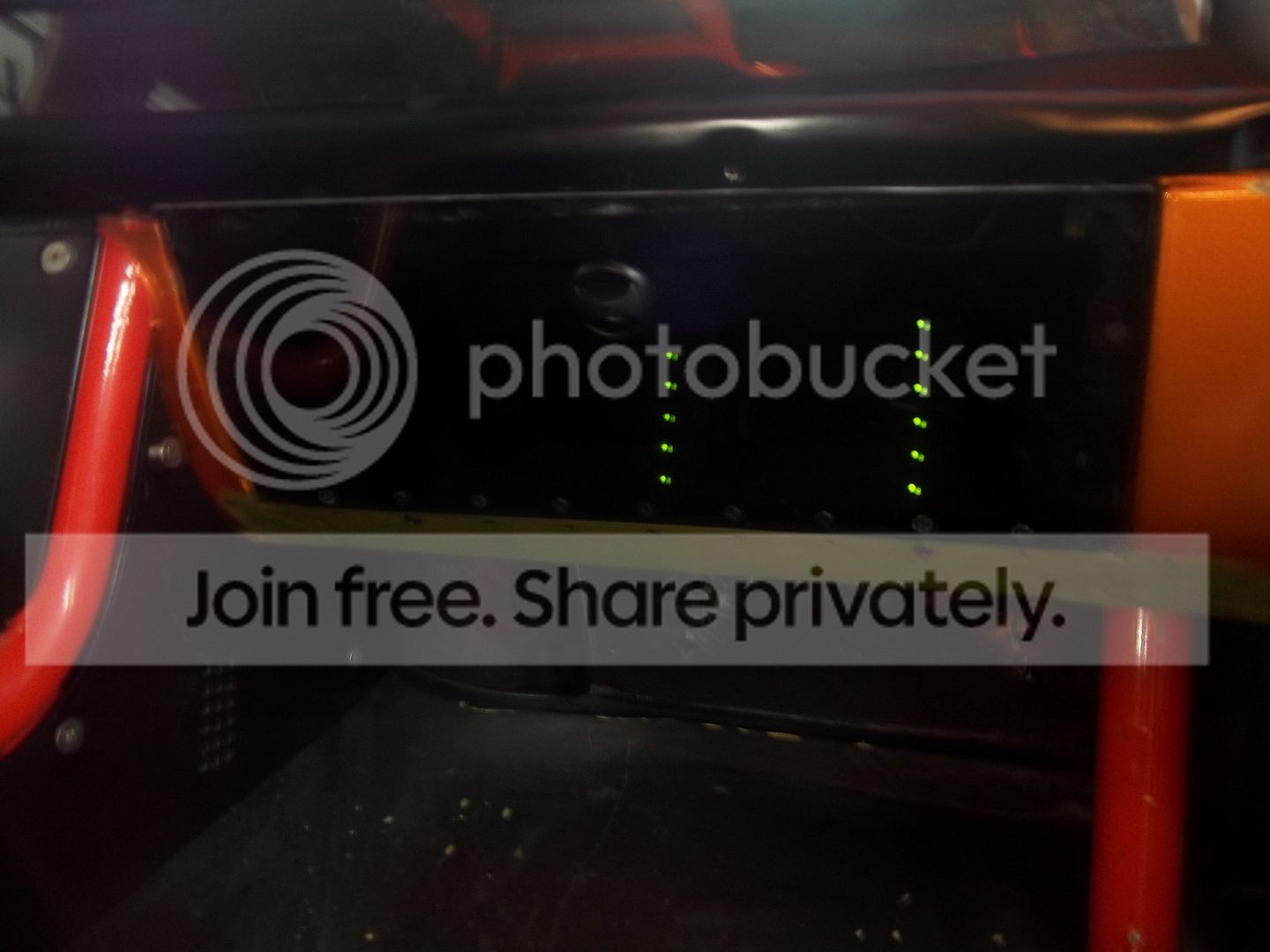

you can see at the top of this shot, on the dash how that black, unlit panel looks with no lights on... should standout pretty nice from the alum surround..

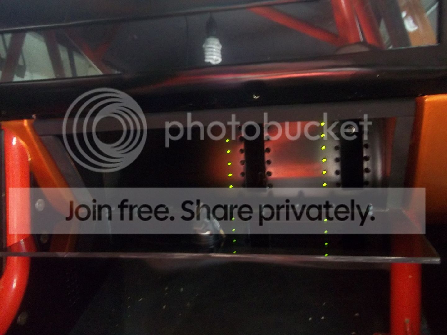

yeah, the taillightas are flexible strip LED's like in that dash project.. you direct them into the side edges of the plexi.... they look like this...
