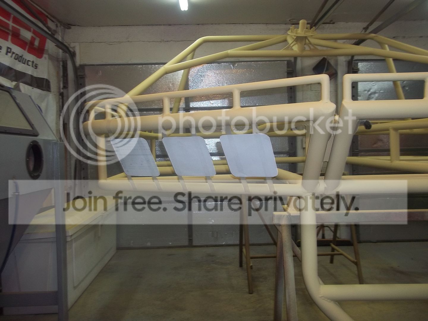

hmmmmm... been down playing around with paper cutouts of the different sizes.. the square 6.5"s, those grommeted 5 x 3"s...
and now I'm not sure if rectangle or square is the way to go.. round may be a better look... gonna try them next...
it's just such an odd view from directly behind with that panel having 2 different angles going on... maybe I'll take some pics of paper mockup's for ya...
see the kinda stooopid sh*t ya get out of me when I don't have materials/parts to fab with! :doah: :haha:

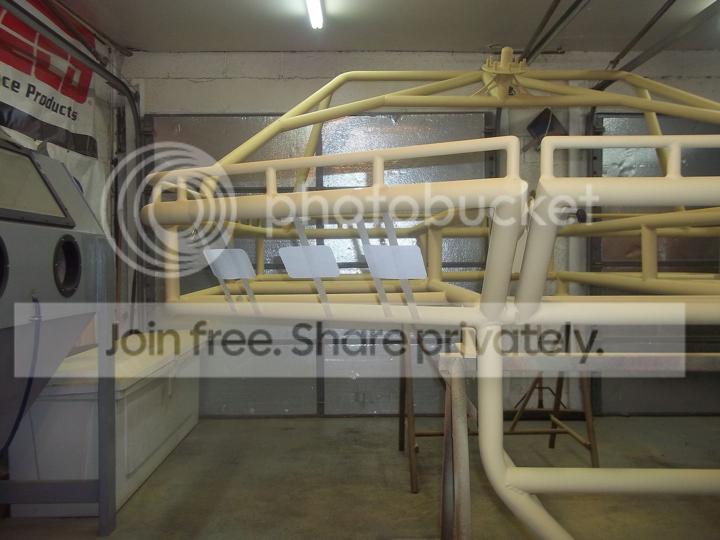

this is lense only sizing.. and spacing could obviously be changed a bit...
rectangle grommet style..
these would prolly be shifted to the right a tad...

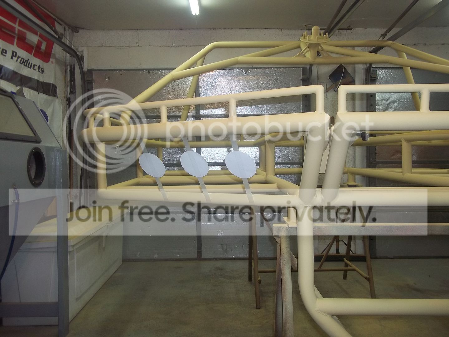

the only size I found for round was 4"... well, they have 7"s for bus's, but that's too big...
they would be inset an inch or so from that.. just easy to tape it there....
opinions? :ears:
Hmm - of the three, I think I like the square ones best - so hard to visualize!
