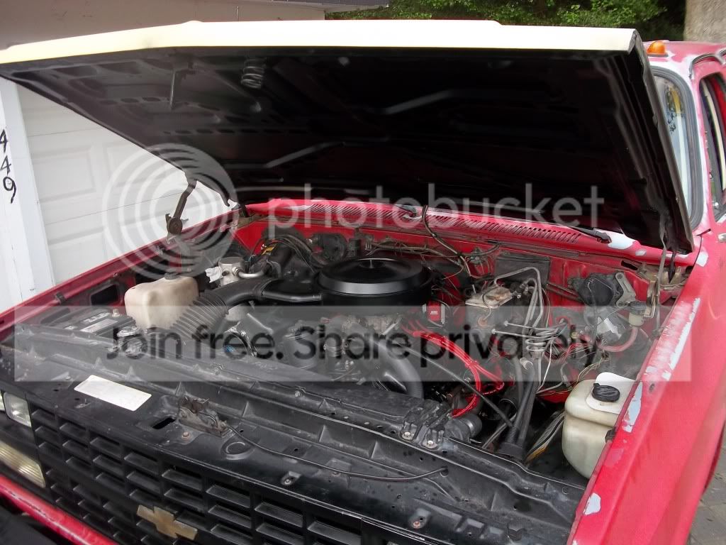

bad rocker nut on #4 intake, thus the clatter... much better now...
this weekend's agenda plug wires, tach and volt gauge... ummmmm, some other stuff too.....
You are the man. Sounds like it's getting better every time you work on it.:thumb:
thanks, yeah, I'm plodding thru her.. definitely still has a few issues, but she's becoming a healthier DD'er every day... I stiil may do a top end on this mill in the fall..... I'll see how long it takes me to buy the tube bed stuff.... :doah:

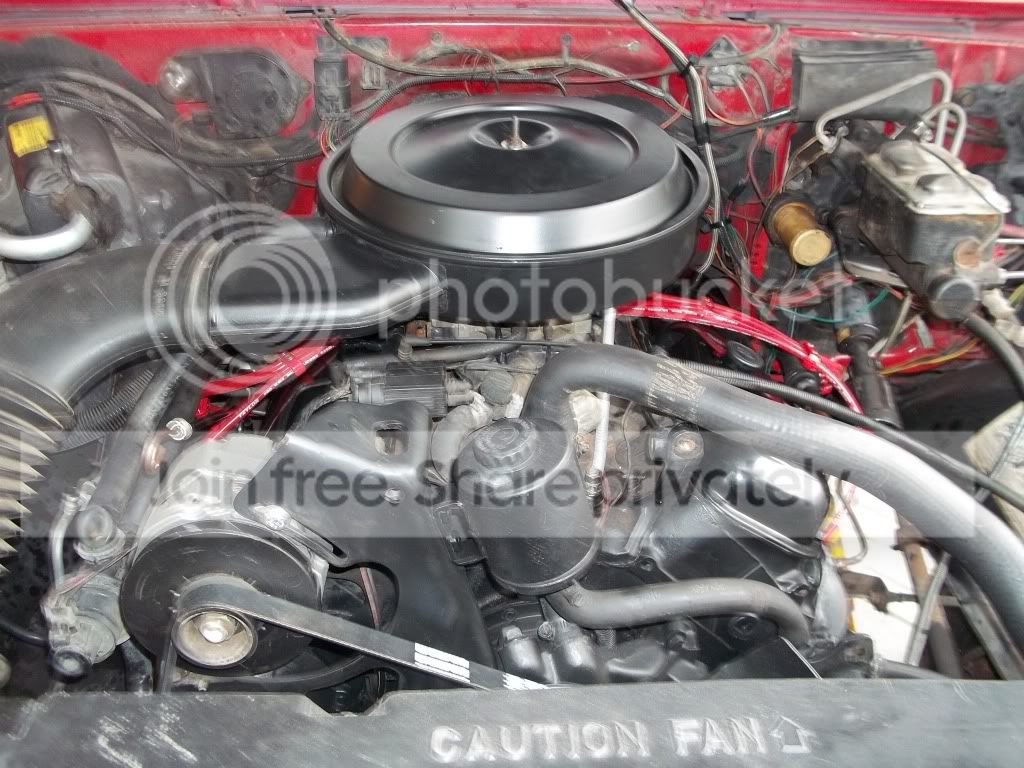

sorry, I didn't get a lot of pics doing the plug wires... camera batteries dead...
just when I had the one side set up prior to cutting.... it just cut, strip, crimp done...
and one of it done..... 8mm Taylor's with 45 boots for the record....
I went for somewhat orderly street driver as opposed to anal f*cktard showcar neat.... :haha: boy, that pics a bit blurry.... :doah:
tank ya sir.... :D

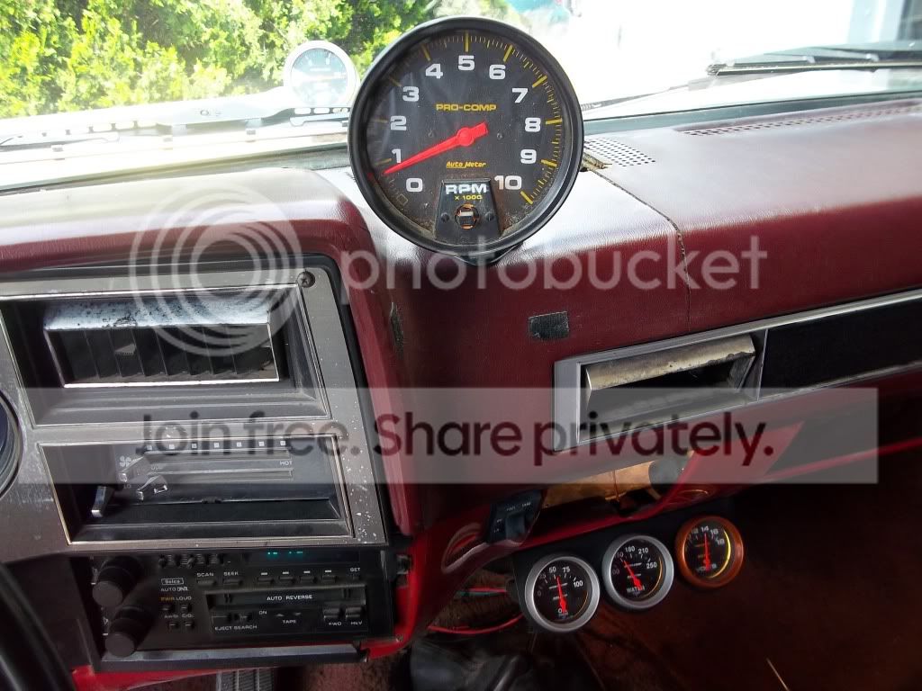

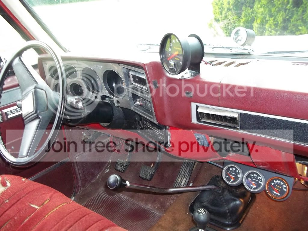

put the same fuel fill on the pass side as the ds... got the tach bracket made, tomorrow I'll install some gauges... than I'll probably work on stripping the good doors and fender I have...

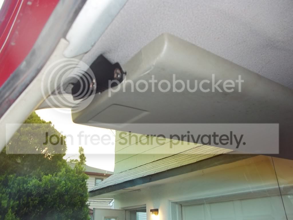

oh, and one I've been meaning to mention/post.. a semi-interesting visory overhead console thingy.. I've never seen one, I think... haven't used it yet, not sure I even like it....
You don't like this shelf?
I had one in my van, it's really handy.
tank ya sir.... :D
not sure yet.... :popcorn: haven't tried stuffing anything up there yet.... :dunno:
doesn't seem like it'd be good for anything small...
it was the old one from the K5 that I planned on replacing... it'll do for now.... feel naked without a tach and a manual.. :haha:

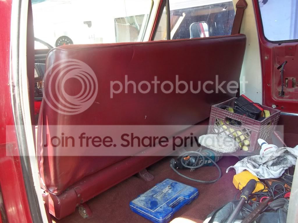

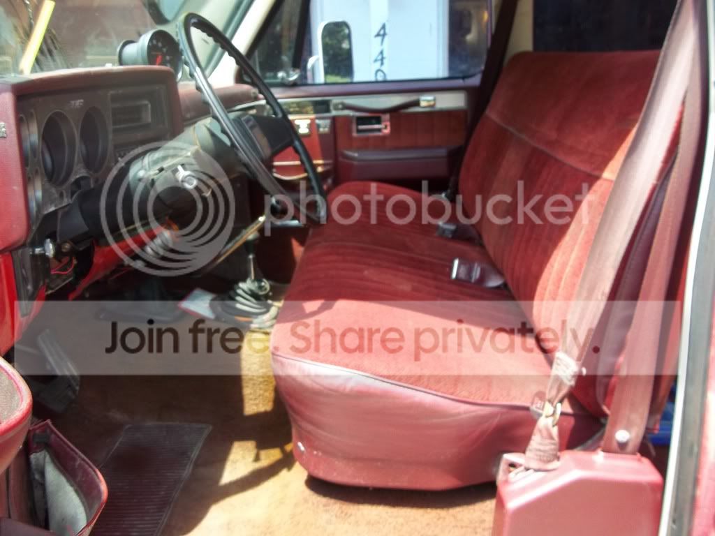

so, yes, I swapped the back seat to the front... so much cleaner and firmer...
the only difference is the back has the flip forward seat, whereas the front is fixed.. you could swap backs if one wanted.. I didn't bother...
Where'd you get those wire looms? Very clean looking, I want a set :waytogo:
BTW I like the ginormous tach, where's the obnoxious shift light to go with it? :whistle:
BTW your shock bushings look TOASTED...
Also all standard cab benches flip foward so I wouldn't be concerned about using the rear bench.
they're Taylor's cheap clamp style ones http://www.summitracing.com/parts/TAY-42720
I've owned that tach for 25 yrs.. no sh*t...
that's what I was figuring too... :D
