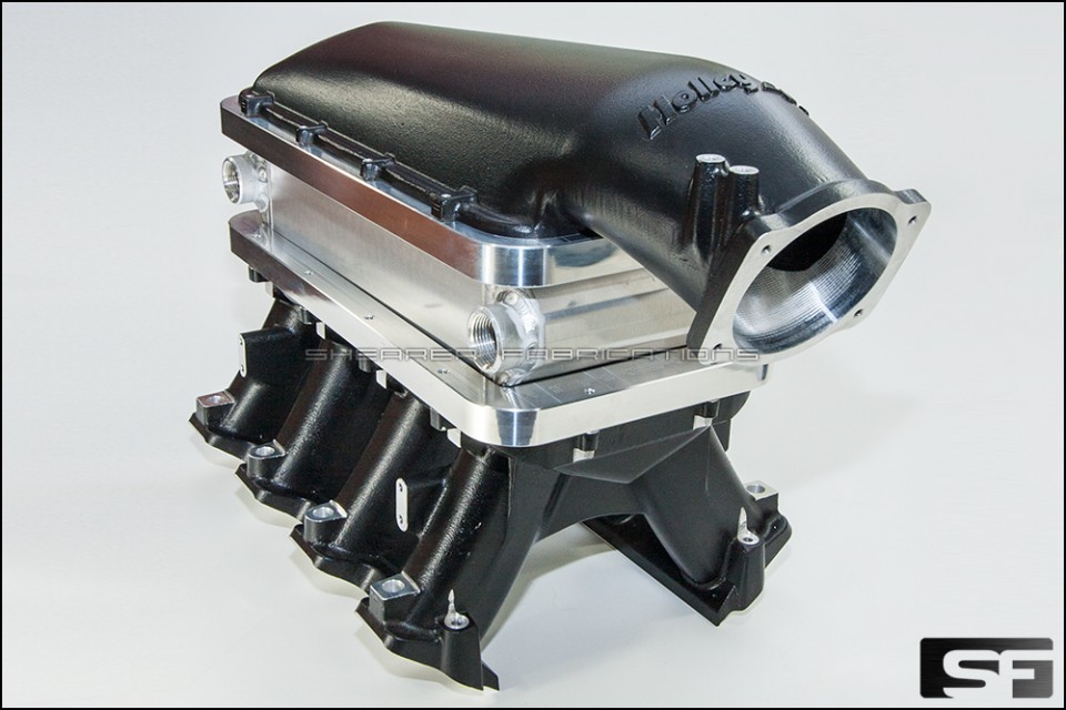

So on another note I started to get an idea of fitting the turbo. It looks like my ram air box is just too big to hook into the turbo so Im going to delete it and basically do the turbo forward facing in that area. Ive got big plans for this thing this winter including a cage, change in dashboard and gauges, rewire, replumb, and obviously turbo. I have all the rollcage tube already and obviously am starting to accumulated turbo parts. My biggest expense will be the shearer intercooler for the hi-ram. Im hoping that selling the trick flow heads will pay for this...
Its really the only spendy thing Im getting. The turbo was a good deal at $600 from my buddy for a $1200 t4 s475. Im going to vband some stock manifolds, Ive got a lot of the tubing. Ill be running VS racing wastegates and probably blow off valve. Fuel is simple I already set this cell up for dual pumps so Im just going to throw another walbro 255 in there on a pressure referenced switch with a check valve and I should be good for a 1000hp at the flywheel which is basically my goal.
