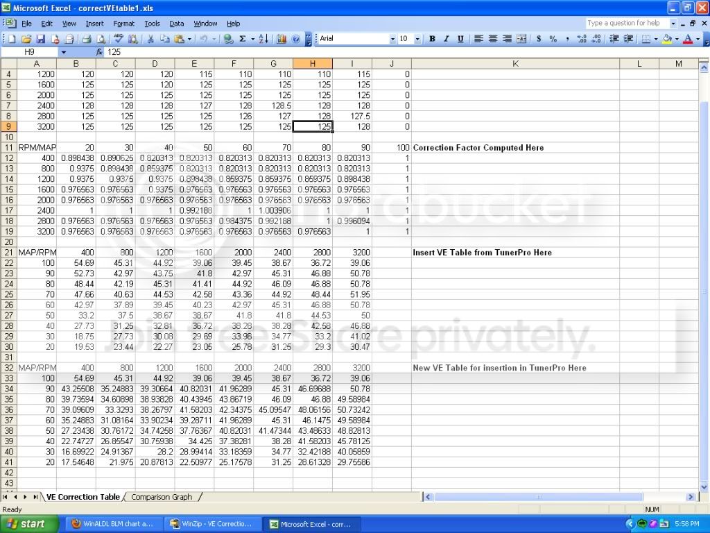

The Excel spreadsheet is math programmable. Someone spent a fair amount of time to figure out the math. I high lighted one of the formulas.
dave w
It's actually not complicated. You are going for 128. If the BLMs are bigger, you want to increase VE. Multiply each entry by (BLM/128). The cell you highlighted has an exception in there to ignore BLM entries that are zero because that means no data was logged there.

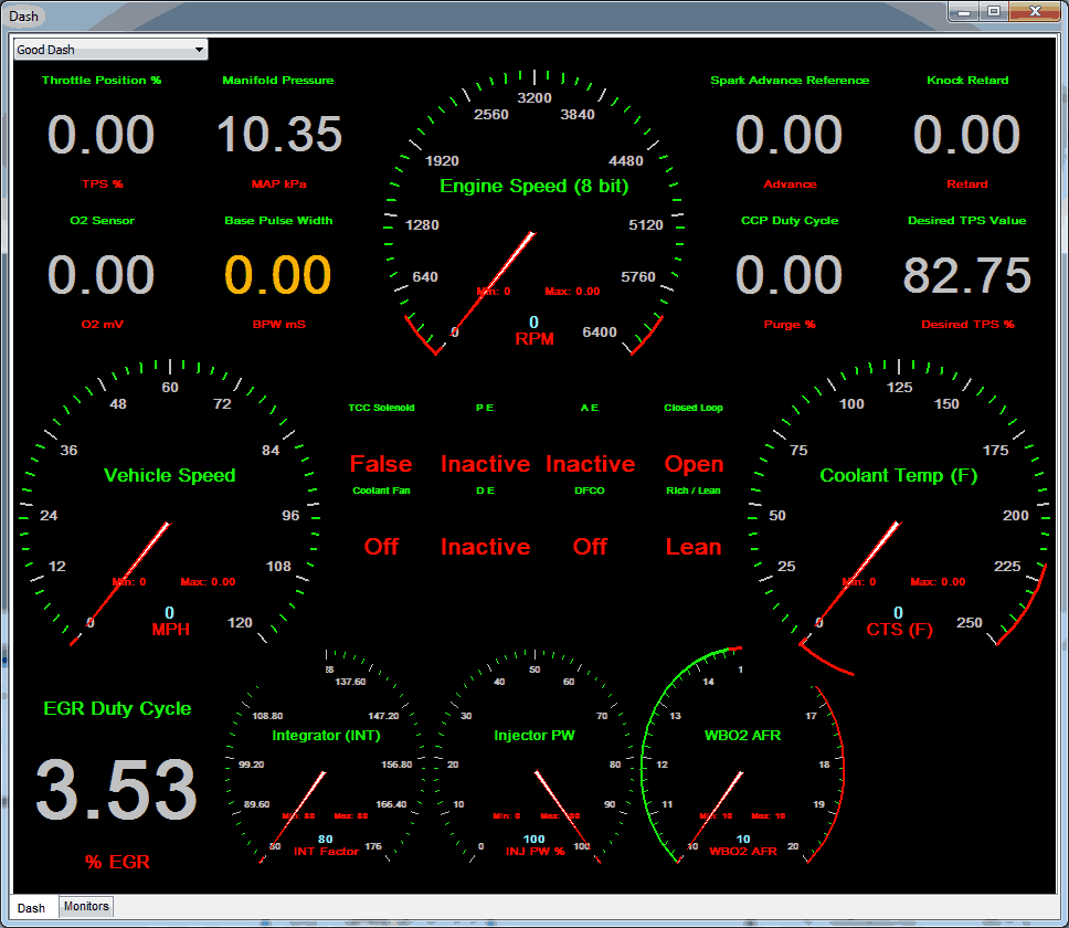

Has anyone gotten the dash feature of TunerPro RT working? I saw this on the web site, but mine just comes up blank white. The DynamicEFI one is on the bottom. Looks good too.

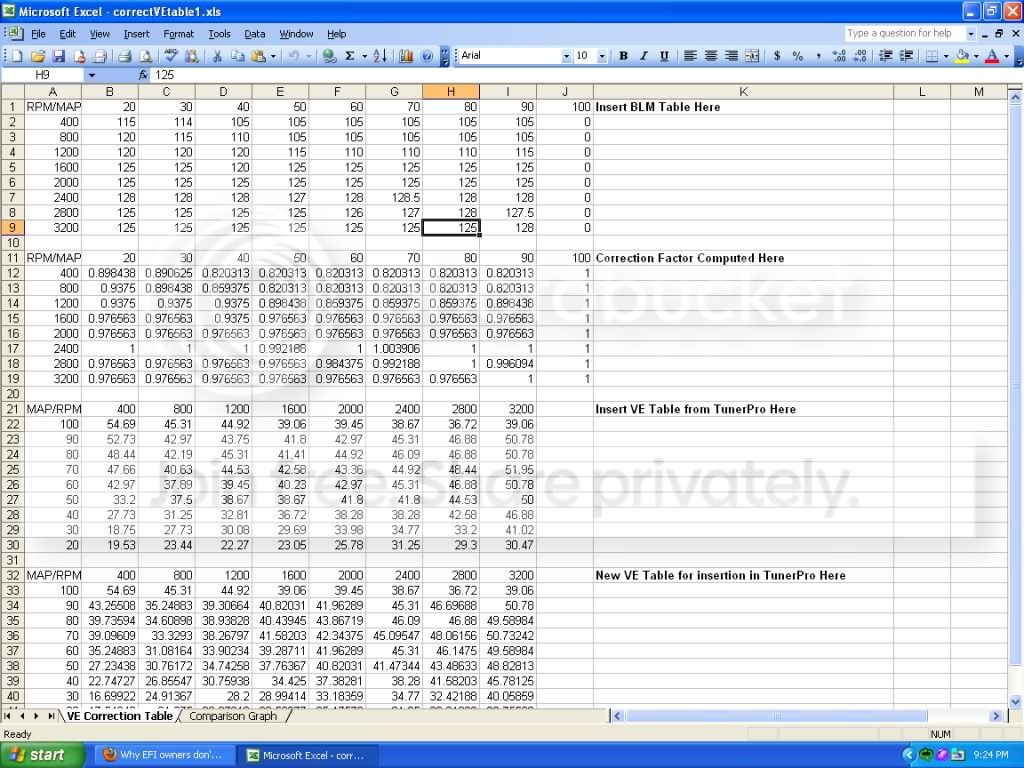

Damn It! The VE tables don't match between Turner Pro and Excel. Sorry for the confusion.
dave w
dave w
Corrected Excel File. Now the Excel file matches the TunerPro file.
