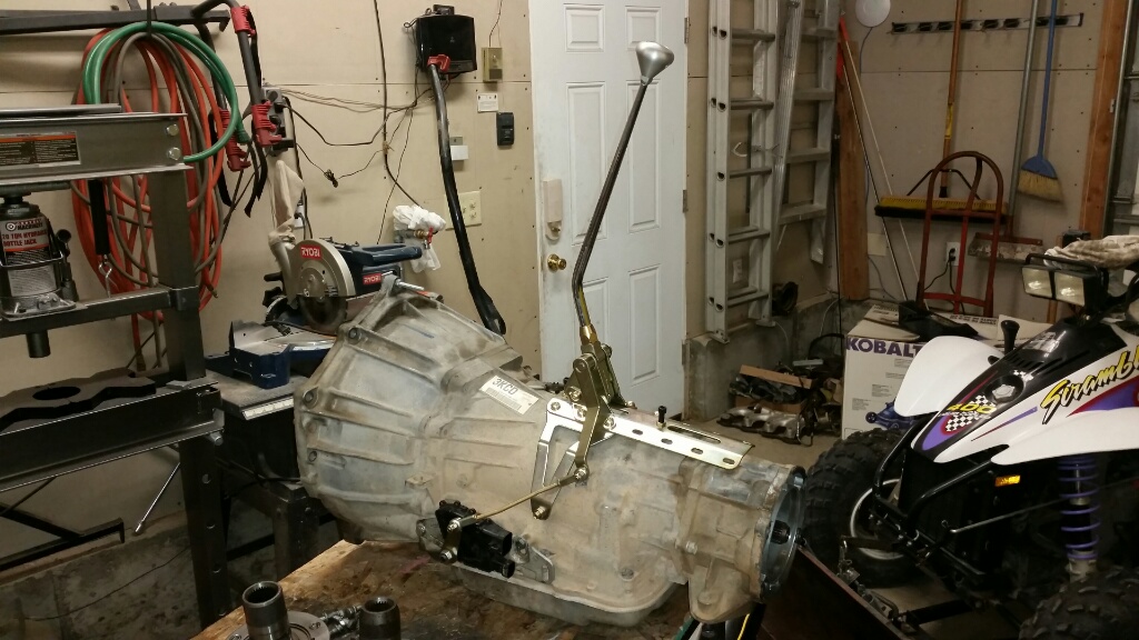

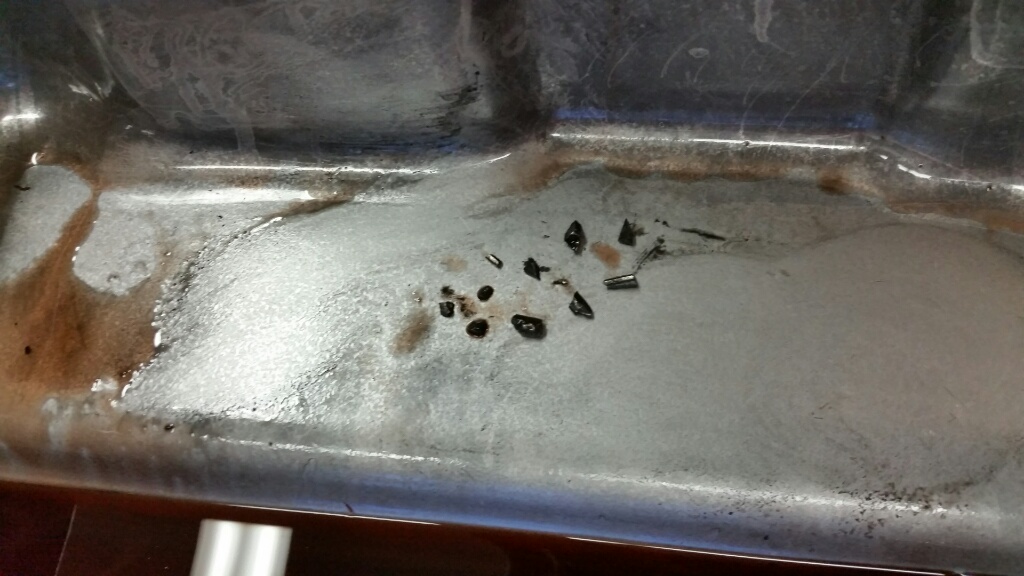

Transmission is here.
What would you do as far as fix ups? Replace the filter? More?
I forgot to ask for the dipstick so I'll have to try to get that tomorrow. Also, I know my wiring harness included a neutral safety switch but I'm not sure I still have it. Can/should I run without it? I'm also going to ask for the cooler lines. I probably can't use the whole line but at least I can get the right fittings for the transmission side. I *think* that my radiator is set up for transmission lines... gotta check on that.
This weekend I'm going to hit the junkyard and see if I can round up a brake pedal from an automatic. Also going to order that lokar shifter I think.
You don't *have* to run a neutral safety switch, but I would. Not so much for your sake, but for any other moron that tries to start the rig without it being in neutral...think alignment shops, etc. While you can use the cooler inside the radiator, I'd recommend running a separate cooler in front of the radiator. It'll help keep your transmission happier, longer

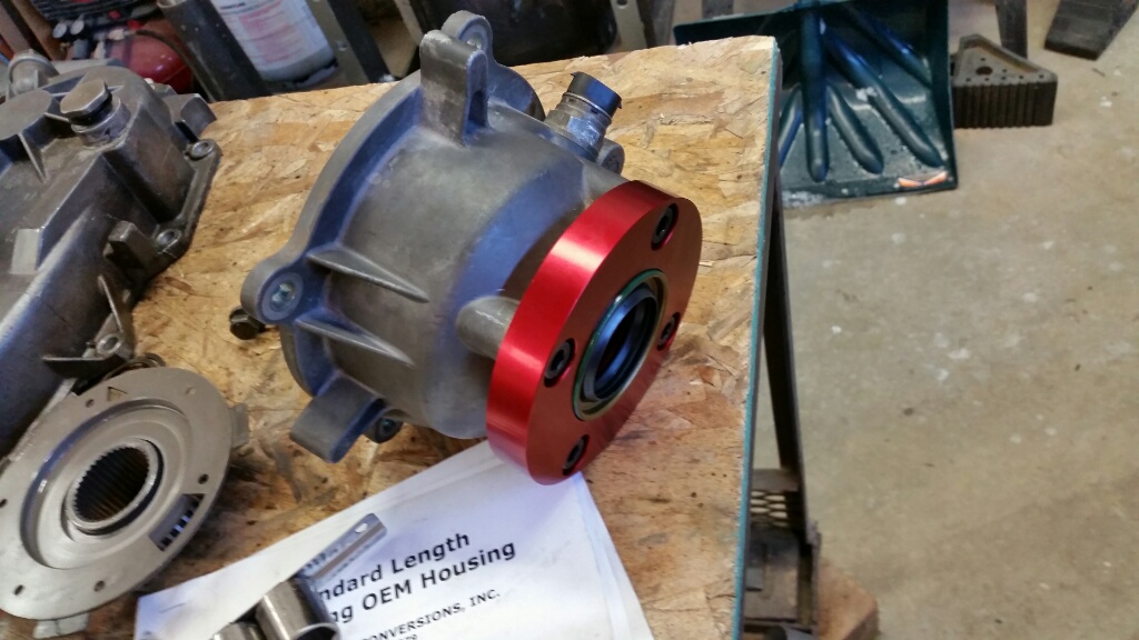

I'll still have to replace the rear though because I am rebuilding the transfer case with a SYE kit.
Good choice.

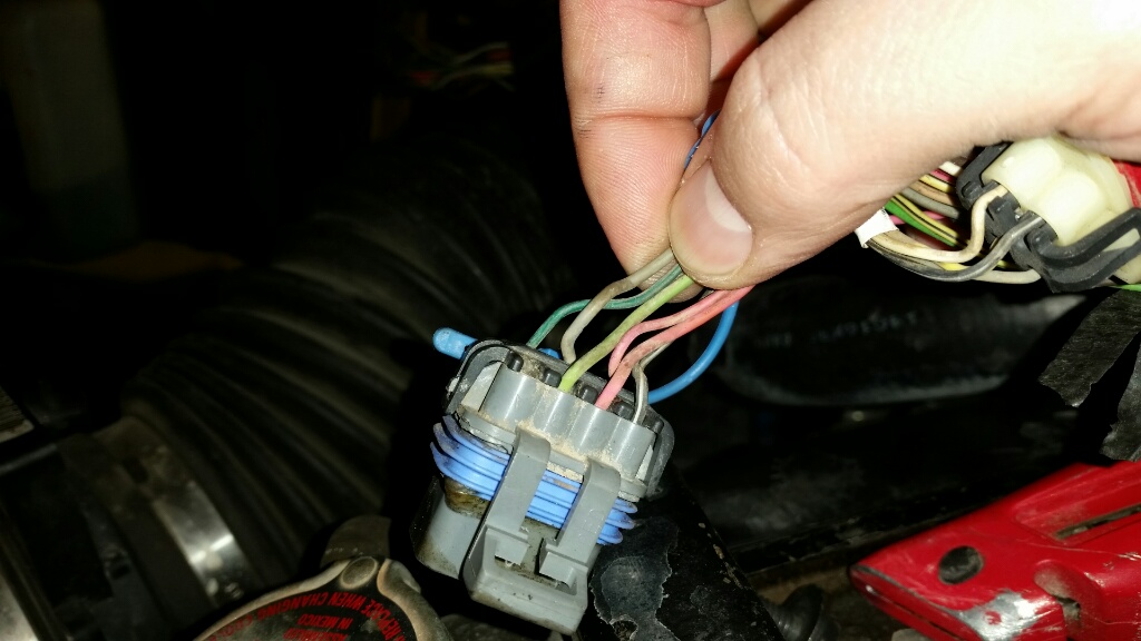

I'm pretty sure I can add it back in without too much hassle if it comes to that but it's still a bummer. If I have to go to all that trouble, I'll probably go the extra step and add a relay to the circuit so that I can add more lights later. I would love to have a lot more light when backing up.
