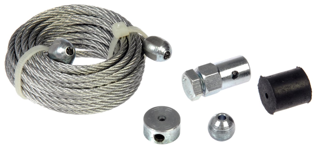

I'm going to try and reroute the emergency brake cable to just over the rear of the transfer case rather than behind it. In order to do that I'm going to have to shorten the holding rod pictured on the right. That shouldn't be a big deal to cut down and reweld. The attachment on the left is adjustable, so even easier. Of course doing all of that will mean that I need a longer cable.
I'm not sure where to get a custom length cable. Any ideas?
can you relocate the front mounting points closer to gather to gain enough slack? that would also get it from under the the cat.
I had inline tube make the cable that goes from the frame to the backing plate 3" longer to account for the lift.
I also rerouted my cable like you need to. Inlinetube did it for a reasonable price too. I also made a small plate that bolts on top of the transfer case to keep the cable from rubbing on the sharper edges of the xcase
hmmm, I'll have to keep that in mind. I hadn't really thought about it before.
Thanks for the inline tube suggestion too.
