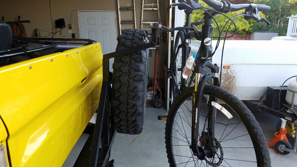

I'm actually working on the bike/tire carrier again after camping over the weekend. I'll have pics to post up soon. For now I'm just mounting the bikes horizontal, but vertical might work, just don't want them hanging too low.

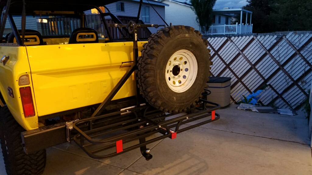

Back side. You can see that the bike rack needs to be modified to clear the tire. I'll add mounts back here for some accessories.
Shows the modified bike rack to get it out beyond the tire.
The idea is for it to be somewhat modular. I can put whatever accessories I want into the top tube, or into the receiver hitch as the need may arise. However, for the most part, the top will typically hold the bike rack and the receiver hitch will hold the luggage rack.

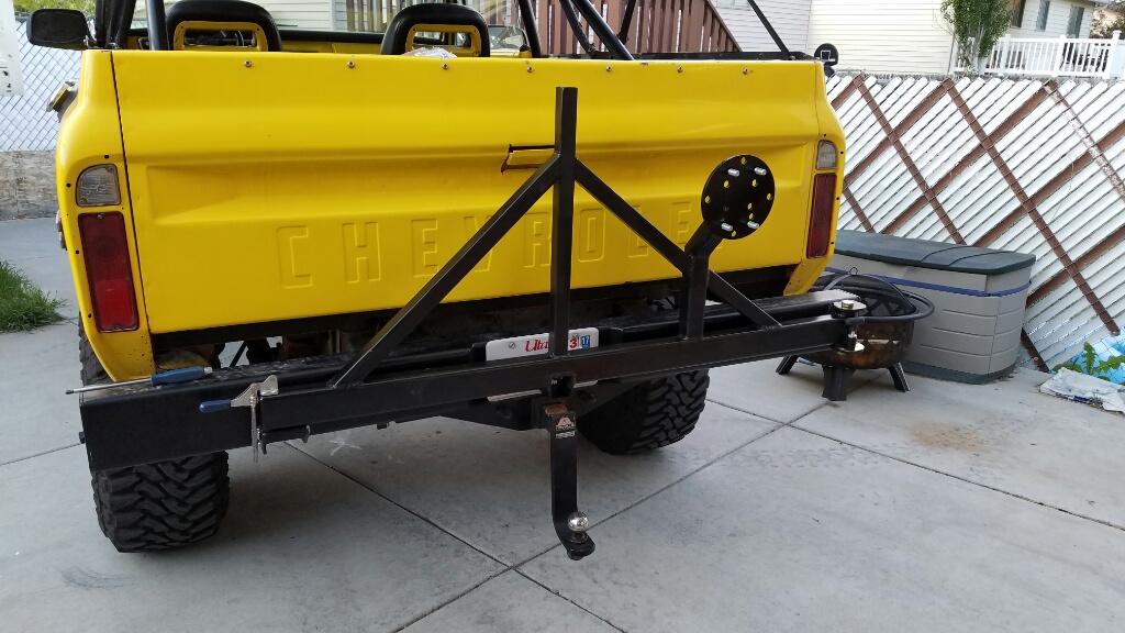

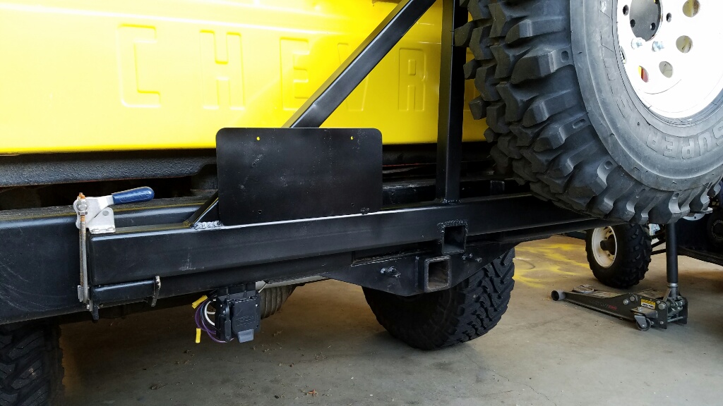

I added a license plate spot.

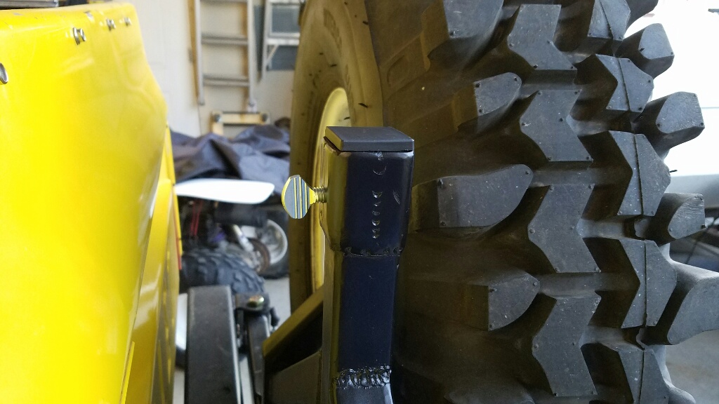

The "accessory hole" was starting to get banged up a bit already so I beefed it up a little. Also added a thumbscrew so that I can take out any slop in the fit. I found some square hole plugs for cheap on amazon so I put a cap on it for when I don't have anything I want up there.

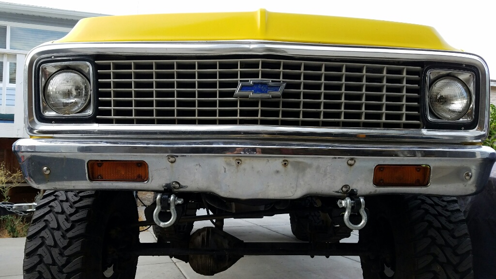

Knocked another thing off the list this weekend in preparation for BB16, front recovery points.
Not terribly complicated, so not a ton of pics, but here goes:

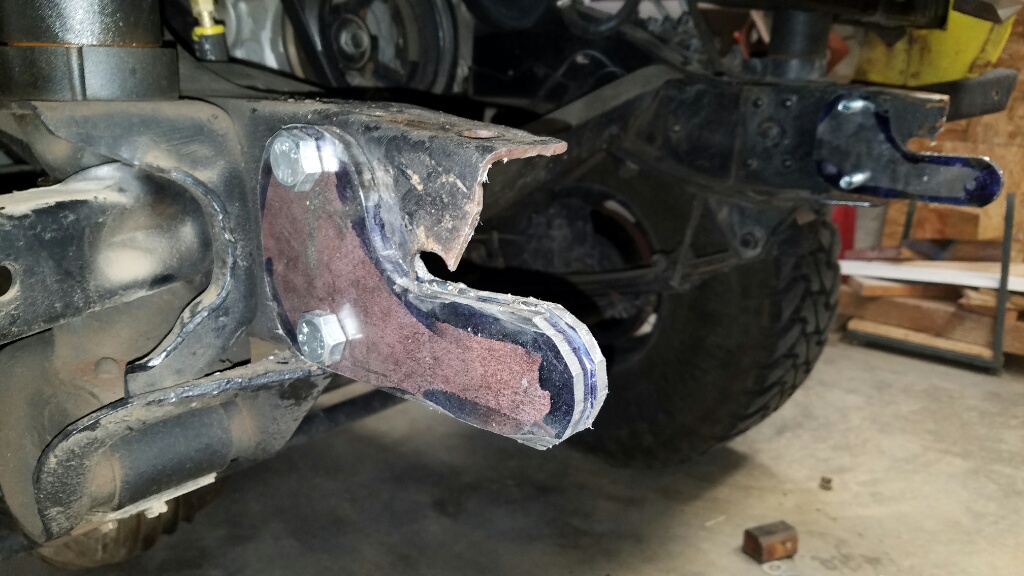

Rough cut and mocking them up in place.
A better shot showing the pieces sandwitched together.
All done and painted up.

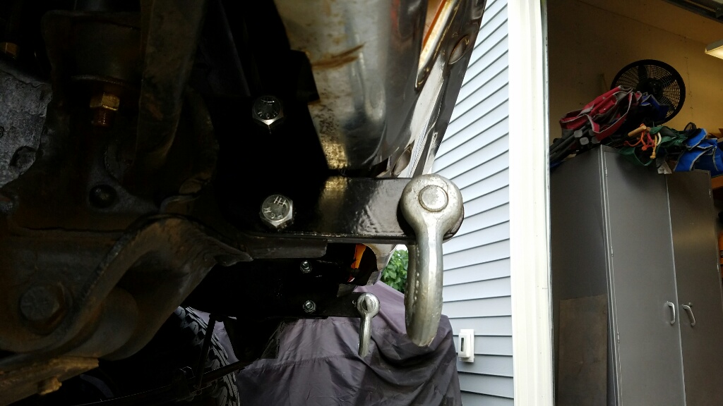

It's hard to see, but The frame had a couple of 5/8" holes already, so I used those to mount it up. I have a body lift so the bumper was already mounted a little higher on the frame so I just had to notch it out a bit to fit the recovery points under it. The D-ring pin itself is 7/8" so should be plenty to pull me up and over whatever I get stuck on in Moab.

Are those bolts what grade 5 looks like in your area? I almost thought they were metric but then I thought, nah!
Yeah, grade 5. I was looking for grade 8 but they didn't have any in 5/8 and I figured that was overkill anyway.
Remember my buddy Nick at the Blazer Bash in 2013? The Sledgehammer. He busted the grade 8 bolts holding his bumper on when he tried to cross the Golden Crack like a dummy. Still amazes me he did it.
That being said, I wouldn't worry about it. I think his problem was compounded by something else going on. Like maybe even he thought he had grade 8 and didn't. :dunno:

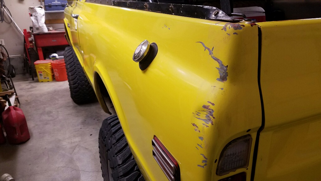

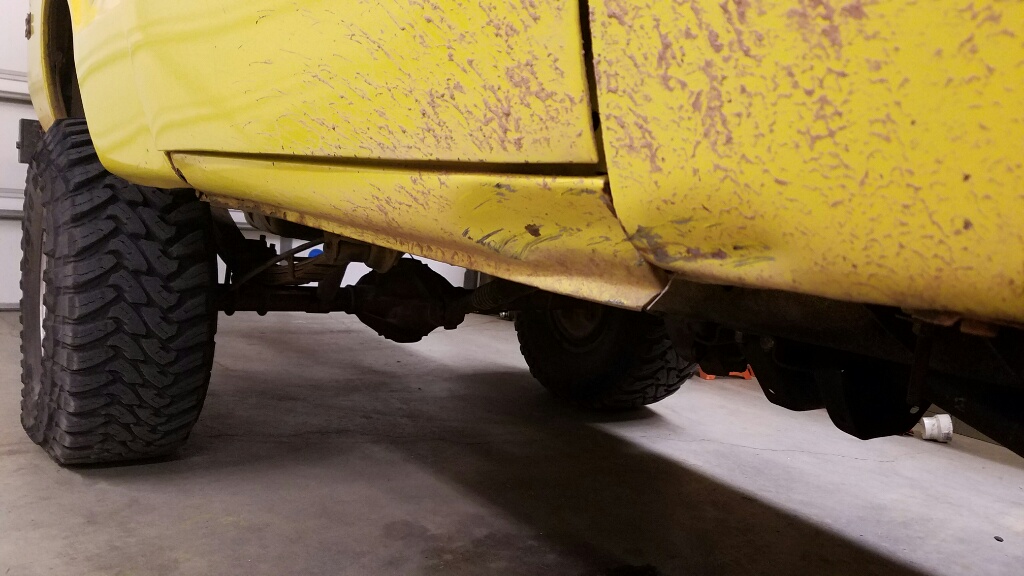

lost focus and dropped onto the rocker on cliffhanger. Totally avoidable, just a screwup on my part. :(

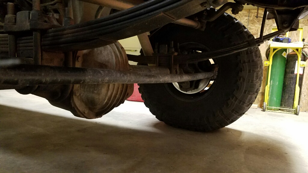

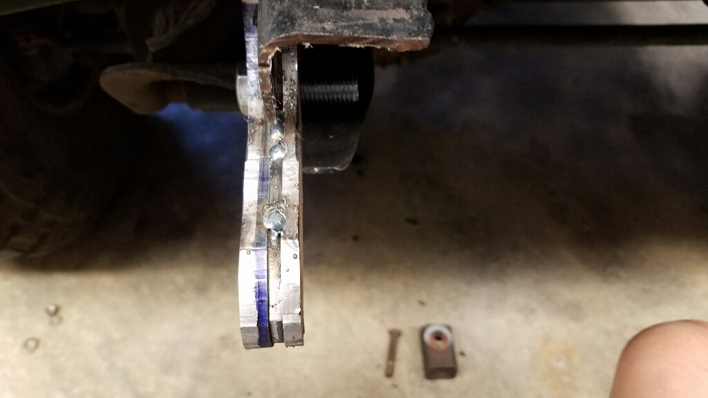

Bent the tierod somewhere on cliffhanger. It's not horrible, so I think I can get the tires straight with tierod end adjustment.

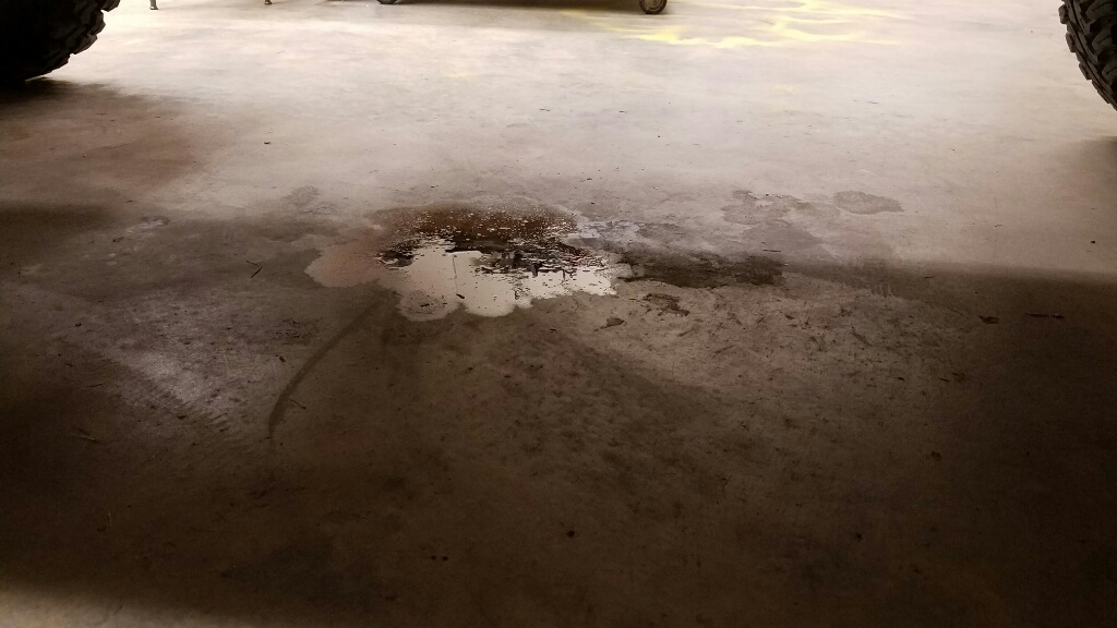

The transfer case is spitting a bit of fluid out the breather. It's been doing that a bit for awhile, but it appears to be worse. I let @Babaganoosh near the blazer so it's probably the tranny leaking into the transfer case. :)

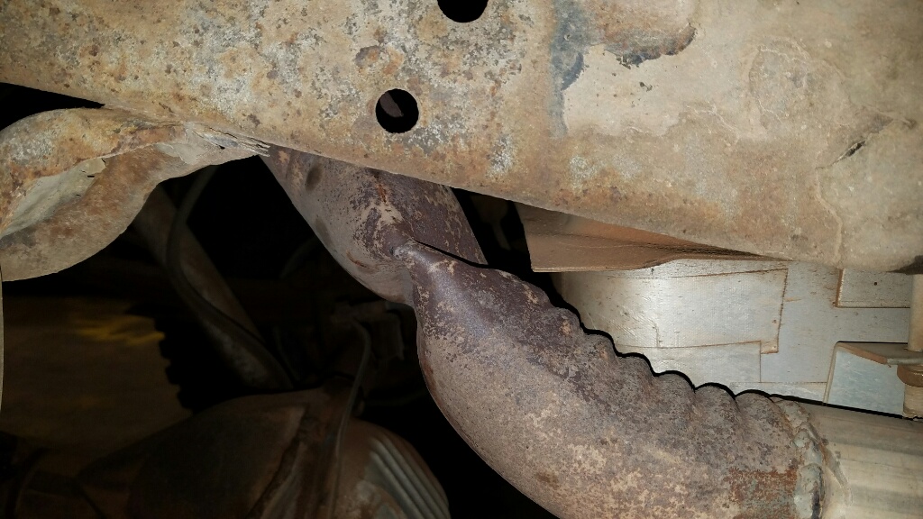

I managed to bend my exhaust around my rear axle. I got it pulled back out, but got a nice sized kink that I have to fix.

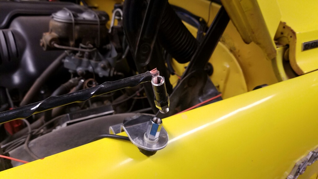

Broke my cb antenna on a low hanging tree. :doah: Time to upgrade to a flexible antenna I guess.
