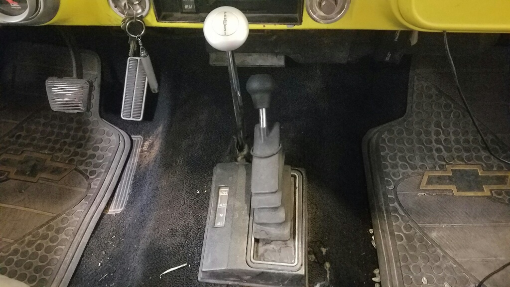

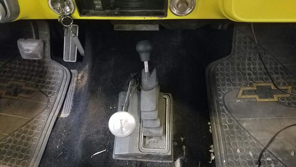

@ashman Do you have a pic of your shifters? Wondering how Lokar and 241 shifter spacing turned out on the trans tunnel, thanks!

Sorry, I spaced this off until today. Here is some pics from inside:
In park
In 1st gear
As you can see, I never got around to putting a boot on the lokar shifter.
It has very little throw at the floor level, so it doesn't need much room around it.
Thanks! I have a floor mount Lokar but was wondering how much room you had.
