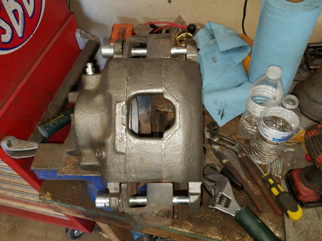

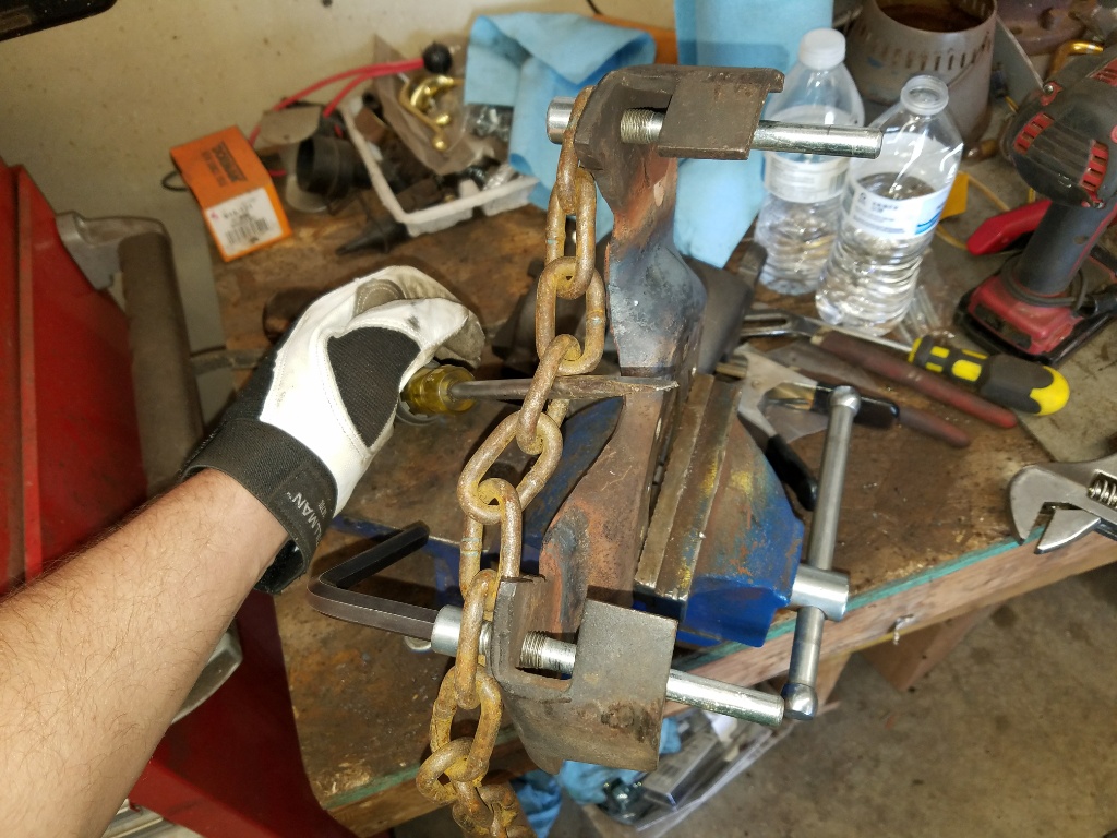

So, I got the caliper bracket worked out. I was able to bend the old one back into shape.
When the bolt broke, it bent the bracket in a way that made the opening for the caliper about 1/2" too wide. It took me awhile to come up with a plan to pull it back together, but with some heat and a chain I was able to get it right.
Twisting the chain with the screwdriver worked like a charm to pull the 2 sides together. The final fit turned out pretty good.
