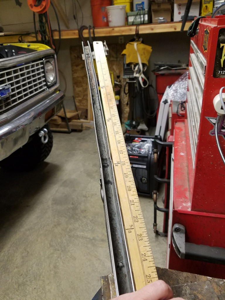

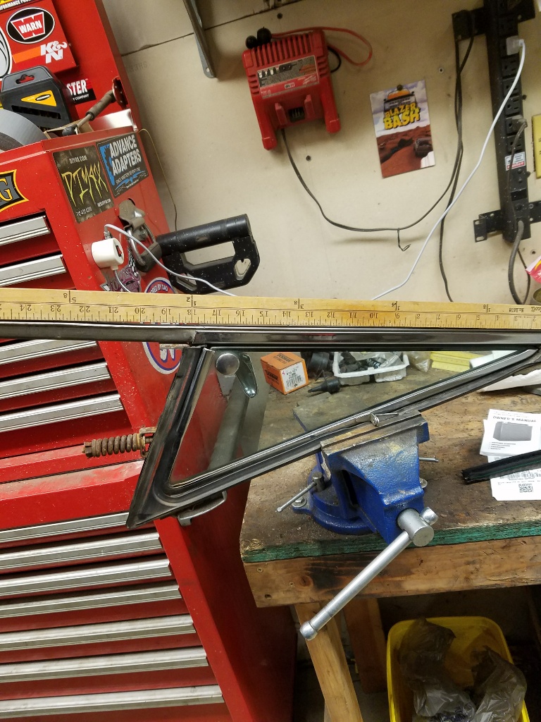

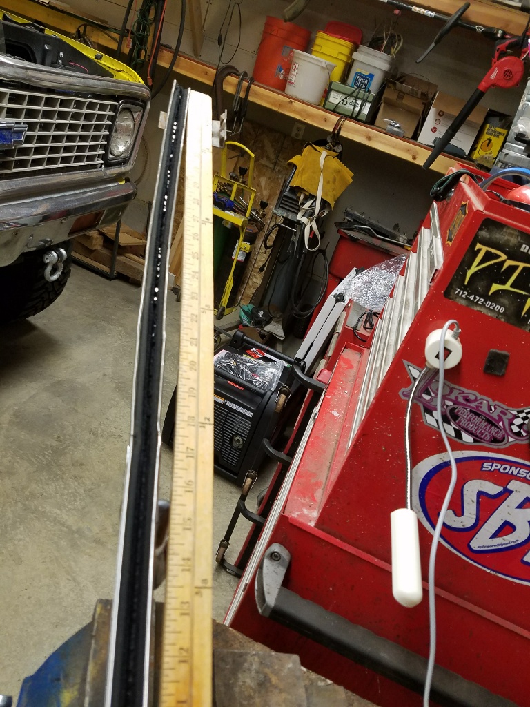

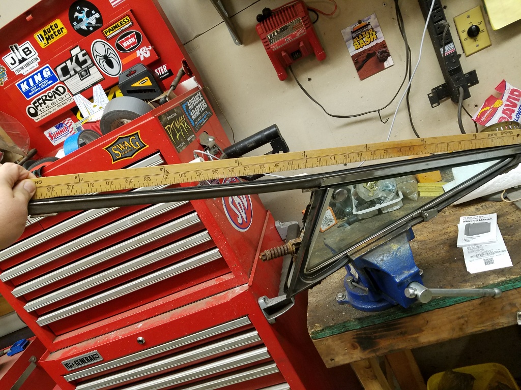

Last year I rebuilt both doors to get rid of all the rattling. That went fantastic and they are way better, but I didn't really know how to disassemble everything the first time and I managed to bend the passenger side vent window piece making the window extremely hard to roll up/down. I looked into just replacing it, but it turns out a new one would be ~$200! Way too much right now, so I decided to pull it apart and see if I could do a better job of bending it back to reasonably straight.
Before:
After:
After putting it all back together window operation is much improved. It's still a little tough to roll, but at least it can be done with 1 hand now and doesn't feel like you are going to break the handle off. I think most of the resistance at this point is that when it was bent the window chewed up the felt piece trying to push through the bent vent side runner. At some point I'll have to replace that felt piece again, and keep my eyes open for a replacement vent piece, but it works for now.
