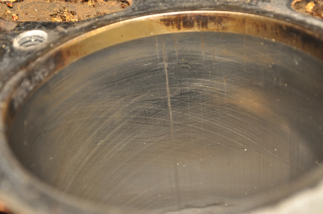

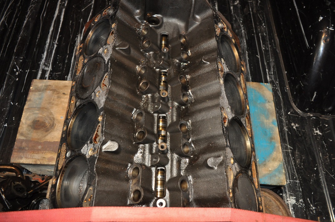

I was able to get the heads off the 454 Vortec so I can get them to the shop for some valve work and new springs. As I was checking out the cylinders for wear and tear.........I found a nice vertical scratch in #4. It's deep enough to catch my fingernail on but not enough to stop it. Hopefully that's a good sign but having it repaired will put my mind at ease knowing there will be good compression in all cylinders.
full
All the cylinders had good cross-hatching still visible, with no lip at the top of the wall.
So I am going to have the shop take care of the scratch, which may include a good honing, or if the scratch is too deep then all cylinders will be bored and new pistons installed. It has been a very long process of getting this engine apart because of being out of town for work.
It's in the wife's truck ready to go to the shop. She will help take care of this since I'm working away from home.
full
I imagine a quick pass with a stone would make that mark go away.. I was told if it catches the fingernail it's prob around 30thou deep.

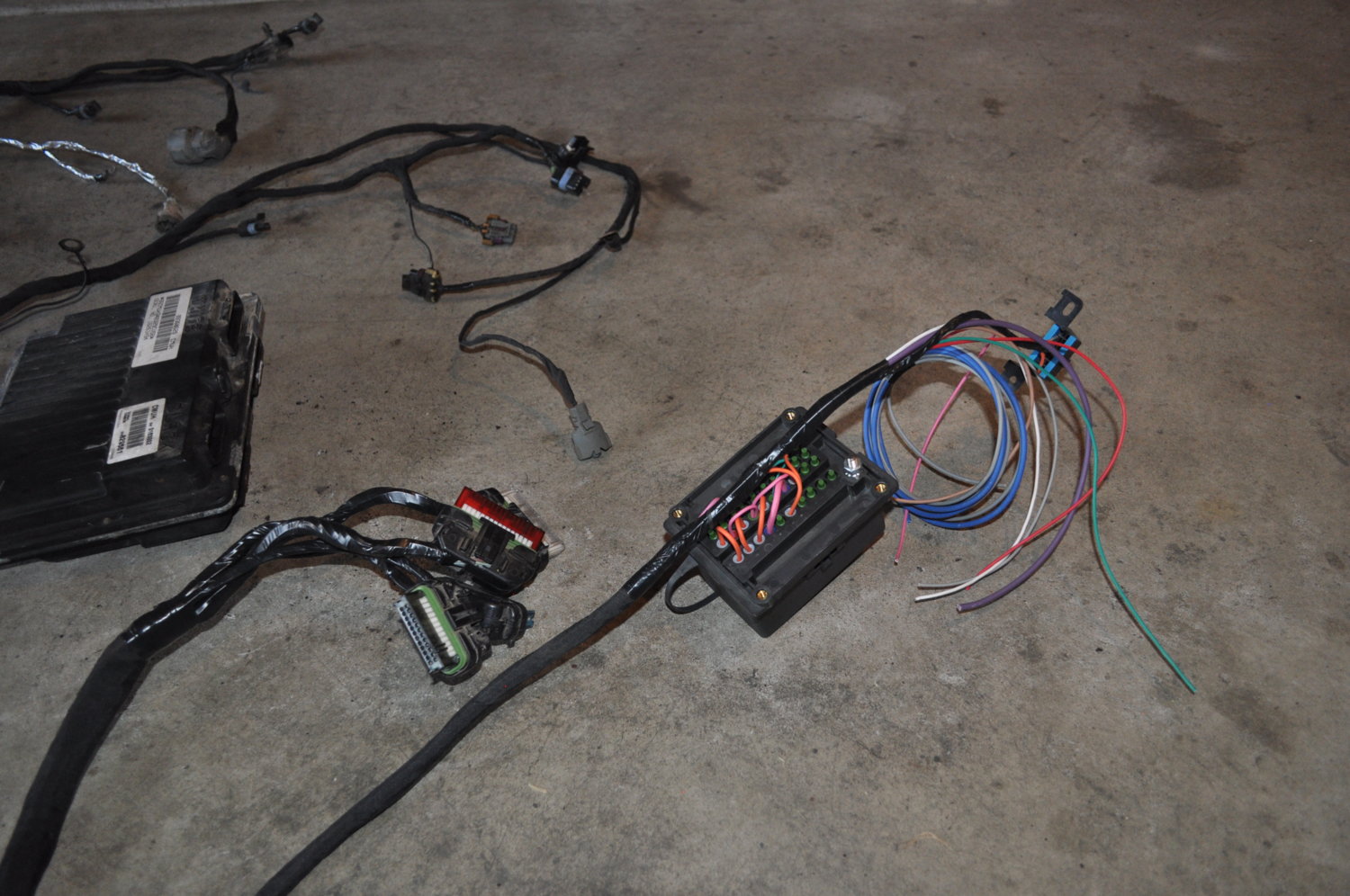

I'm going to ask @Team208Motorsports to check and rework the wiring harness and any chip modifications necessary for this rebuild as soon as they have the time. I know they are busy right now. So getting the right injector now would be beneficial.

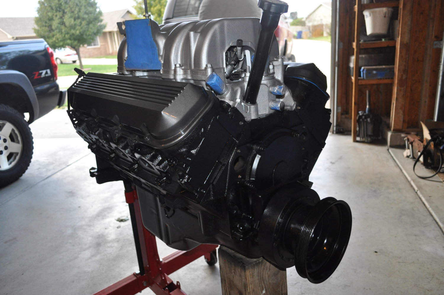

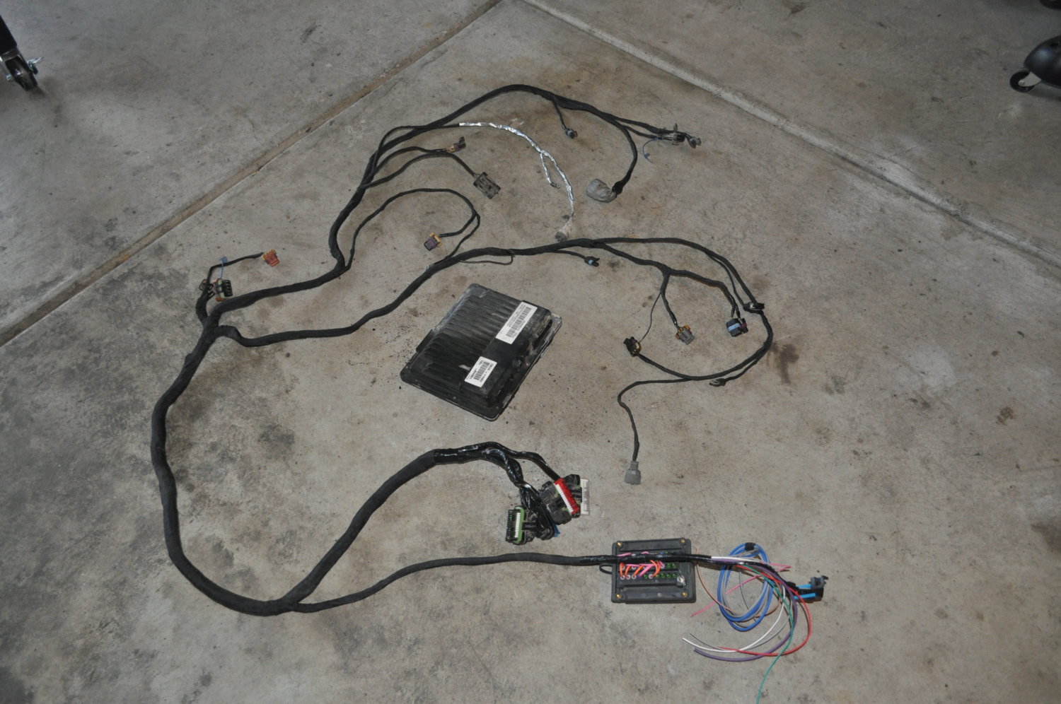

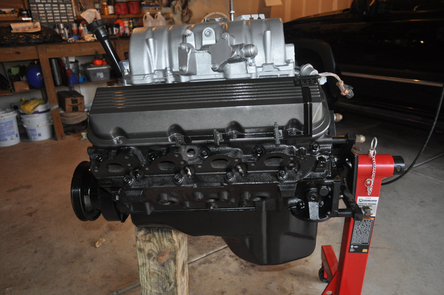

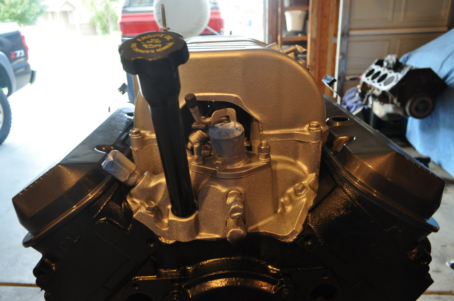

I do have the engine back from machine shop, Two M Motorsports and Machine. I have been slowly putting the top end together since I didn't have the shop do it. I wanted to replace the injectors plus the harness needed to be redone to help make it a plug and play when the swap takes place. Team208Motorsports did the harness.

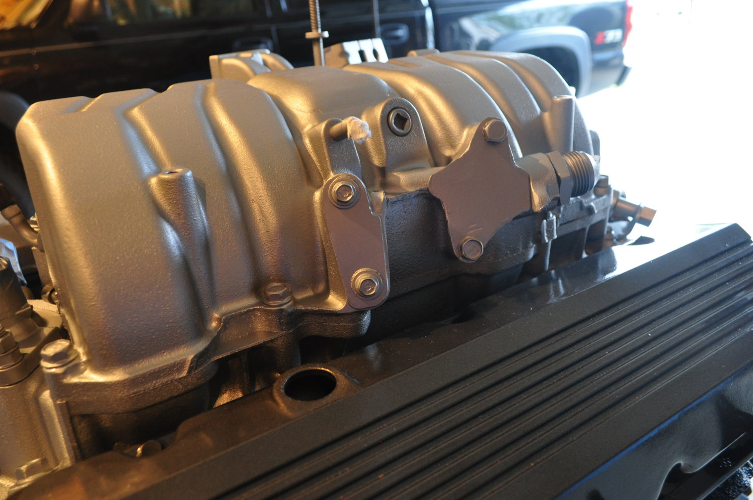

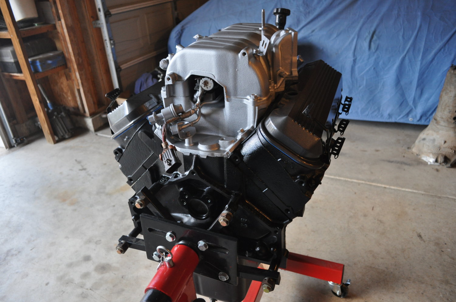

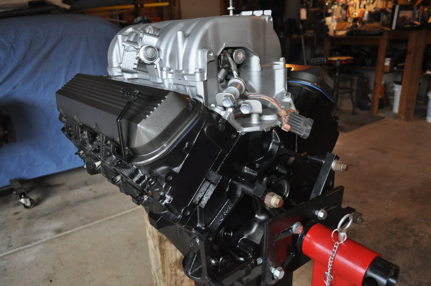

The machine shop installed an Erson Cam with valve lift of .516 and duration of intake at 264 and exhaust at 272. I installed a set of Denso fuel injectors that are 20#. Just a little more than stock. I have been busy with cleaning and painting engine parts and brackets but I haven't taken any pic of the process yet. I will do that this week and get them on here.
