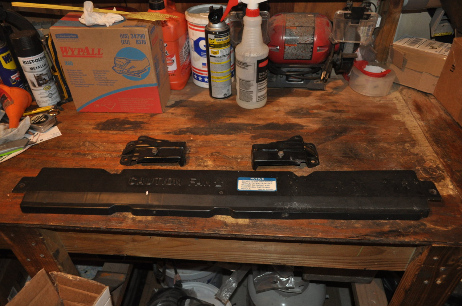

Hillbilly Wizard fan shroud brackets and top plate. They sell some very good used parts. The top plate looks almost new.

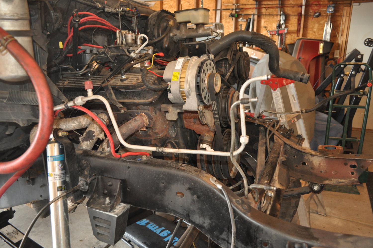

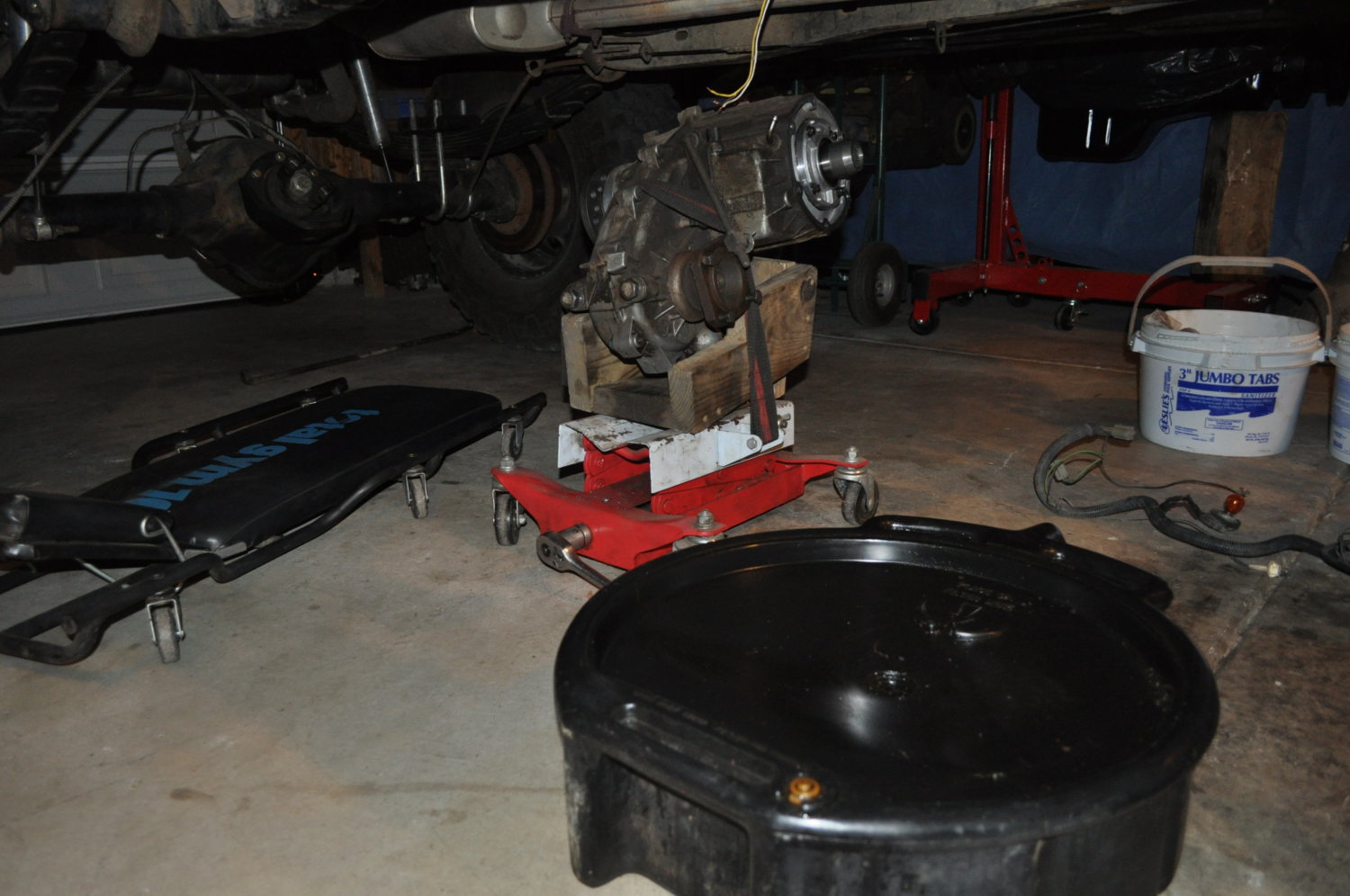

Getting ready to pull the 350/700r4
full
I really hated to sell that combo because it ran great and it taught me a lot about TBI. Well, actually, CK5 brothers/sisters taught me about the TBI, the motor was the hands on part. That combo is now going into a 1988 K20 that belongs to the new owner.

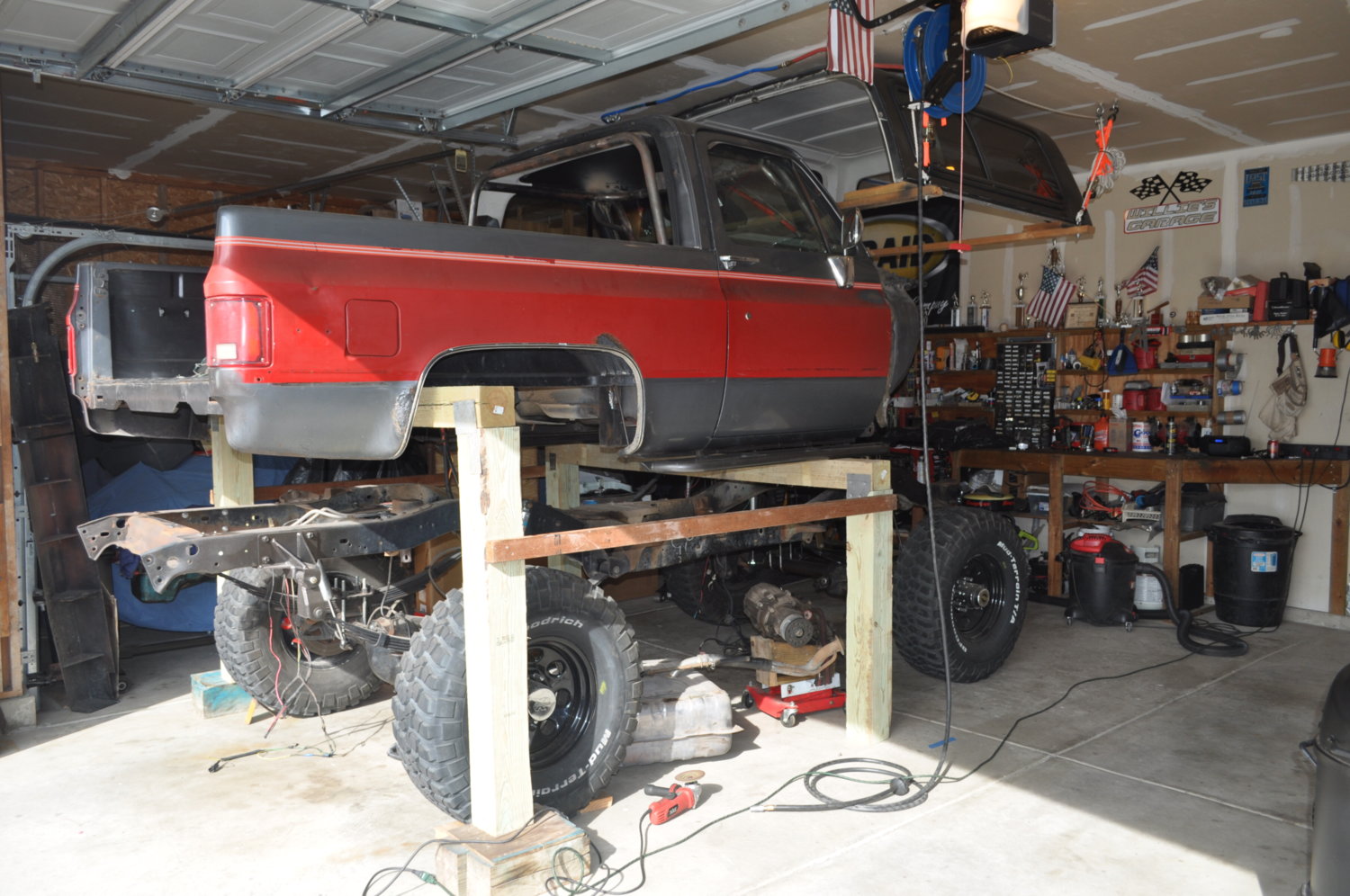

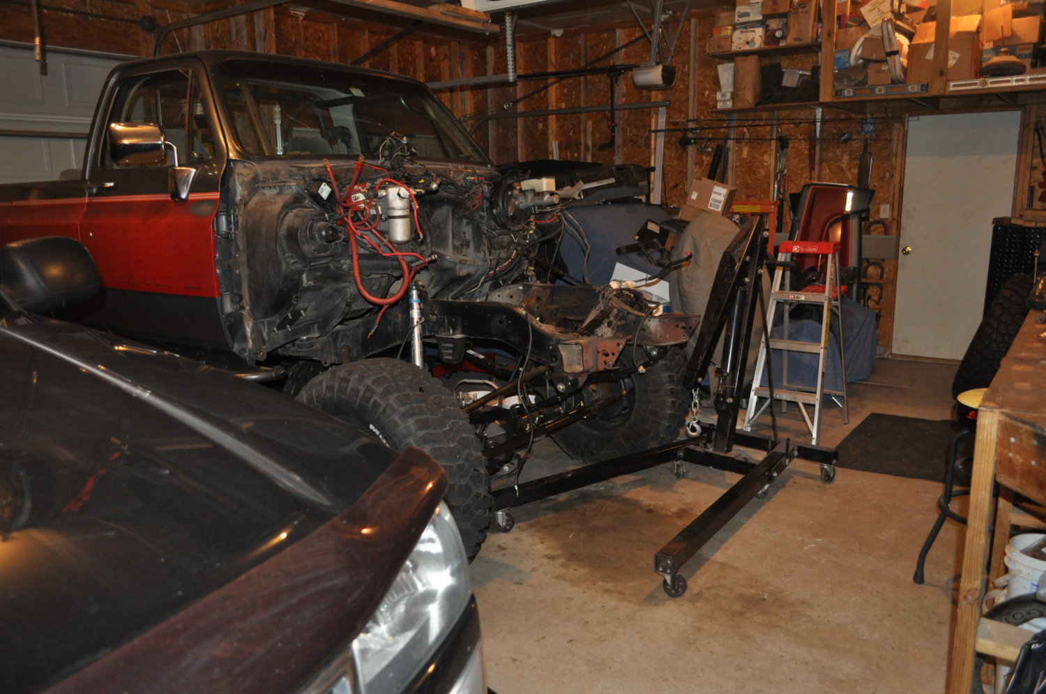

K5 looks naked without any motor and/or transmission. Top is also removed. This is the start of the Makeover that will begin within the next couple of weeks.

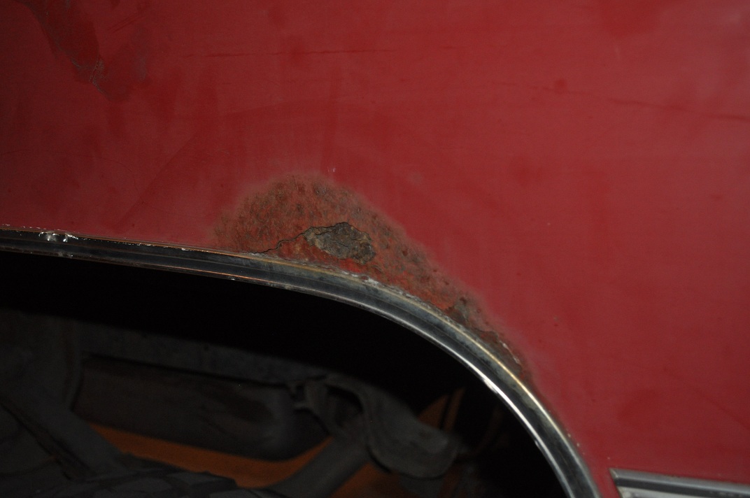

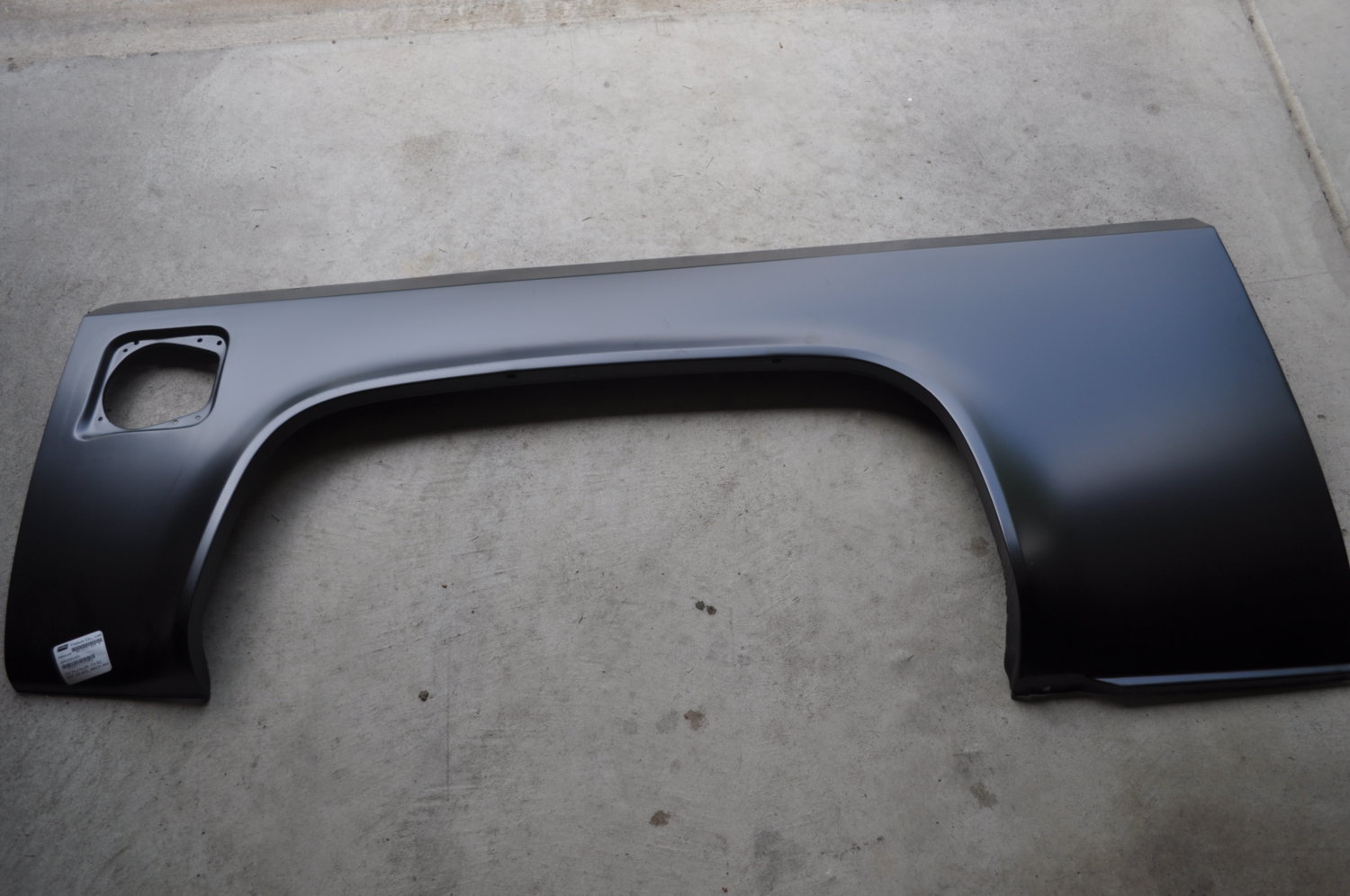

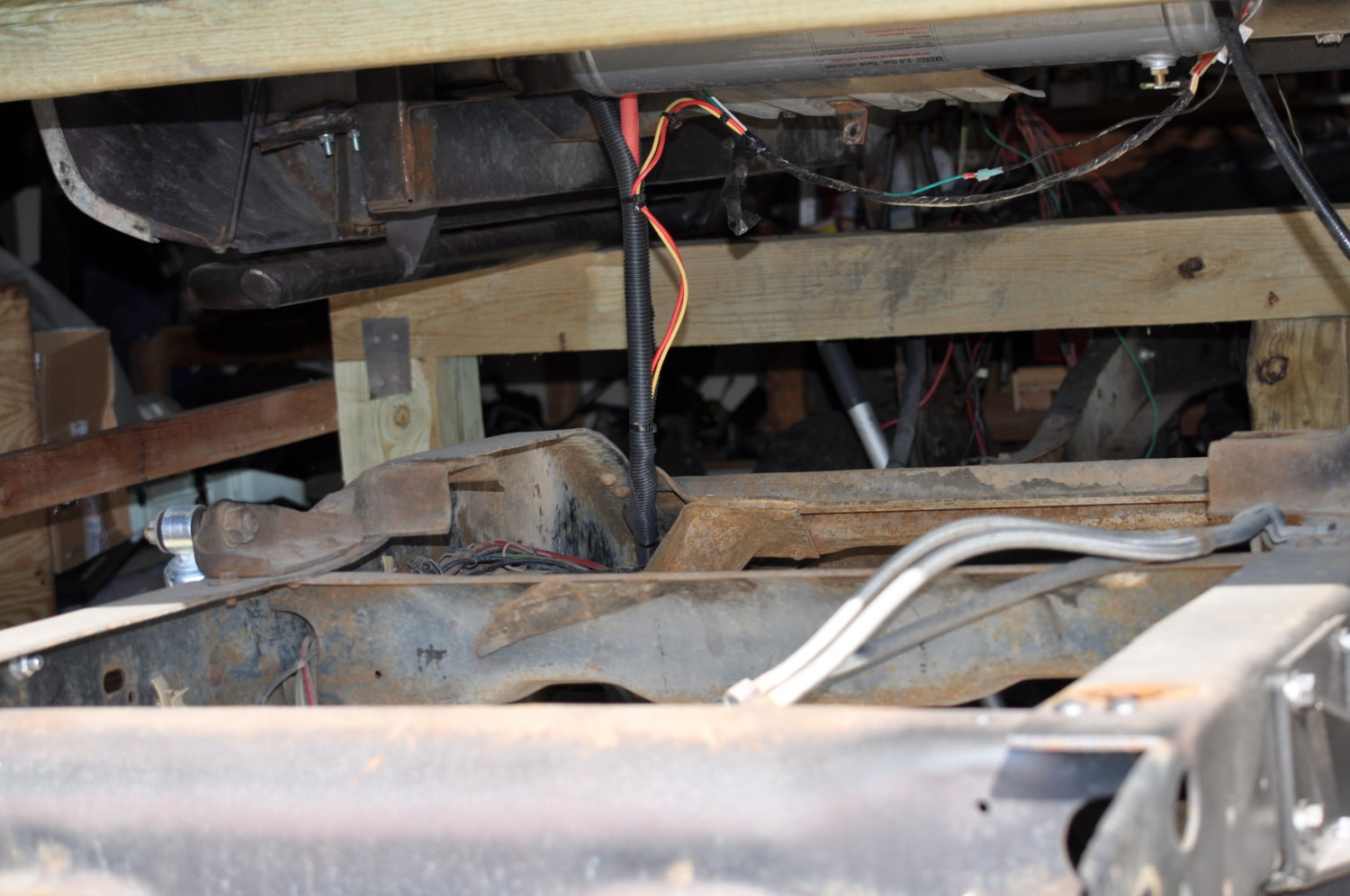

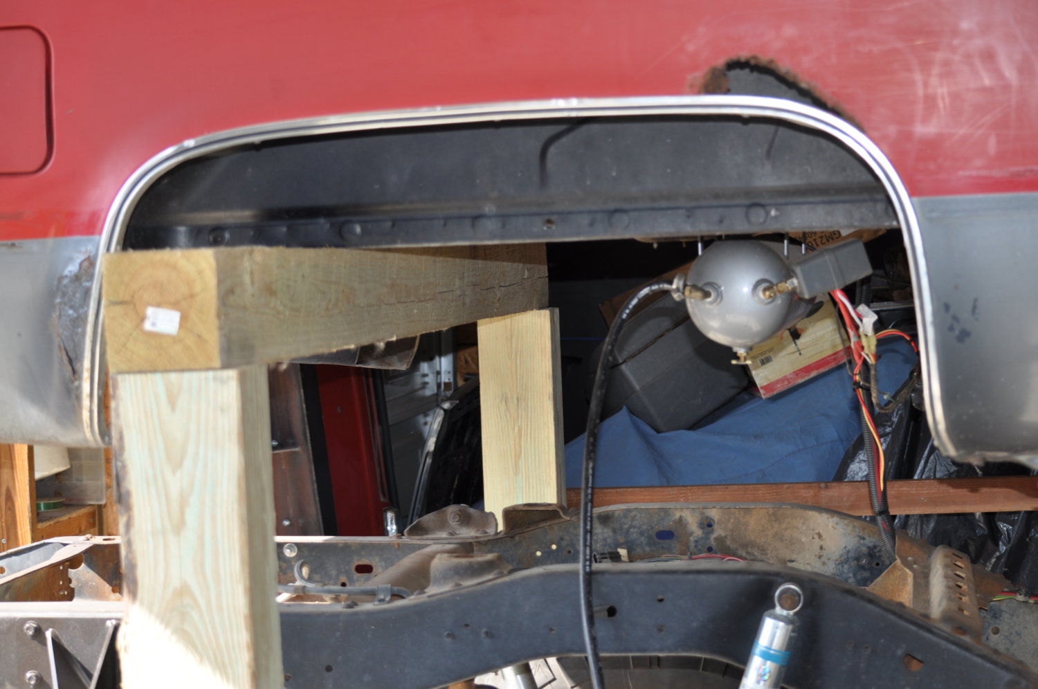

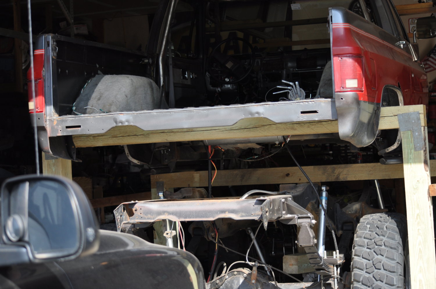

@GWeakland620....Sorry to get off track from our conversation earlier. Sell me some patch panels for the rear quarters for my 87 K5.
Right rear between tire and rear bumper
full
Right rear just above front of tire.
full

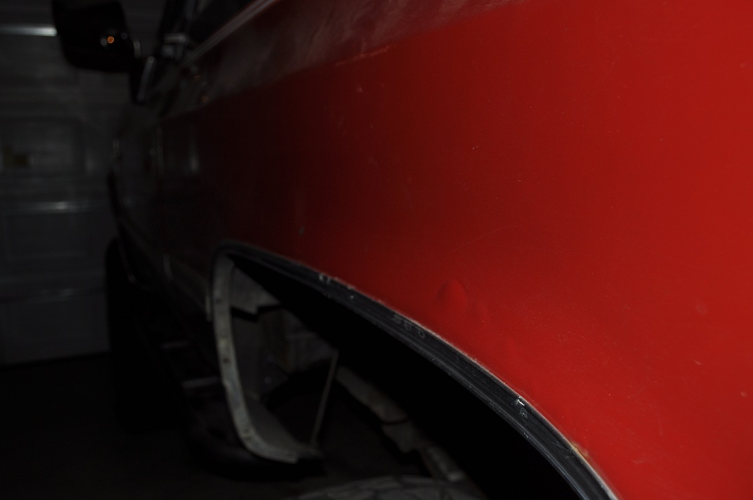

Driver side rear. Looks like some body work done from PO that is bubbling.
full

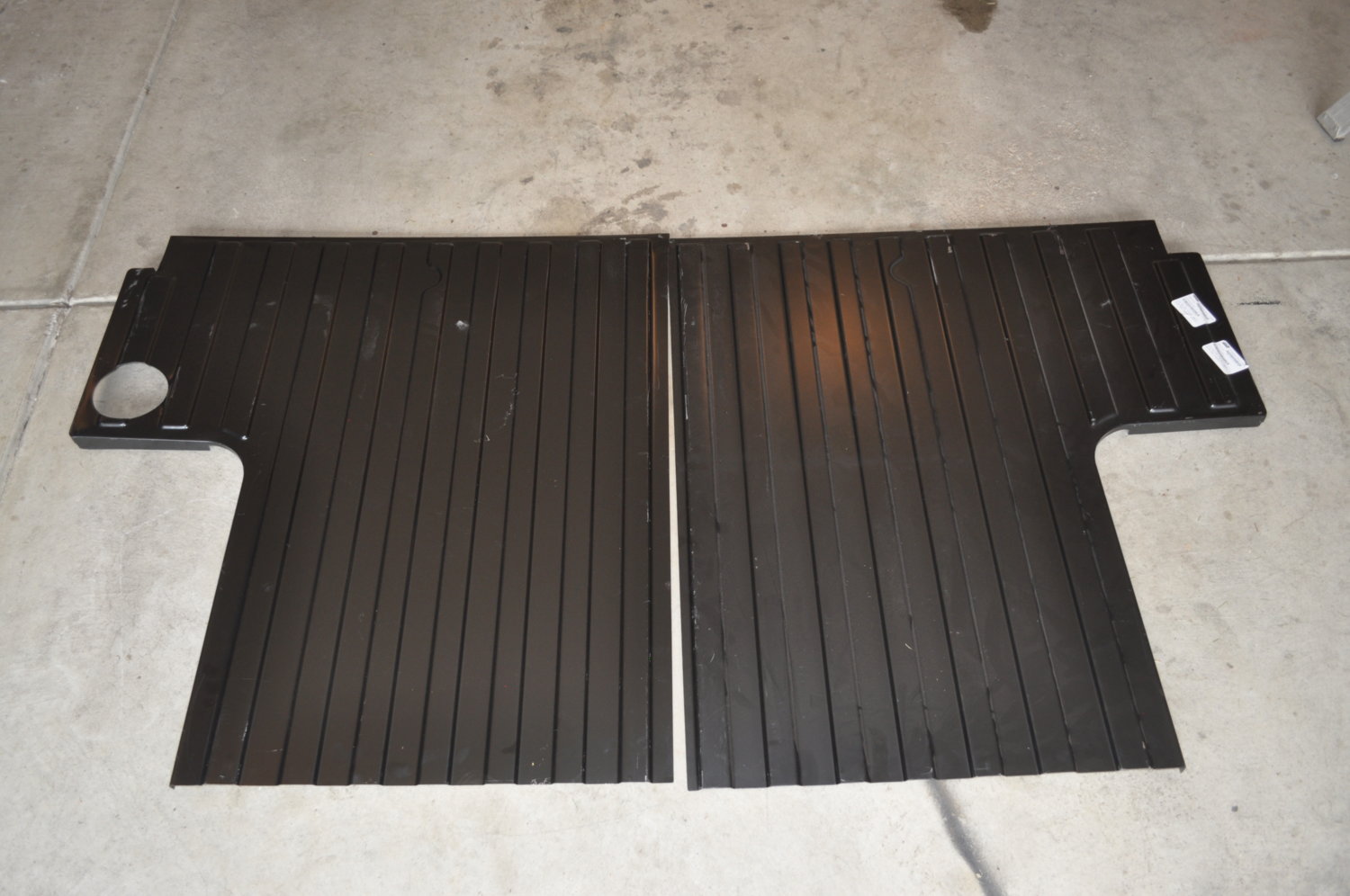

I might need some of the flooring also. What can you get? Just let me know so I can get it ordered. Thanks, brother.

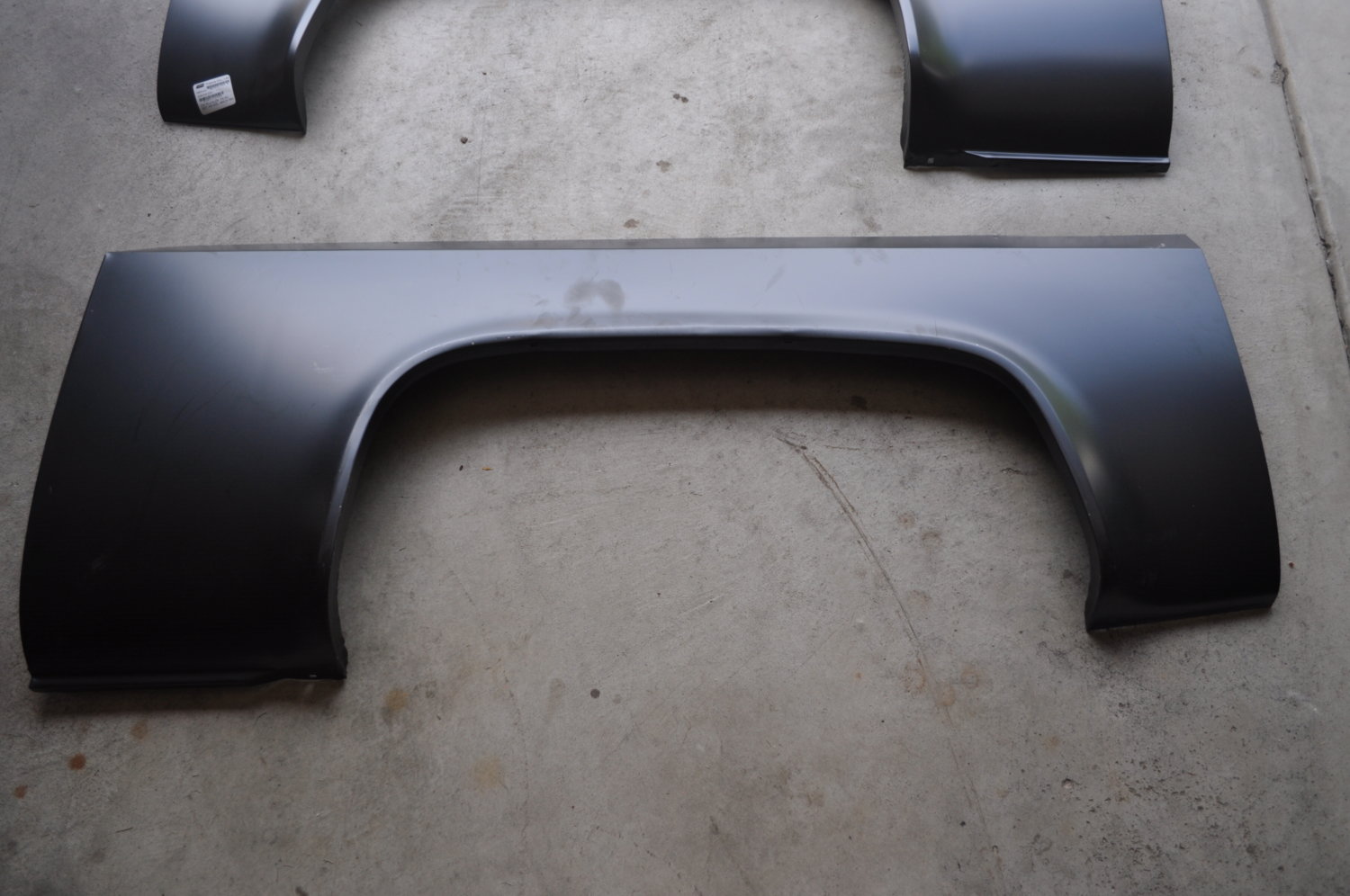

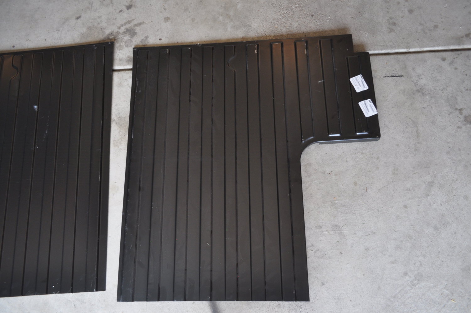

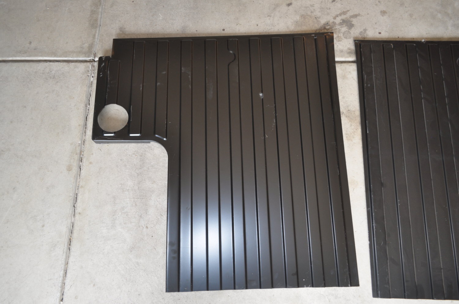

I got with @GWeakland620 and got some panels ordered. Your are 100% correct, Greg, these panels are superb. Thank you. :waytogo:
full
full
full
full
full

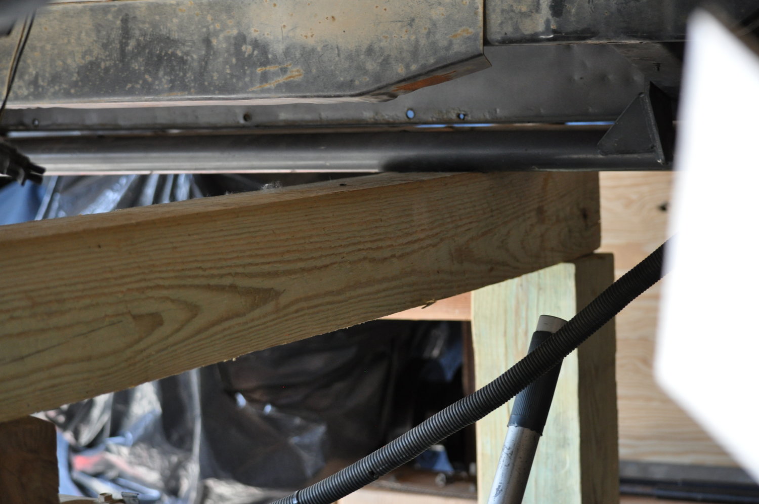

I can't wait to get started on the welding to get them done. The first thing I need to do is repair/weld two body mounts underneath the K5. Then I can start replacing the cargo floor with the new panels.
I've got to finish the cage in that area also.
The quarter panels can wait until the rest of the work is done. New engine, transmission, NP241, etc has priority. Not getting the quarter panels done will not keep me from BB18. I'm probably going to need to wait anyway since there is always a possibility of damage. :whistle:
I worked with Chris @1977k5 and @Stephen at ORD on getting the Trail Ready Beadlocks ordered. Possibly a 2 month wait but it could be sooner. I ordered 5 of the HD17s with the World Series ring, 3.5" backspacing.
Thank you Chris and Stephen. :waytogo:
Once I get a break in work I'll get some 42" Super Swampers ordered so they can get here soon.
Other than that, just a waiting game. I will post up some pics as the progess moves forward.
Glad to hear you like the panels. I try to tell everyone how great the product is.
Also, I had no idea you were going 42’s, I can’t wait to see this beast done!!!
How is the thickness on these panels compared to the originals?

The original panels are showing .048 thousands compared to Goodmark at .040 thousands.

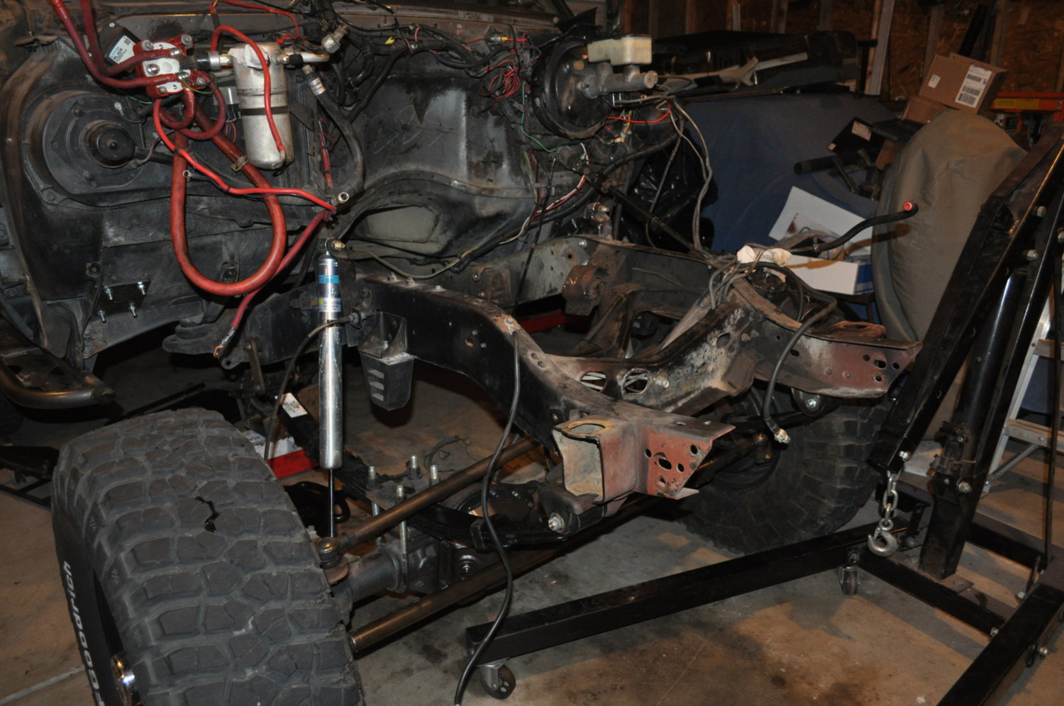

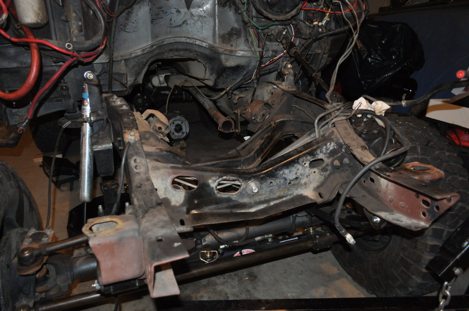

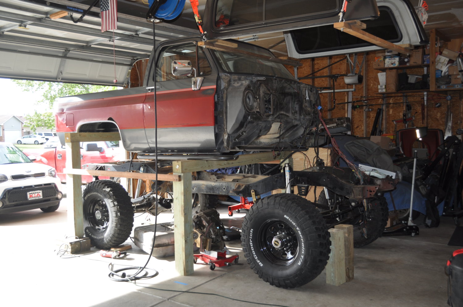

I tell my kids that this is the height that the truck will be when I'm done. I get that....."Are you serious? How do you get into it?" look.
The grandkids thinks it's cool.

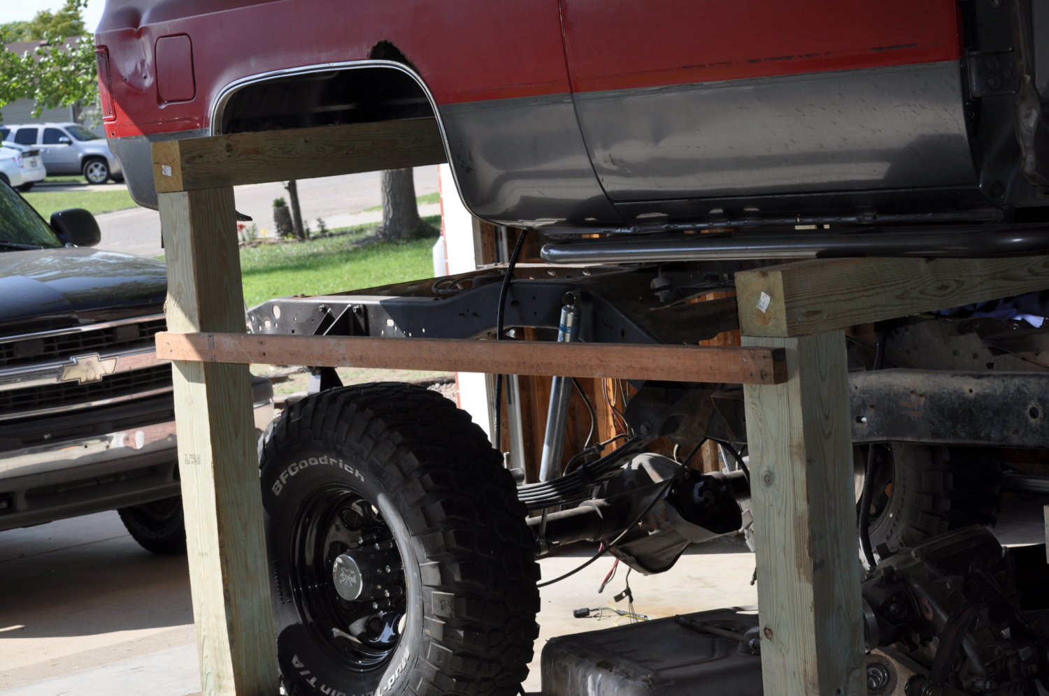

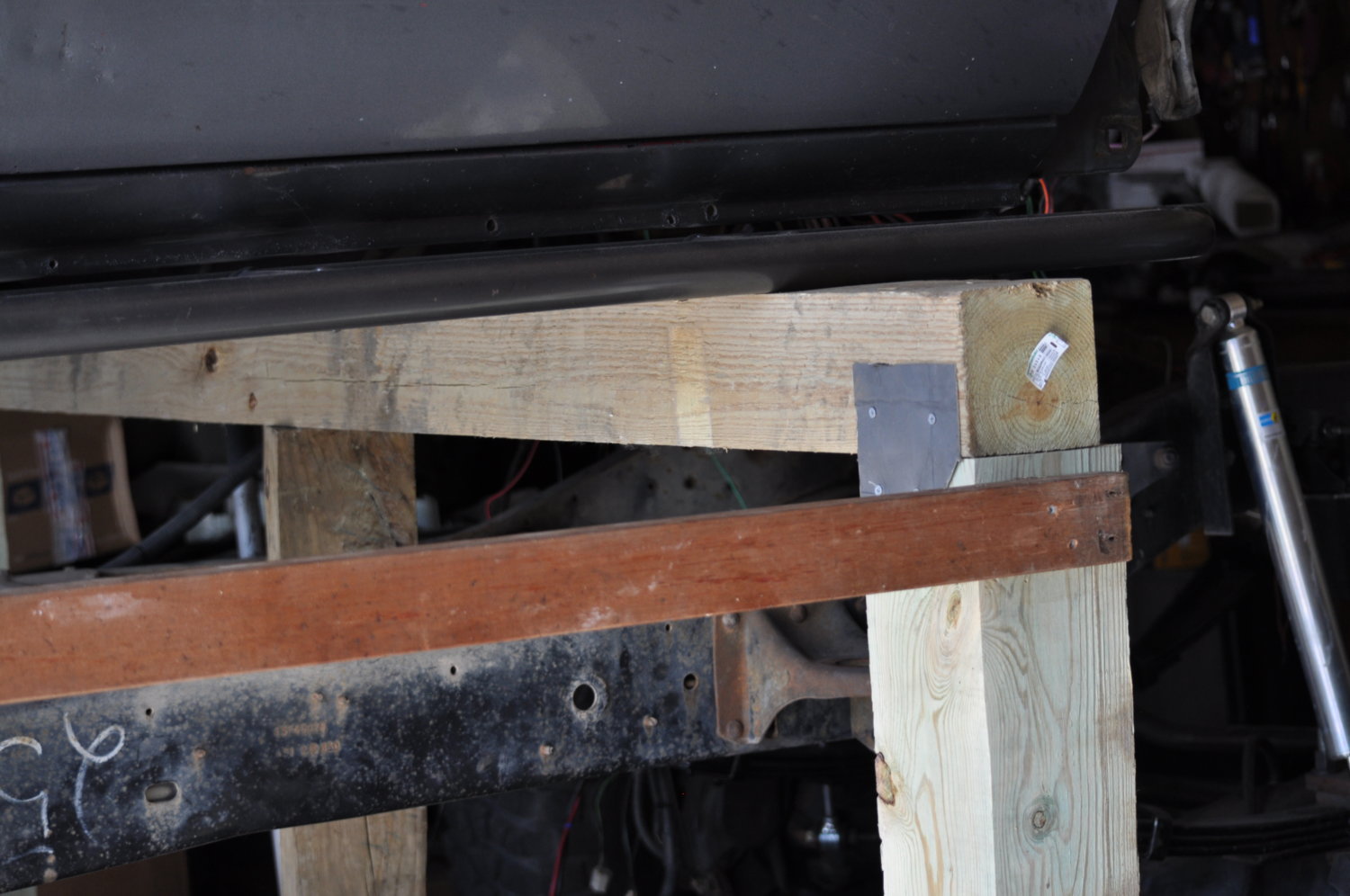

I can roll the frame out from underneath the body if I remove the front shocks and shock towers. Amazing how much you can do when you have the room. :waytogo:
