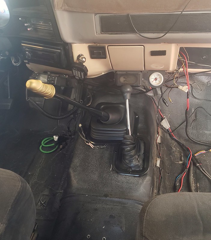

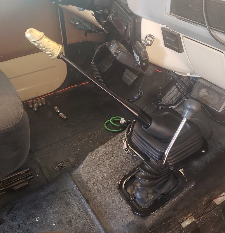

Got the shift levers, bezels and boots finalized today. They will look much better once he throws in some jute and rubber floor mat.

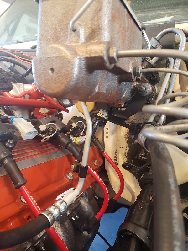

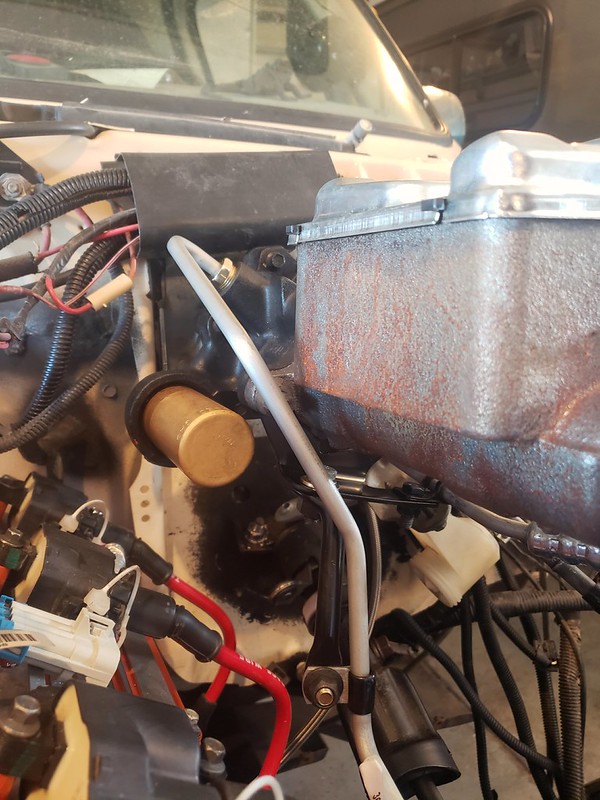

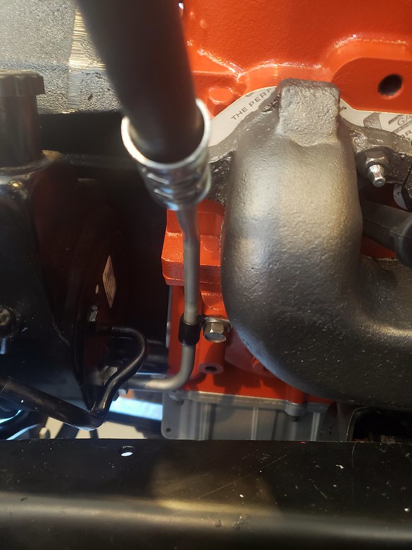

And got the power steering line from the hydroboost routed and secured with some sturdy stand-off brackets. I’ve found using a 1996 L29 hydroboost to pump hose works best with this particular power steering pump but the hose routes on the opposite side of the master so that is why some sort of bracket must be concocted to support the long tubing. It’s the same set up as on my Suburban
