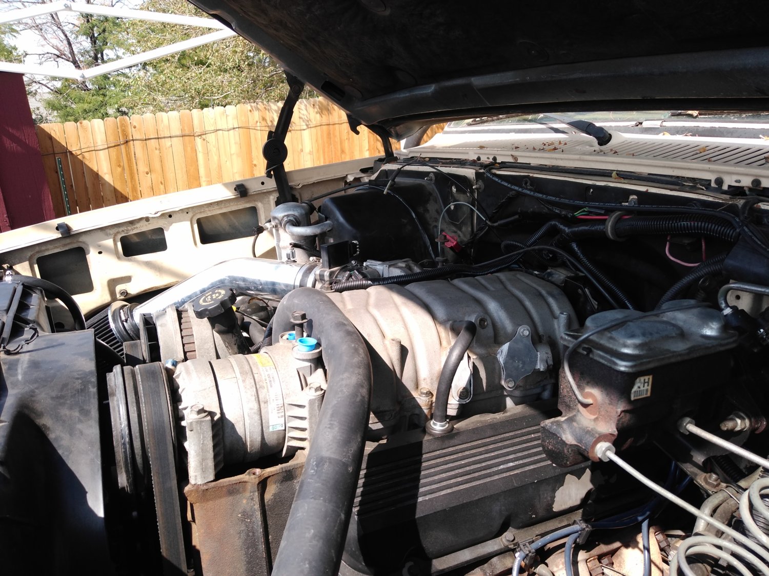

I didn't get much done on my own junk since I'm waiting on my guys in the body shop to shoot my inner fenders. But our buddy Andy needed some help on his Suburban he's been working on swapping a L29 454 into. All the heavy lifting is done, but he struggles with electrical. He wanted to keep the stock cable speedo from the 208, but the 4L80e needs a speed signal. So after doing some research he got a signal generator and converter box from Dakota Digital. That's what I was going to set up. Following the instructions I got it all plugged in and set up, but couldn't get my wifi obd2 device to work with my phone to read the data. We were able to take it for a road test and you could feel the trans making the shifts happen normally and even detent downshifting. So I might have it right, but really would like to get a real scan tool on it and watch the data live.
Here's the beast we've been working on. It's the same one that had been running a 6.2 diesel with a Banks turbo.
The new to him gasser.
We put some miles on it after making sure all the fluids were fully topped off. As it turns out we think he's got the wrong dipstick in the trans as it seemed like it was full but barely engaged. 3 more quarts later and it started moving. The beast pulls itself around pretty well with the L29. It needs exhaust and some final details to start racking up miles and working out the post swap gremlins that might creep up.
Felt good to get this one back on the road after being incapacitated for more than a year.

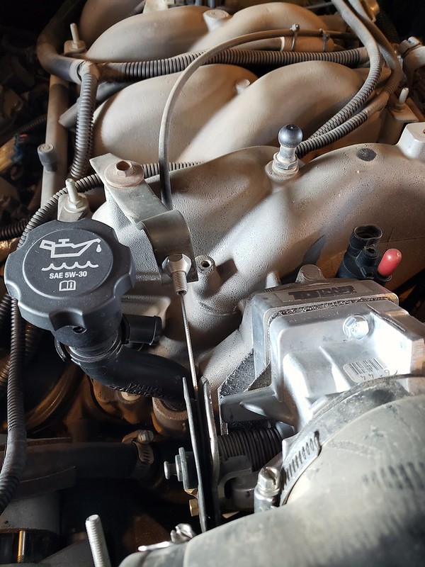

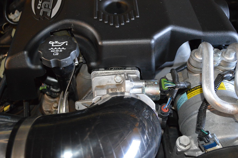

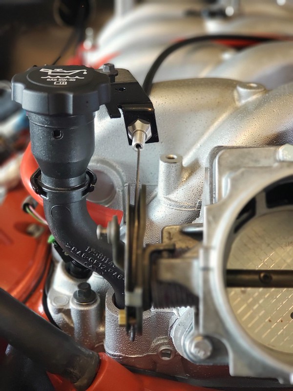

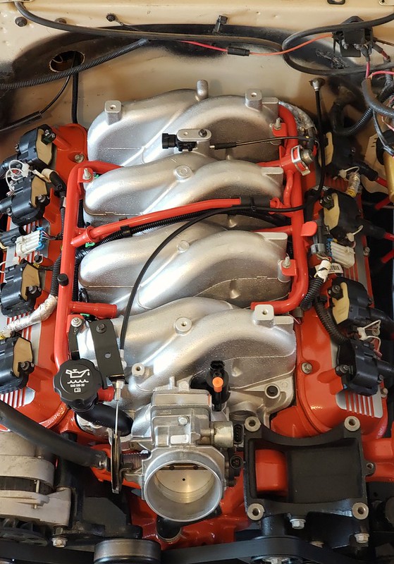

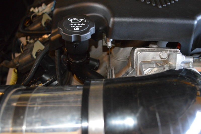

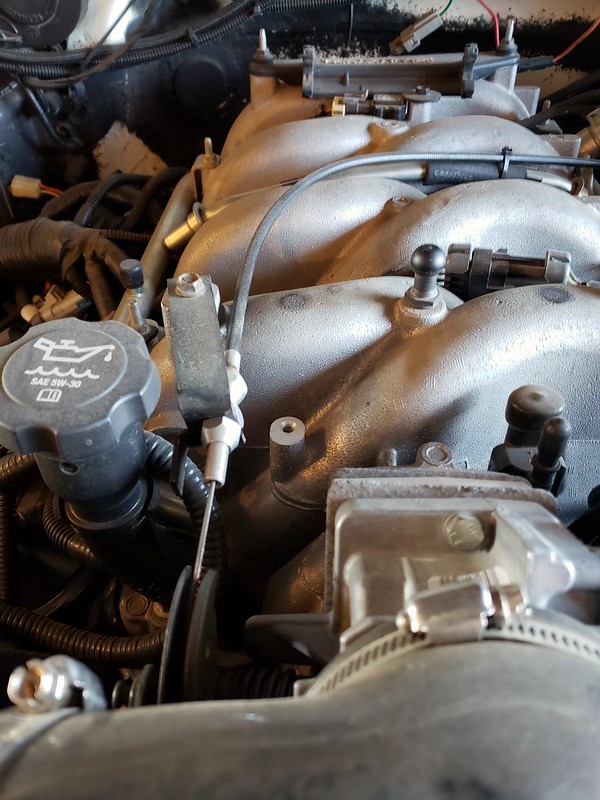

So, people are often asking how to attach the throttle cable on an 8.1L when using a L29 7.4L cable operated throttle body. Here is how I’ve been doing it by making a bracket out of whatever I can find laying around in my stash to work with the Lokar TC-1000LS1U throttle cable. Rob’s turned out just like my K10 and Suburban. We wanted his to look especially nice since his won’t be running an engine cover. Getting pretty close to start attacking the wiring

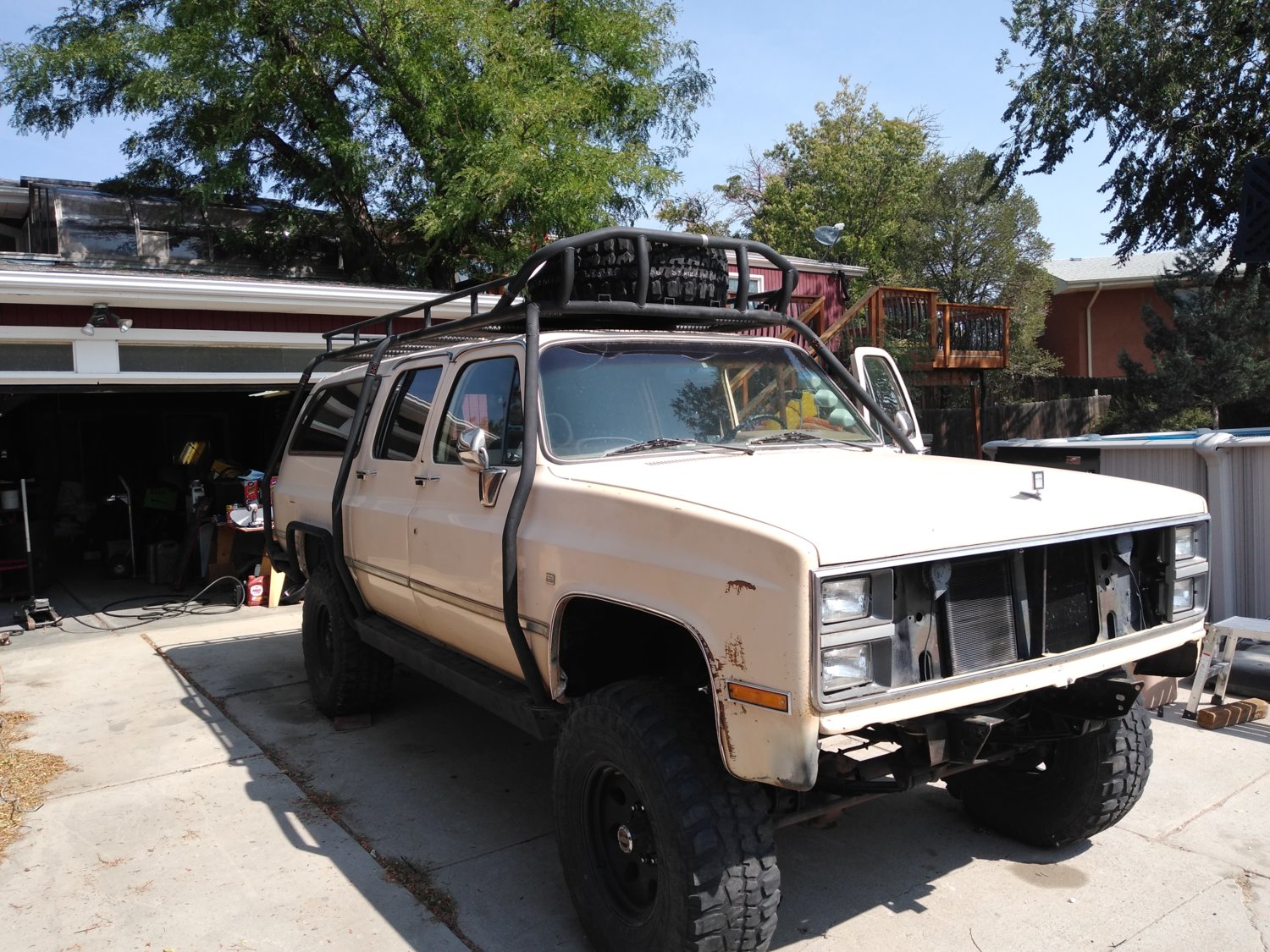

This one is my Suburban

Looking good as always. One note to the throttle cable is to avoid interference with the oil fill tube you need the later curved version. The early version is straight and close enough for the cable to rub on it when in use.
Larry's noted that before but it's worth bringing up with what he just posted.
Ya, that's a for damn sure. The straight one is no bueno for with a L29 throttle body. Unfortunately, I didn't know any better back in 2007 when I did the 8.1 into the K10 as all of the 8.1s we use in production at Workhorse still used the straight one all the way to the end of production in 2009. Its almost like some GM engineer had the foresight to know that dudes wouldn't tolerate DBW years down the road as they started swapping better throttle bodys on them so they created a nice curved one to save us the hassle :thinking:
Curved filler tube is 12581140, the cap 12573337, and the engine cover to match is 12574560

Is the angle of the bracket determined by just that single bolt? Have you ever had a problem with the bracket rotating around the axis of the bolt? Seems like it would try to do that every time you stomp on the pedal hard enough. :thinking:
:dunno:
:dunno:
If I had known problems with this arrangement over the years I certainly wouldn’t do the same design to a 3rd rig :dunno: A second bolt would be ideal but then again, I’ve never had an issue in over 10 years and almost 50K miles on the K10. If you really think about it, the sheathing doesn't have the working pressure on it......the cable does. The sheathing is nothing more than a guide for the cable to run
