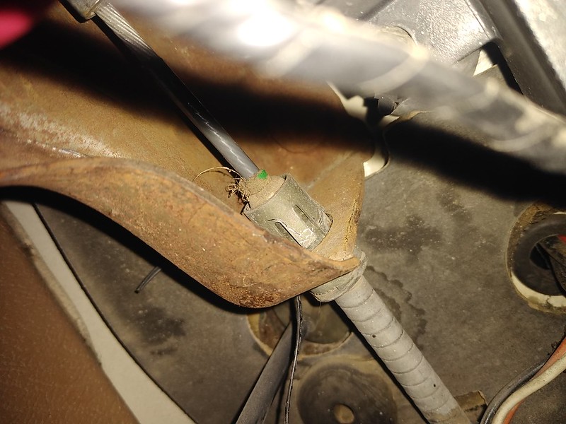

I managed to get the front cable removed from the park brake assembly. Man that's a crappy job. I tried to get the clips to push in so I could pull down on the cable and it just wouldn't budge.
Here's the little SOB in its natural habitat.
I ended up saying "F" it. I can't use this cable anyway, so I went on with snapping the three lock tabs off the end and was able to pull the cable out after I removed the grommet from the floor.

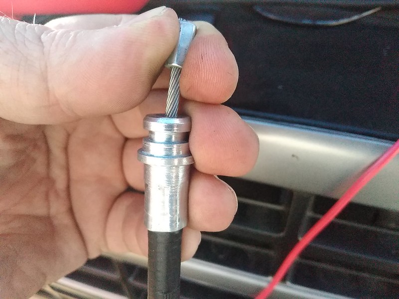

The new cable does not use the same retainer.
It takes the standard "U" shaped spring clip to hold it. I don't have any of those. I texted Larry to see if he had some and he said he did. I drove the truck over as a test and no issues. Everything is back to normal. Got the clips and made a couple of adjustments over there.

i always use a small hose clamp on the p brake housing clips. works ok still need to finesse it.
I tried that. Between my bear paw hands and the need to hold the clamp and tighten it at the same time I just could not get it to pull the clips in. My right hand cramped up in the process. That was the signal to stop screwing around.
