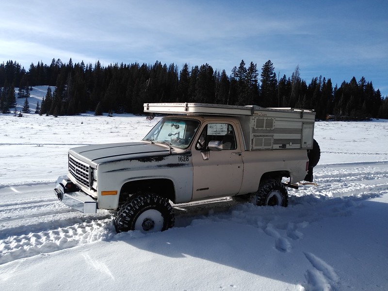

This is the build for my 1991 V1500 Blazer, AKA the K5.3. It started out life being sold to the U.S. Government with a 350 TBI/700r4/241 combo. 4 years with a 5.3/700r4 Combo and now moving to an 8.1L Vortec and NV4500 5-speed.

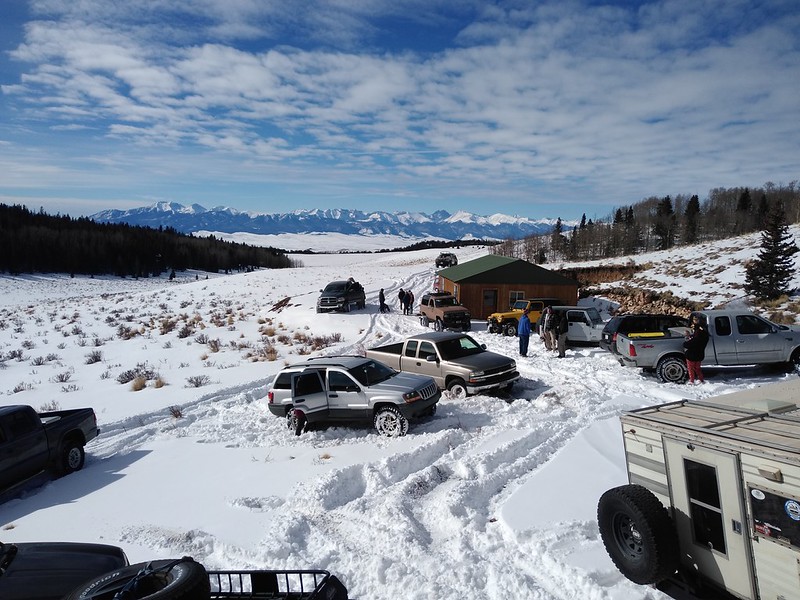

Standing on the deck of the cabin looking west.
Our host lit a fire in the fireplace to warm us up and he cooked up a mess of hamburgers and hot dogs, we all bought something to pitch in for lunch that hit the spot after the ride up.

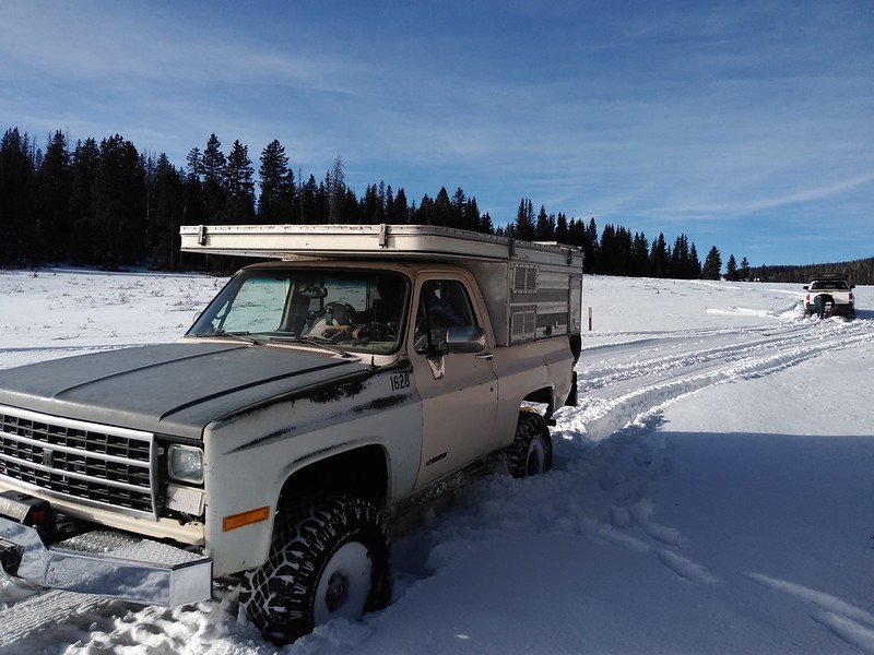

We eventually got high enough to reach a clearing from the trees. That area is deceptive. The wind blows through there drifting the snow deep in low spots. Larry is leading the way and manages to sink in and almost get stuck. He was able to back up enough to let me get by. The trail looked like a groomed ski run with corduroy grooves on the surface. Hmm, we must have stumbled onto a snowmobile trail here. By now I'm in low range and humming along in 2nd gear letting the 8.1 eat. Progress was going well getting a couple of hundred feet past Larry's spot when my momentum slowed and the truck broke through the crust and sunk in deep. No way to move forward or backward. Stuck good. Ironically, it's only a few hundered feet away from where I got stuck in May where I took the picture that was used for the calendar.
Just as stuck as before too.
Bill and Larry work their way down to rescue me. 3 tow straps couldn't reach. Larry had to use the Waggy's winch to pull me back enough to have Bill give me a tug from his direction where he is in shallower snow.
After a group of snowmobiles buzzed through (they didn't look happy to see us either) Bill was able to yank my heavy pig to spot where I could move again.

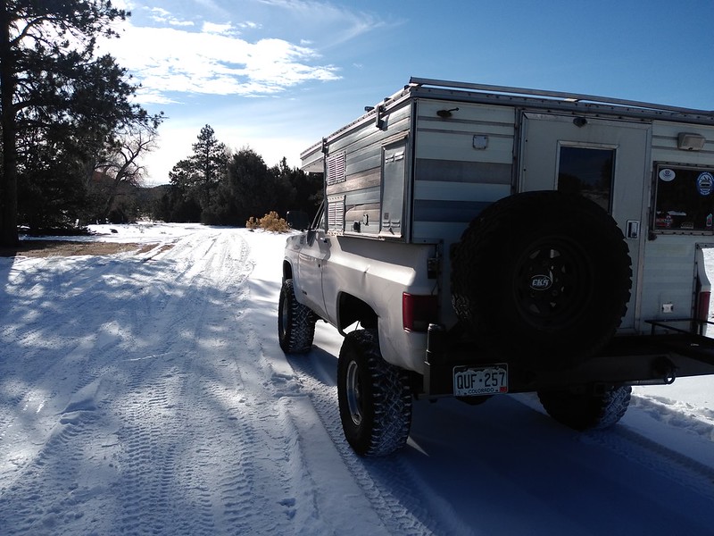

It was a great first run for the truck. The drive to the trailhead took us 40 miles down the interstate where the truck hummed along in 5th gear without any issues. The big uphill climb just south of Colorado City where the 5.3/700r4 would be wound out in 2nd gear and losing speed the 8.1 didn't disappoint. Just roll on the throttle and it stayed at or above the speed limit in 5th. On the trail where I'd be in 4lo once the snow started getting deep or steep to keep the 5.3 in the torque band, I kept the t-case in high range and the 8.1 cruised in the snow in second or third gear without complaint. Only when it got really deep did I ever thrown the trans into granny gear or go for 4lo. Larry's spring adjustment really did its job without adding stiffness to the rear end. On-road it felt the same. Off-road it was just as good as before. We both wondered if it would make the rear bouncy or stiff. As un-scientific as we were picking leafs from other packs, it came out good. The steering gear Larry threw on made all the difference for road handling. No more wandering down the road.
Overall, as I thought it's a completely different animal to drive off-road and now on road too.

In the pic from the cabin, you can see a couple of rigs that provided quality entertainment for us. The pewter Silverado spent a solid 10 minutes trying to get up on the level ground next to the older silver F150 there. I thought I've revved the snot out of a 5.3 myself but this kid put me to shame right then. He was pounding on that poor truck as if it owed him money. Ian and I were standing on the deck watching this and cracking jokes with each other. I was laughing so hard I almost hyperventilated from the lack of oxygen at that elevation. The Jeep next to that truck struggled to try to get up to the level ground too and made multiple attempts to do so. Each one having us laughing harder too. The F150 there had a bigger exhaust leak than I did or it was spitting out a couple of spark plugs from the 4.6L it had in it. He drove just like the Silverado kid. The Grand Cherokee behind the F150 was on street treads and required more tugs when the depth got serious. The Bronco II is actually pretty capable if the driver didn't whip it like he does. A couple of years ago he was up there with us and he managed to snap the pinion on the Dana 30 TTB front end. Sure enough, at lunch, we got to watch him swap out a driver side lockout hub that he managed to break on the way up. The Bro-dozer Dodge is just to the left of the Bronco.
