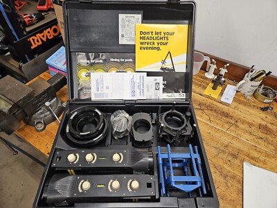

Where did you get the headlight aiming tool? I've tried to find something like that with no luck.
It’s from my Dad’s stockpile of stuff.
We use to use those way back when I was doing autobody, I forgot all about them.
We had a set at the dealership, Gm special tool number and all. Though it was made by hoppy and looked exactly like the kit I have now. Ironically I never saw my Dad use his. My old ace tech at the dealership broke them out to do and older rig and I was watching the process. Pretty simple to adjust until the line matches up.
Got to admit old technology isn’t necessarily bad compared to new stuff. In this case using the tools you don’t have to wait until it’s dark and see how the light pattern sits on a wall from a specific distance. I did mine in broad daylight and never even turned the lights on. It’s way more accurate than what you can get on the composite lamps with built in adjusters aiming at a wall.

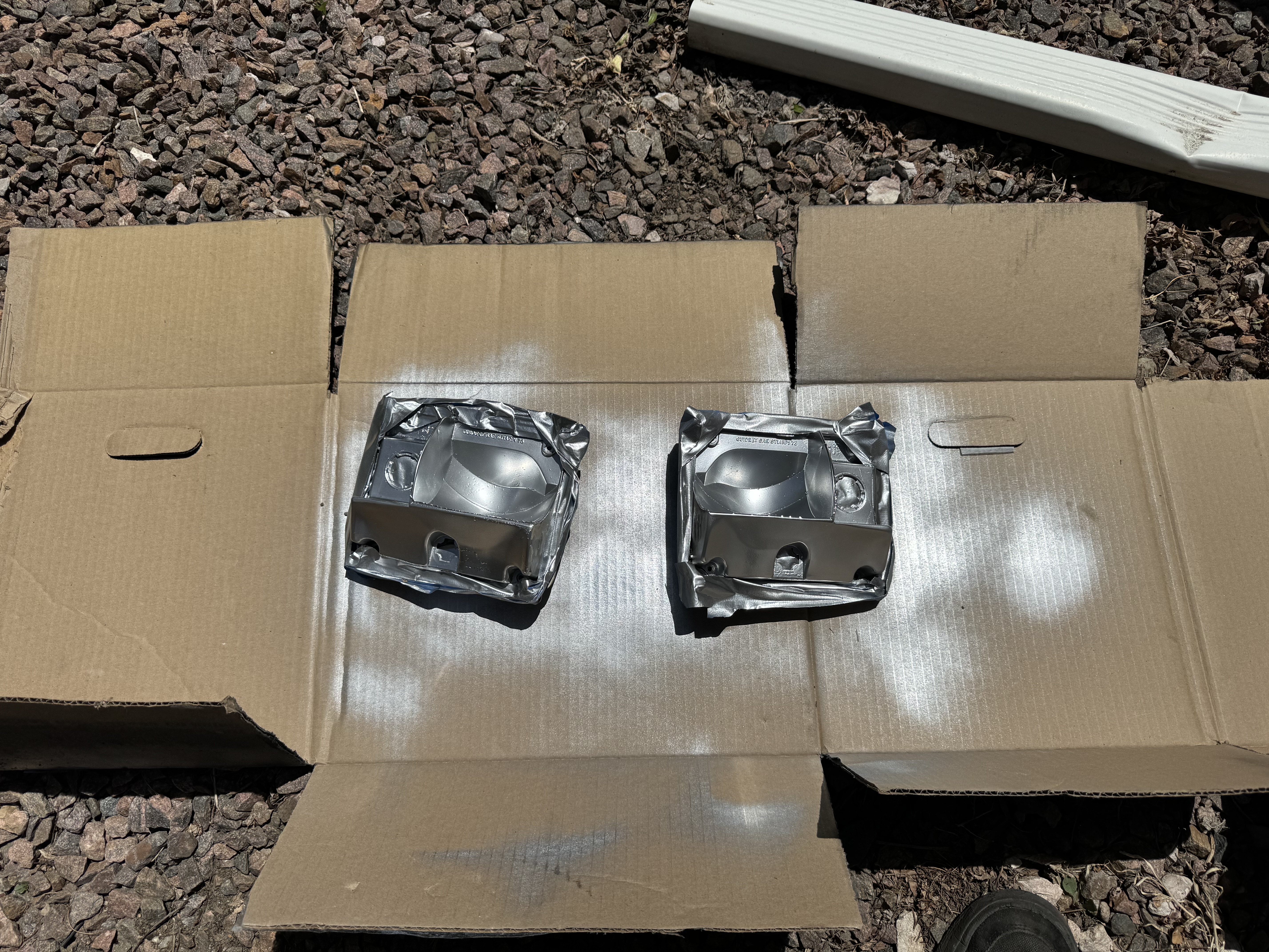

The taillights were noted to be dim when Bill was following me a couple of weeks ago. I’ve got LED bulbs out back but he was right. They work but it’s dim.
Sure enough I found the inside housings covered in tan paint. I didn’t remember that but I went and grabbed a can of Alberta Chrome and got to work.
I gave them a couple of coats after scrubbing the Utah dirt off of them both. I put them back together with some new LED bulbs in the stop/turn and move the other LED bulb to the back up light. Much better now.

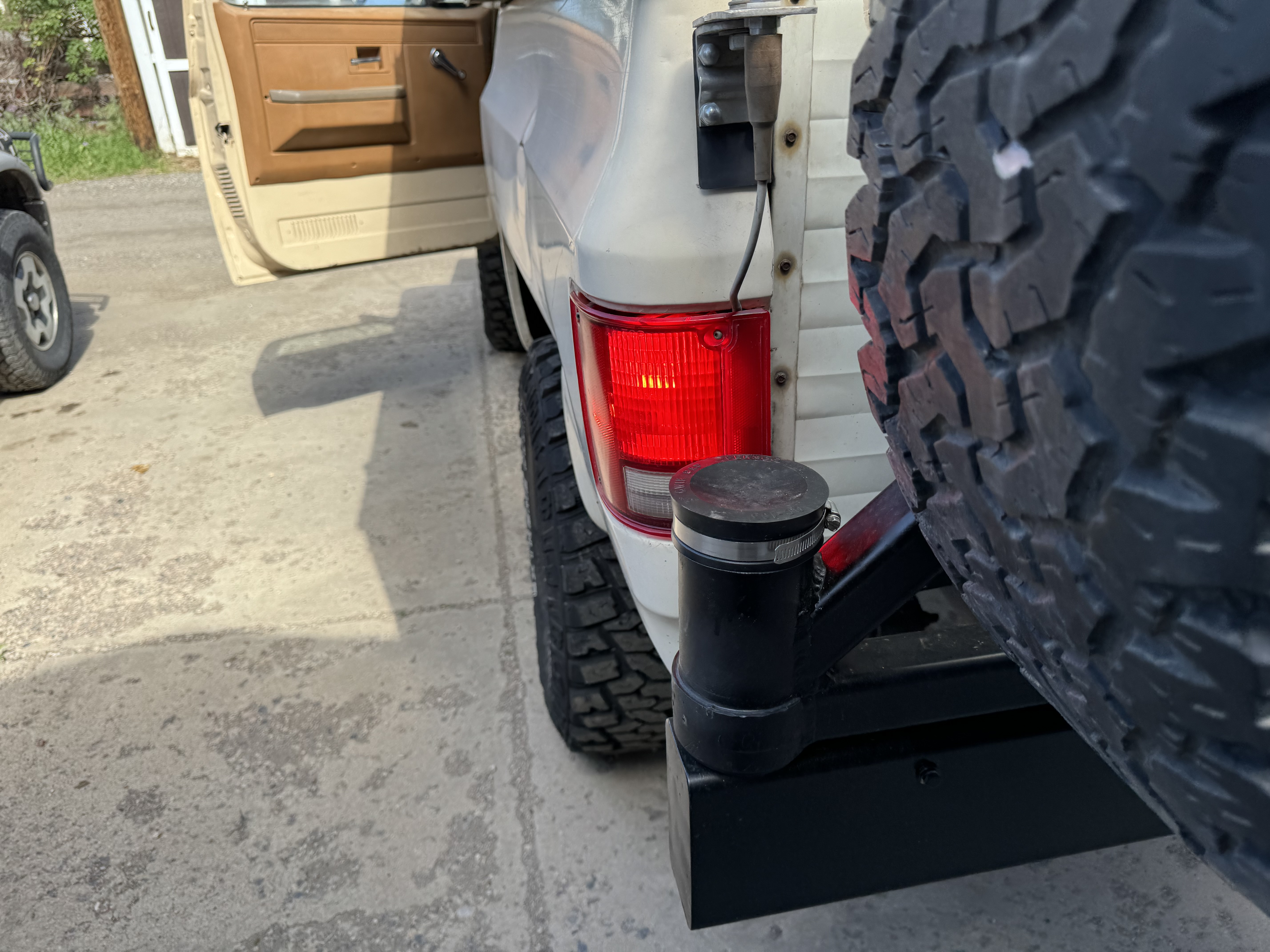

Very convenient place for those monster hinges blocking the tail light
First off about all they block is the backup light bulb. Secondly the left has been that way for few years and I’ve yet to get any harassment from any Johnny Law in four states that I have driven it in.
But I do certainly appreciate your constructive criticism. It’s totally noted and just as likely to not be addressed to your liking at all. I guess I’ll have to refrain from throwing the trans in reverse because I doubt anybody could see the insanely bright white LED bulbs I have back there.

It was just an observation, nothing to worry about.
It has to be exactly in alignment to block the light and in real life that can only happen for a fraction of a second on one or the other
Mine is about the same, except I only have a single swing. That position is very hard to avoid. Obviously, the hub/spindle has to be outside of where the tailgate opens. Making the bumper wider than the body and moving the spindle outside worsens the leverage (stiffening these corners is a critical criteria for swing-outs) and makes the bumper prone to hitting stuff. As for height, there is only an inch or so to play with between the top of the frame rails and where the tailgate folds down to. You could theoretically make the bumper step down at the outer end and attach the swing arm higher up on the hub and get the hub a couple of inches lower, but now you're making the leverage on the spindle worse and greatly complicating the design/build.
The simple solution is probably making holes in the bumper for some bigger back-up lights. The factory light is pretty small to begin with. A 2-stage would be cool, where you get "normal" illumination for street and parking lots, then a switch for "off-road" backing lights.
It’s totally a balance for sure. I didn’t want to block the brake/turn but the backup light was a sacrifice. Though the door on the camper is centered I could have cheated inboard of the light but that would have created two new issues. One, a factory tailgate wouldn’t be able to be used. Two to remove the camper either the bumper has to come off completely or it has to be raised enough to clear the swings. Which raising the camper is sketchy enough as it is just getting it an inch or two off the bedrail as it is.
The entire idea in my case was to use shared components with the front axle. In a pinch I can swipe a lockout if I damage one. If I’m having a really bad day I can swipe the bearings.
But one of the biggest factors behind my setup is strength. If you look at what most fab suppliers list for swing out parts they are trailer spindles. Which are far smaller than the bearings and spindle in a d44/10b setup. Sure the size of the hub is twice as bulky but I’ll trade the size for the strength factor.
I may add some secondary back up lights at a later date, but I don’t want to French in any trailer lights to the face of the bumper.
