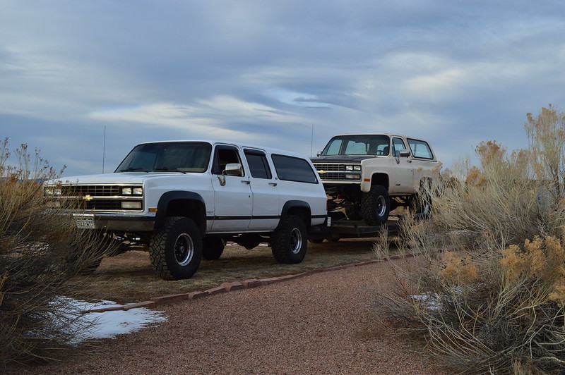

So I pull up and find the K10 outside with the Blazer. Had to snap a couple of pics. Not a full family portrait but close.

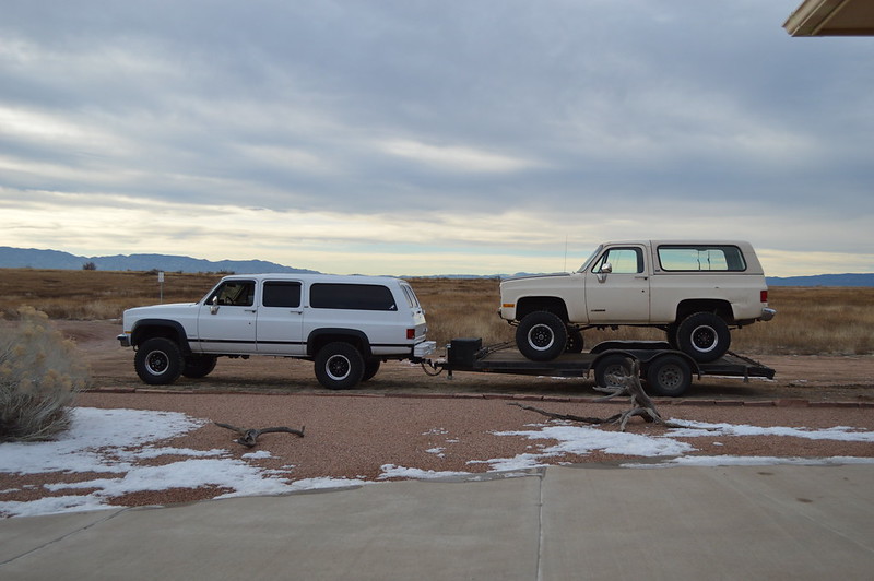

Another shot.

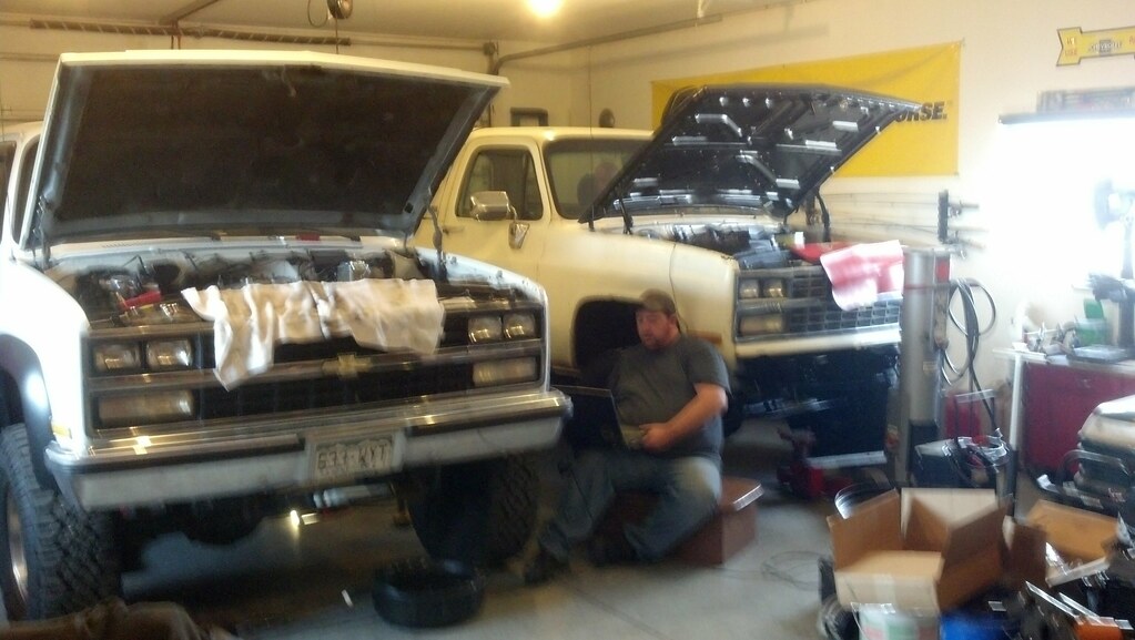

I hooked up the laptop to see if my TPS reading is dropping out to cause the stumble. Watching the TPS percentage and voltage I found when the throttle got close to 95% the reading for percentage would drop to 6.6% but the voltage was still 4.5v or better. Larry had a spare TPS sensor so I swapped it out and rechecked. It behaved the same way. Our thought is the weird reading was probably more to do with the old scannerpro software than the TPS itself. Tuning looks to be the solution for this issue.

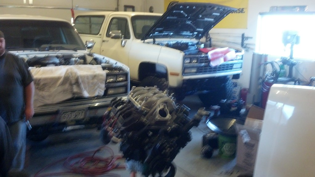

The larger amount of work done was on the Burb. Larry needed help pulling the hood and running the engine hoist while he freed it up all over. We got it out and was able to get the engine torn down to swap out the hot rod camshaft.

My crummy cell phone pic contribution to the day…Mr. Zoomad talking to the 5.3L via ScannerPro

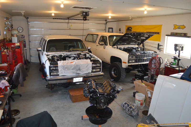

Polar Bear Burb 8.1L on the stand for dehotrodding….

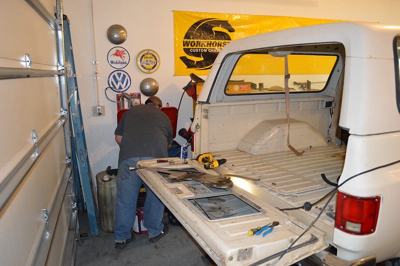

The mechanical side of the window is fixed. As expected it was gummed up with dirt filled decades old grease. Just the same on the manual windows, this causes the motor to drag and pop the circuit breaker from working too hard. Here's how gummy it looked to start.
The tracks were just as gummed up.
After a cleanup in Larry's solvent tank.
The mechanism works much more smoothly now. That is when you chuck the drive cable to a cordless drill. The dash switch moved it slightly before I got started but it wouldn't click after. Just like everything else the wiring is sketchy. So I'll leave that for another day.
