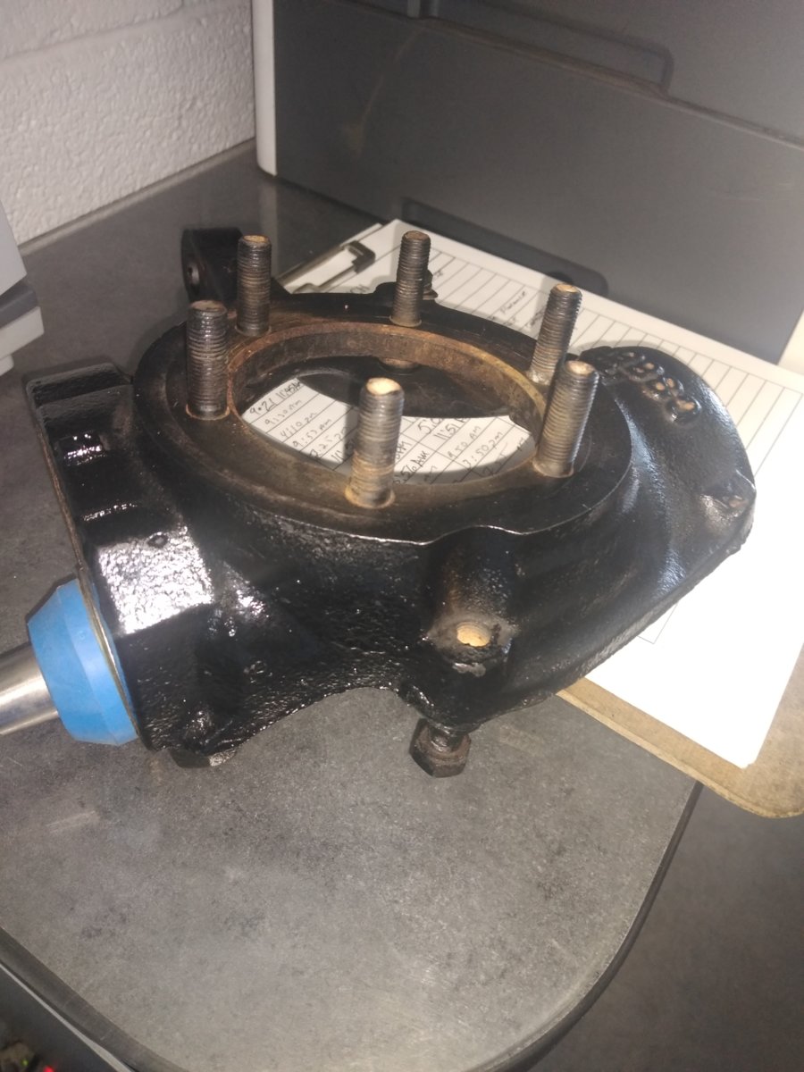

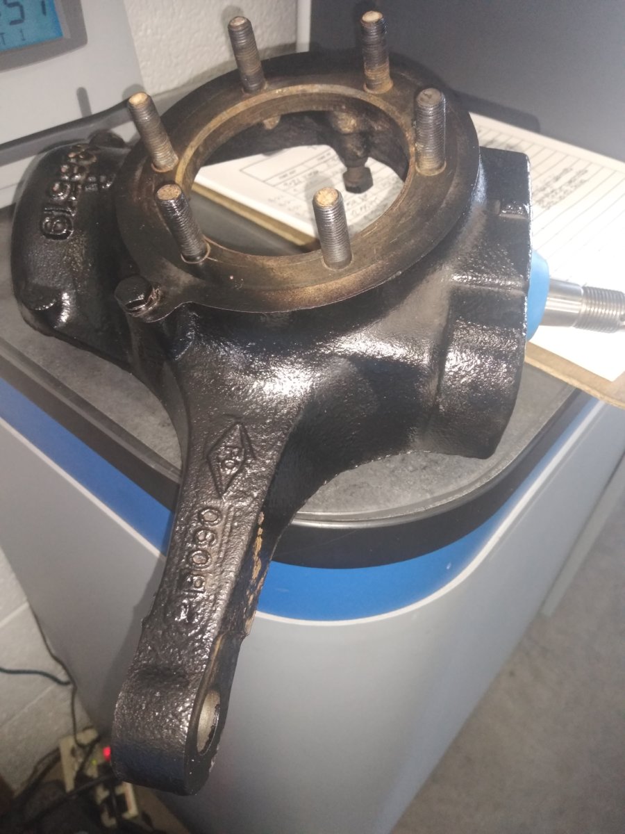

I've ended up with a flat top knuckle anyway. It really didn't matter either way for me, but it is what turned up.

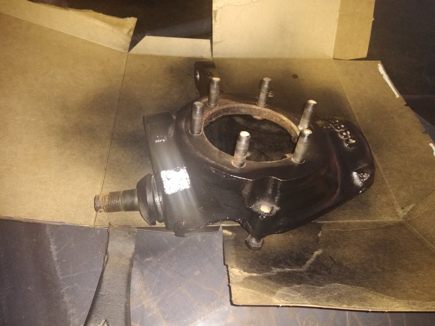

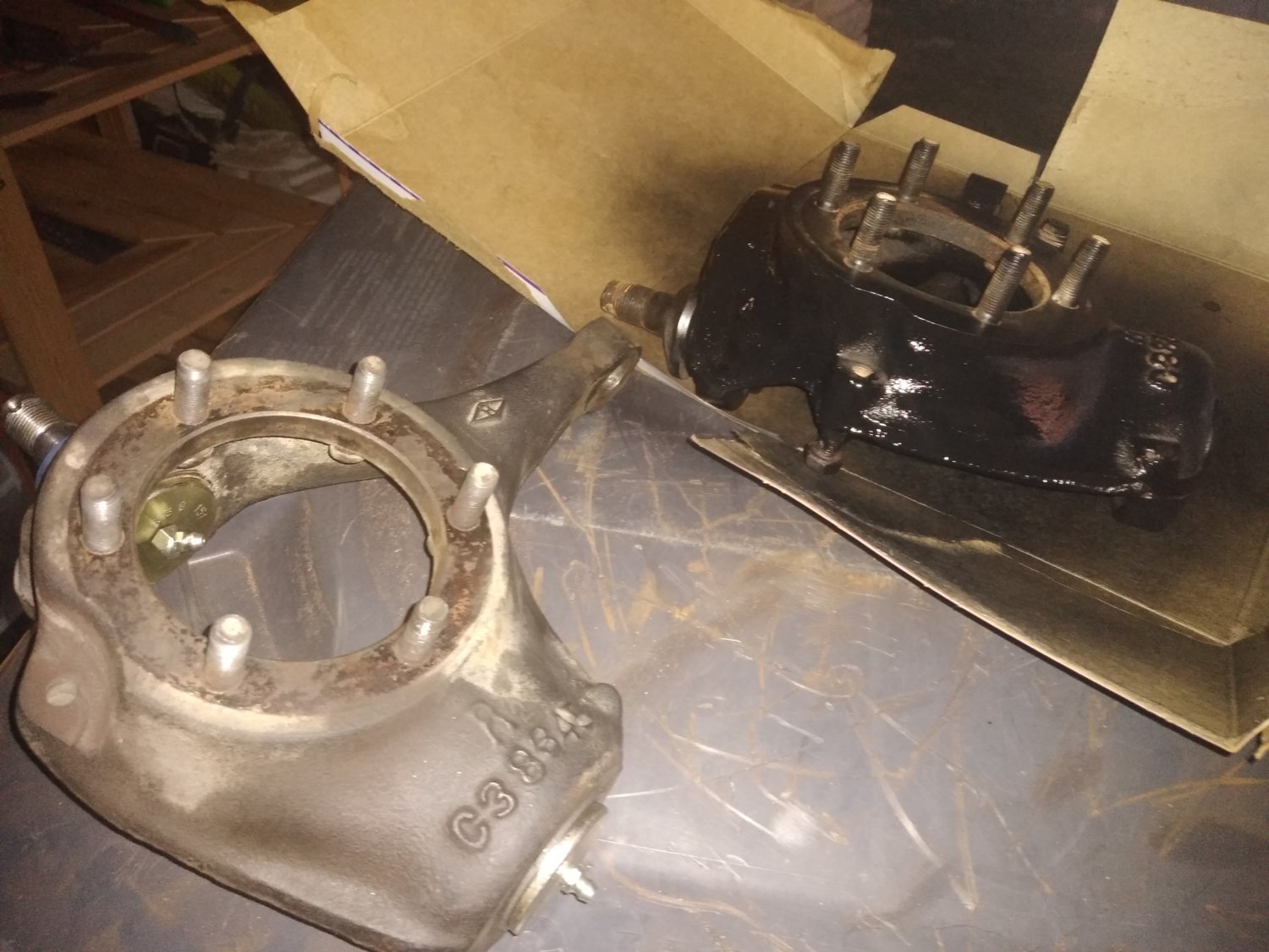

So I brought it home for a quicky wire brush and Rustoleum rattle can restore. Needs a little more paint, but I ran out of daylight.
I'll take them both to work and swap out the ball joints. The zerk on the upper was just to let me add grease before the shaft went in. I've got the plugs that came with it to put in for final assembly.
As long as the new to me knuckle is ok I'll be reassembling tomorrow.
Pay attention to the direction of the tie rod. Flat tops run the opposite direction of non-flat tops (up vs down).
The one I'm pulling off to replace had the tie rod going in from the bottom. I'll double check in the daylight though.

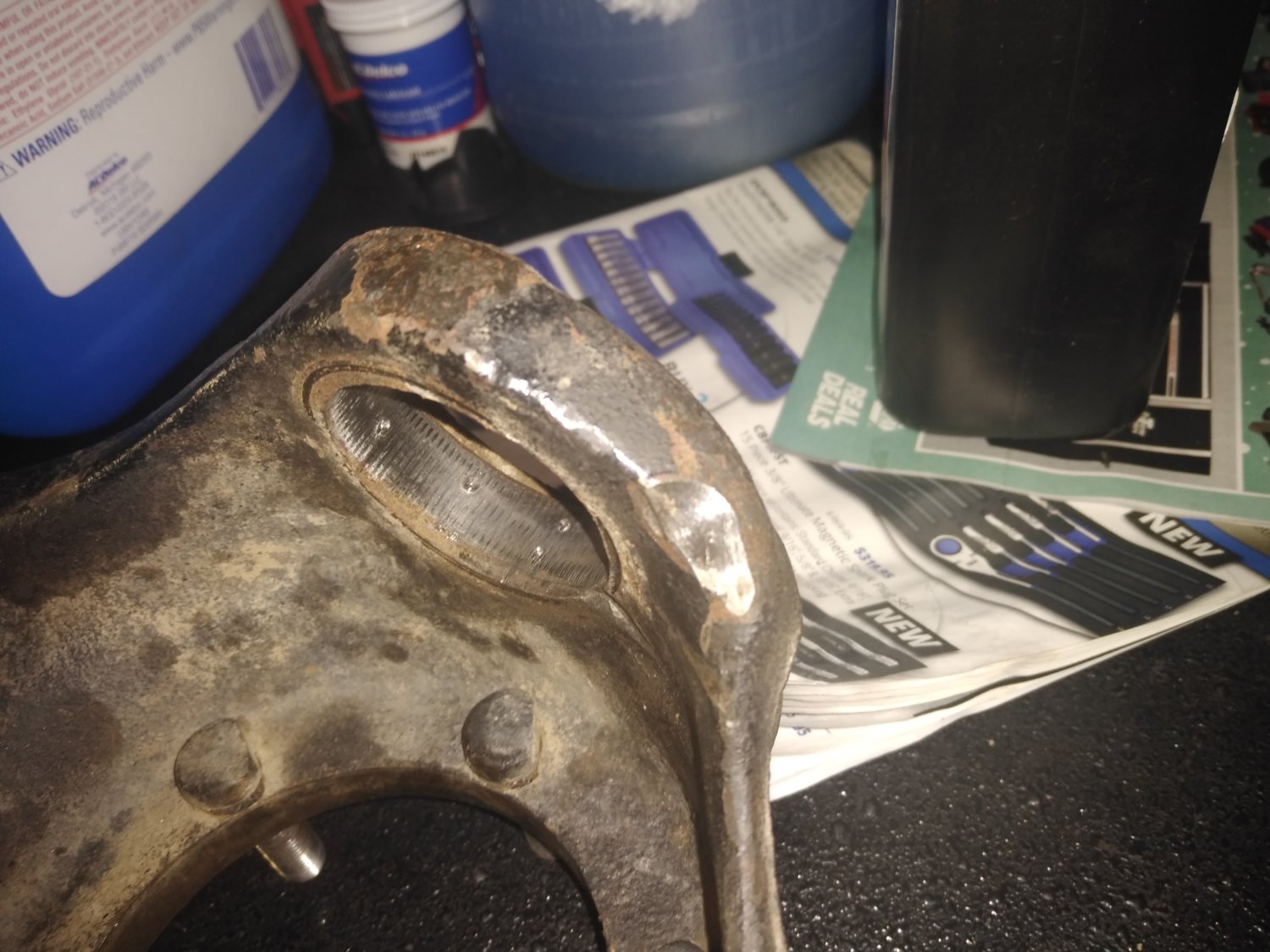

Hey @Bent77 I think there is a witness mark on the backside of the old knuckle that may be contact with the inner C. Take a look just to the right of the ball joint opening.
I need to compare to the spot on the C for a similar mark when I get home.
But at least the new to me knuckle is ready for install tonight.
That’s a nice dinger. Hard to tell unless you knew it wasn’t there before
It hasn't been there long. It's bright and shining, no surface rust forming on it. If I have matching spot on the C it was probably recent. Steering stop showed no signs of touching at all though.
