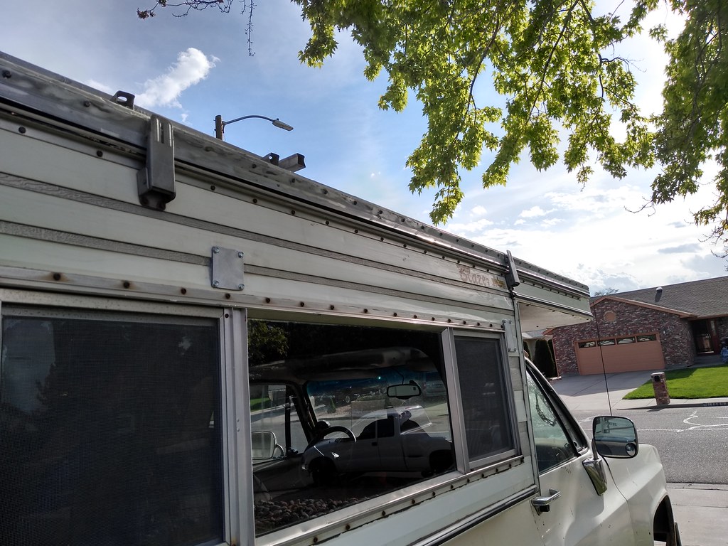

So it pulls in the front canvas as you close the top,,in my chalet there 3straps that you use to hold down the top,I have to stand on the bed-seat to do that
All the conduit does is lift and lower the top. The original lift panels had a section of elastic riveted to the center of the top panel to pull the canvas in as the top comes down. I had to add a short bungee cord to lower bar in the center to attach to that section of elastic still on the canvas. Without it, as the top goes down the canvas just pooches out where it's really hard to reach at the center of the front.

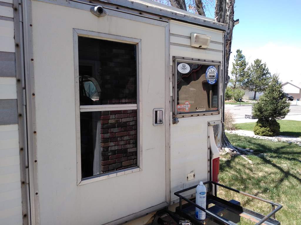

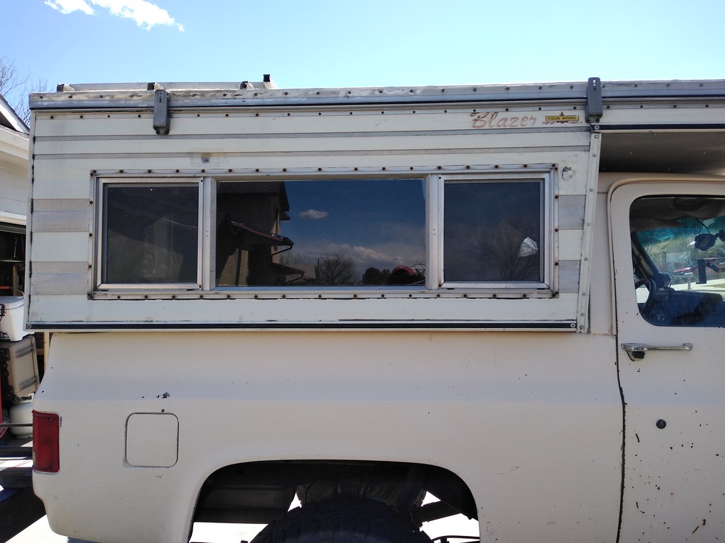

Tried my hand at window tinting this weekend. The camper windows really needed it to block UV and heat. After all the work, I think I should have gone darker.
You can see the lower pane is with the tint, upper hasn't been touched yet.
It looks ok, but it's not perfect. It looks darker from the outside too.

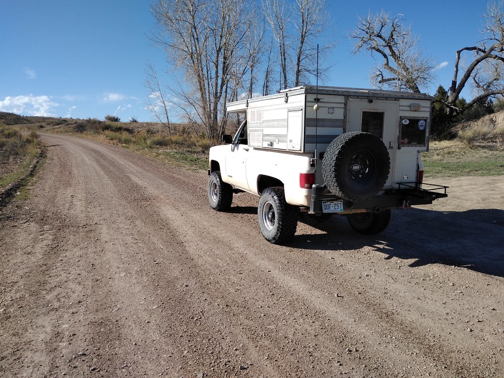

Got out of the house for a little while too. Just cruising the wildlife area past the local reservoir.

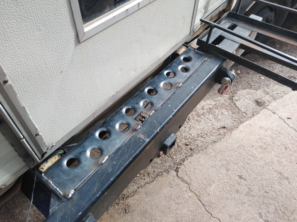

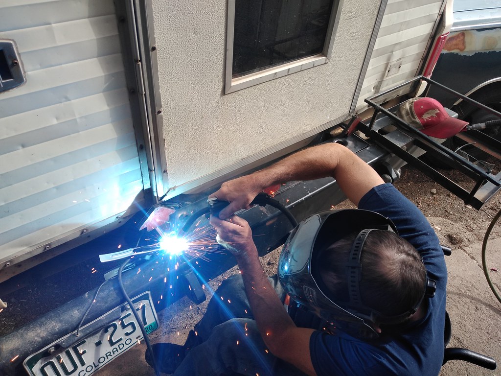

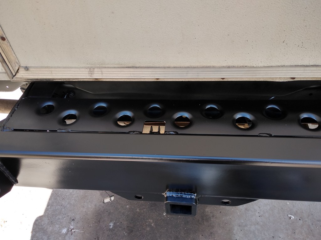

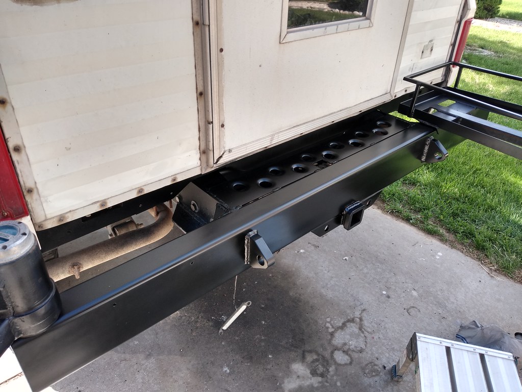

Finally got around to installing the step plate to the bumper. My buddy Bill burned it in. I still need to paint it, but it's nice and strong and fills the void between the bumper and the body.
It closed off the area just as I wanted it to. No chance of getting my foot stuck in between the bumper.
I need to get some paint and get it covered tomorrow. Going up for an overnighter next weekend to recheck systems and make sure it's ready for the big trip.

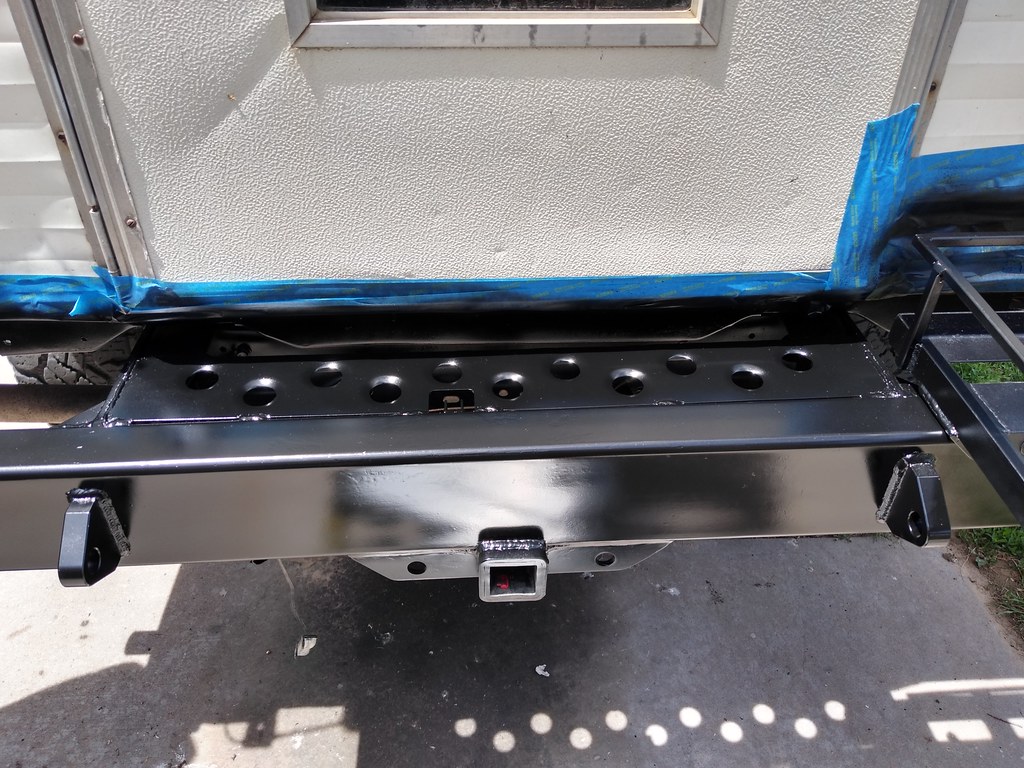

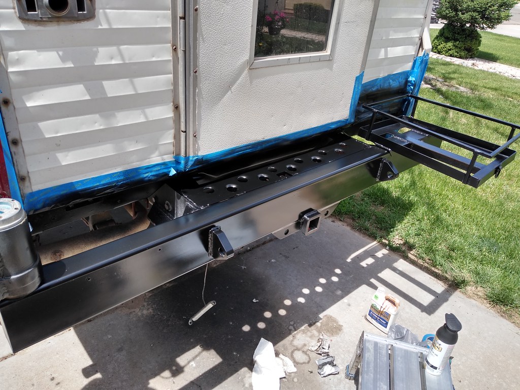

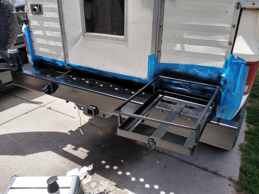

Paint is complete on the bumper. I went ahead and cleaned up the entire face of the bumper where it had been chipped up from use. I also took the time to shoot the back of the body under the camper that could still be seen. Just to clean it up and make it blend in better.
Tape pulled.

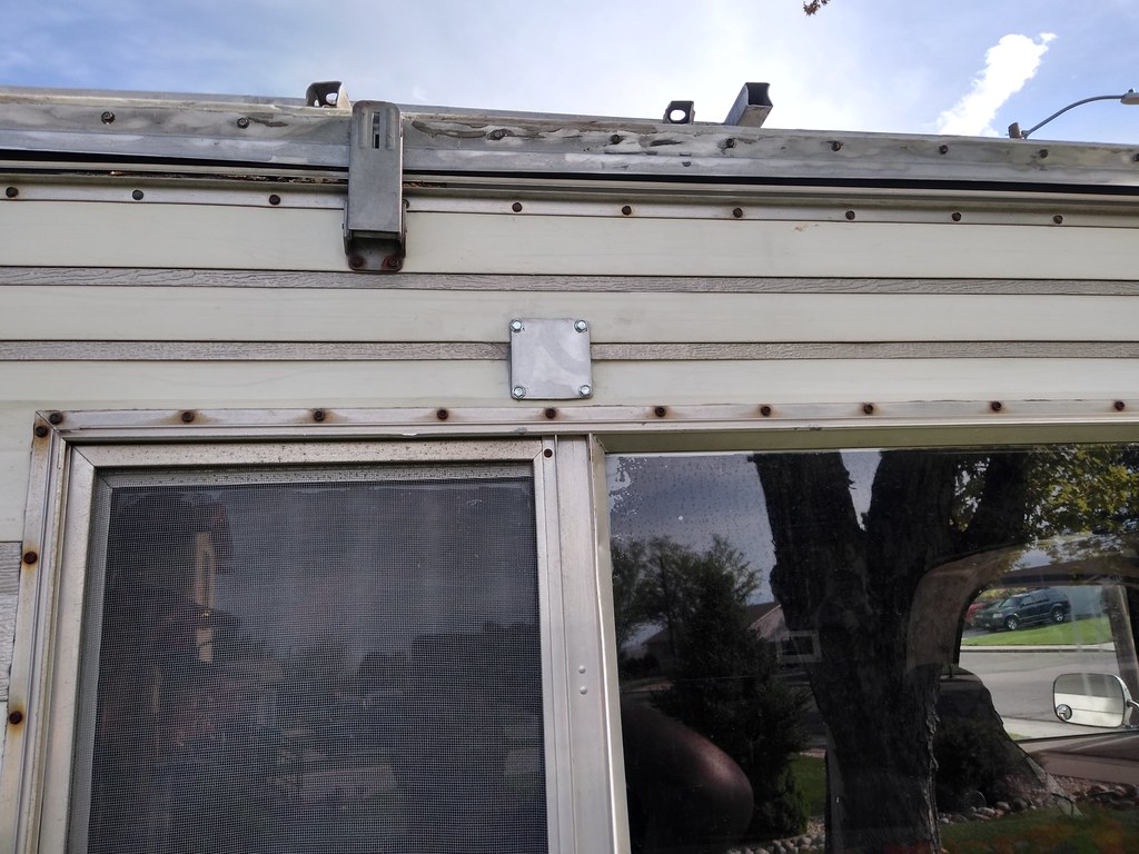

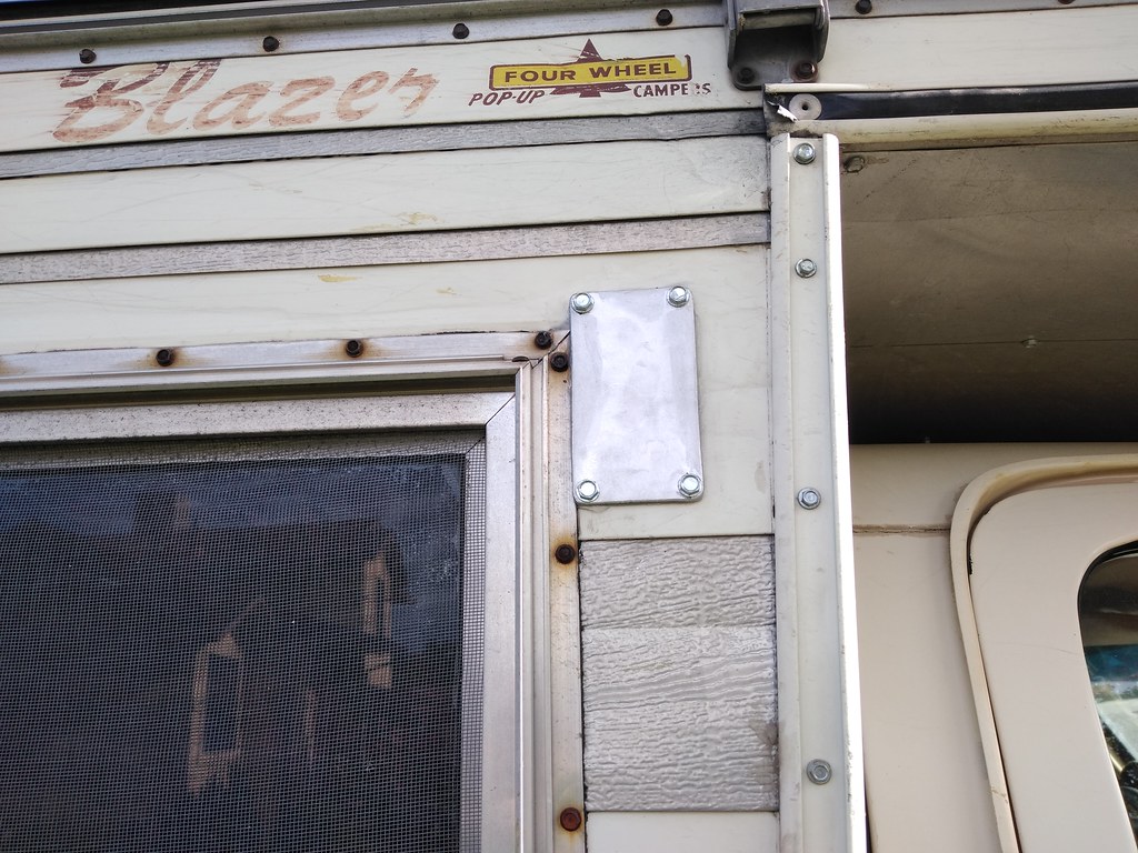

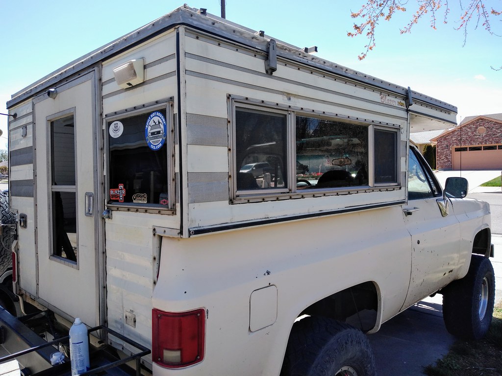

I also finally patched the two holes I punched in the side on Blanca Peak last fall.
This hole actually went all the way through to the inside. Stupid Juniper trees..

It's an idea but phase 2 will be to replace the existing siding with better material. I'm just trying to make it last for now. Ideally I'd go with the stuff I made the patches out of. Crazy rigid and light. It's a composite plastic sandwiched between an aluminum skin. It would withstand the tree branches better for sure. The funny thing is most pine branches I get into just flex and allow the truck to slide by. The junipers we got into just didn't budge. We really had no business being in them, but we got bored.

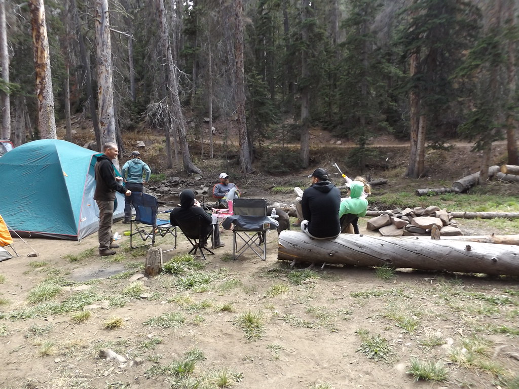

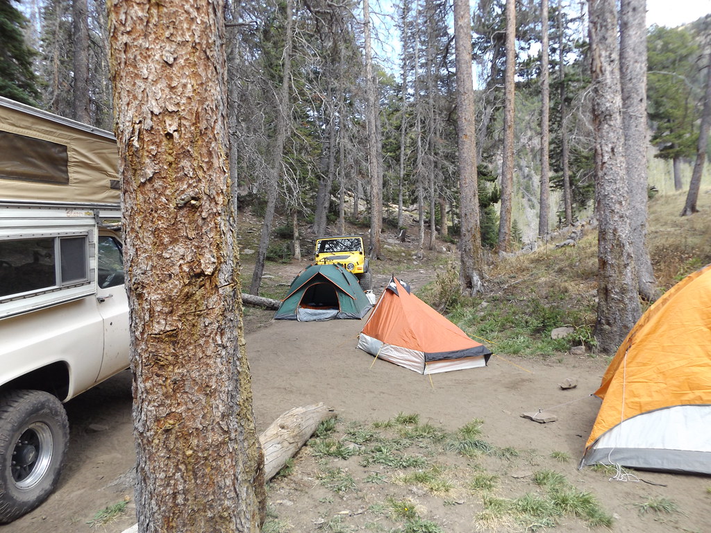

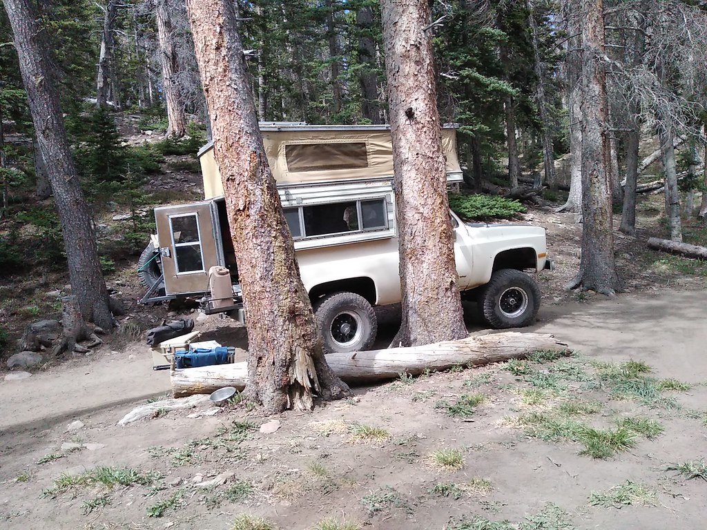

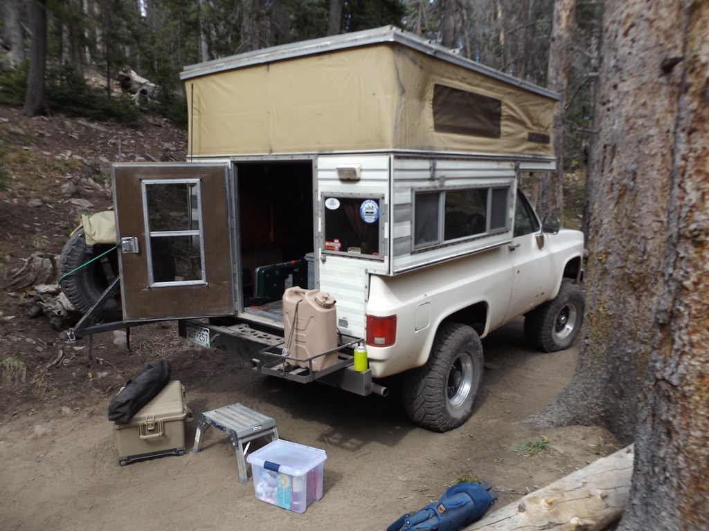

Five minutes within arriving at the campsite the truck barfed the gear out and the top popped up.
Hanging out.

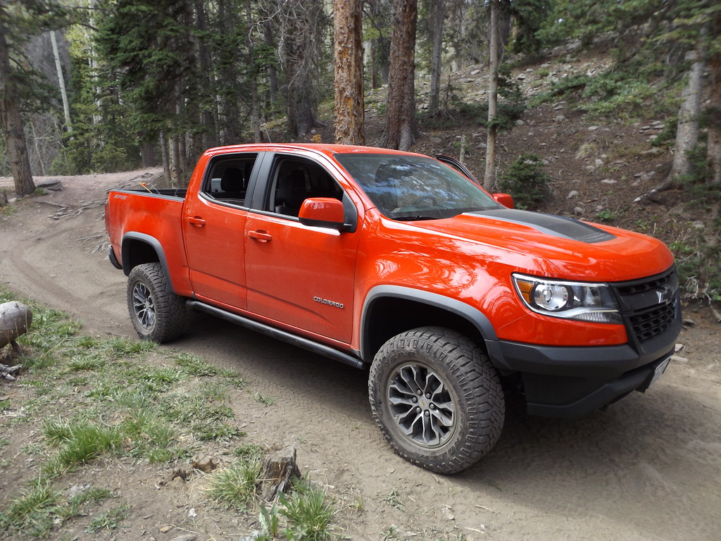

It was also the maiden trail ride for John's son Gino's new ride a 2019 ZR2 Colorado. It's a gasser which will prove to be less problematic over the 4 banger dirtymax version. It did great on the trail, but he needs to get the AEV skids for underbelly protection. These are great little trucks that we've sold a few of. Very capable out of the box.
I have to say I love being able to camp and sleep off the ground. Having the furnace proved to be awesome because the temps dipped deep in the 30's overnight.
Storm was happy to be cruising around camp checking things out.
Dinner was simple, John and his wife brought the burgers dogs and brats and I put the campstove into action to grill them up for the group.
The back of the camper and the bumper proved to be a good serving station too.
The run itself was pretty uneventful. I had actually made it 80% up the trail in 2wd and grabbed 4hi only when the steepness and loose rock required more traction. The drive down was good. Only issue with the truck is the turn signal switch won't stay locked in on right-hand turns. I'll grab a switch at work and swap it in before we go. The camper itself is pretty set and storage dialed in. I'm still amazed at the radios with the range and clarity they have over CB. One of the group had to get out of dodge quick as we aired up since rain was coming and they were in a Jeep with only a bikini top. They were 20 minutes ahead of us on the road and we still could communicate with them like they were within eyesight of us. The upgrade in radios should prove to be great on the desert trip with the group.
