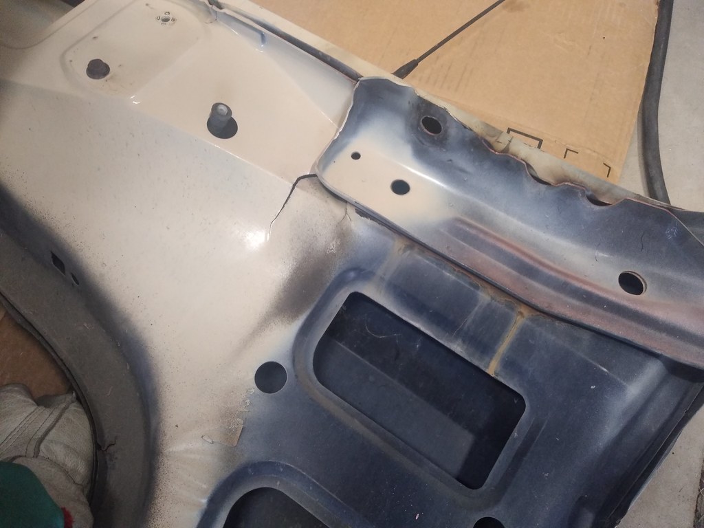

The annoying item was the passenger front fender. The upper rear bolt and bolt in the door jamb have backed off in the past and the fender starts itching the door and rattling. Considering the condition of the trail I did on back to back weekends I'm not surprised anything came loose. But it really had been getting worse to the point the dang thing was itching with it parked and the engine idling. I've got a higher threshold for squeaks and rattles than some but this was beyond my normal that was acceptable. Not having a welder at my house I got a message out to Ian and he said to swing by on the way and we'll tackle it. I could make it itch by pushing in on the fender now and the door was rubbing the back edge of the fender as it opened. Checking the bolts that have come loose in the past found they were tight. Looking down on the top inside edge of the fender near the hinge we could see the spot welds from the outer skin to the inner support had popped. The panels had spread apart so we decided to pull the fender to be able to access the area better to clean up and weld.
This is the only non-GM sheet metal panel on the truck. Larry noticed this way back at the beginning but at least it was in one piece then. Pulling the fender exposed even more problems. The inner panel had a couple of major cracks coming down from the inner support that had broken free of the outer panel. The whole area was floppy and was the exact source of the itching noise I was hearing. You can see the cracks in the pic below. Stinking junk panel.
Ian was able to spot weld the outer panel to the inner in about 3x more spots than the Taiwanese aftermarket sheet metal worker did over there. We drilled out the end of the cracks and stacked tack welds to stitch it back together.
We found more cracks in other areas and one of the captured nuts for the battery tray to the fender broke out too. This fender is fubar and really just needs to be chucked but that isn't gonna happen before the trip. We muscled it back into position to line up the bolts and screwed it back together. There were no more itch/squeak noises at all. It don't make noise if you push on it or if the engine is idling. The ride home was silent. Thank goodness because 2500 miles or so of it making noise might have had me loose my mind.

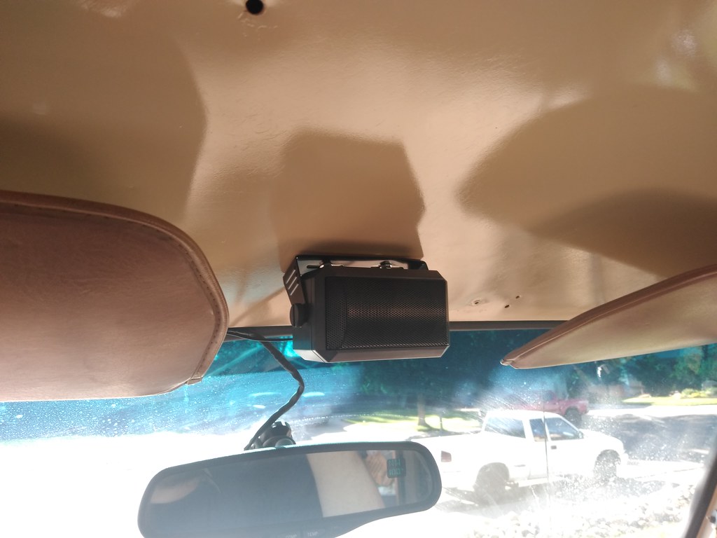

Tomorrow I need to repair a wire that was pinched under the battery and install an external speaker for the Ham radio. The radio is great, but having to run with the windows open had me straining to hear it going down the road. I plugged in the speaker and set it on the dash and tuned into one of the weather stations on the way to work this morning. I could be going 70mph with a window down and the stereo fairly up and actually had to turn the Ham radio down it was so loud.

Knocked out a lot of little things today. Swapped out the rubber exhaust mount with a spare I had and squared up the tailpipe while I was under there. Shot some paint on the fender where we welded it yesterday. Also repaired the wire that got pinched under the battery. I mounted the external speaker to the roof for the ham radio.

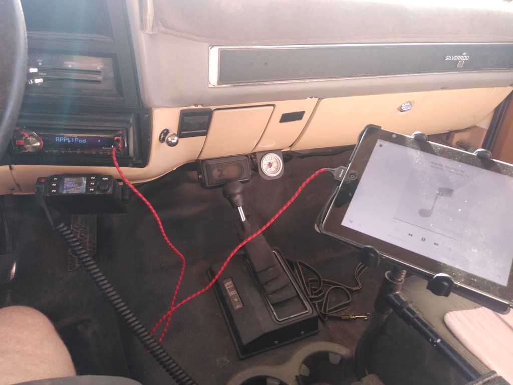

One thing that's got to be annoying on trips is cord management. There are so many things that ends up getting plugged in while I'm out it becomes to be madness with cords getting tangled with everything. I consolidated some. While cell coverage hangs in I typically run Pandora via Bluetooth to the stereo. But when we get out of range I switch over to an Ipod. I got to thinking about it and since I use my Ipad for the navigation I could kill two birds with one stone. Plug in the Ipad to the stereo and I still have tunes and it keeps it charged so I don't have to run a cord into the console. The GPS receiver has to stay on the dash and normally I need to plug it in after a few hours so I just hid the cord under the dash mat and pulled the end up through the defroster hole. The remote monitor for the ARB fridge has been plugged into a 12v outlet in the ashtray door, but the cord still got in the way. So I plugged it into the 12v outlet in the console and set the monitor in the cubby with the CB for easy access.
It may not sound like much but it slims down what needs to be plugged in by a bunch. Anything else that requires power is things like the gopros, bluetooth speaker, ect and those can be plugged in to charge inside the console or back in the camper where I have extra USB ports to plug into. It will go a long way to keeping my sanity.
