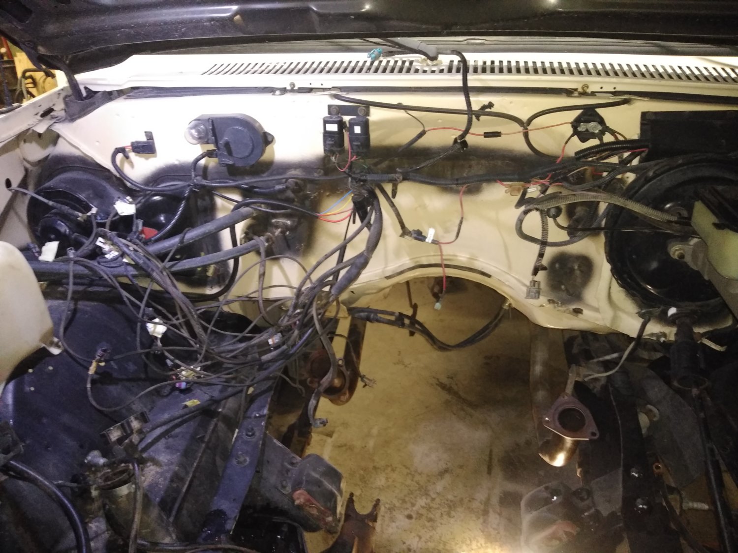

T-case came out first. Then came the trans. Topside the radiator and shroud are out. Fluids drained. Exhaust is disconnected.
Really down to the fuel lines, electrical and other loose ends.

I'll admit removal is a tad bit easier than installation. The engine is a little more tedious with the wiring, but Bill already has the engine mount bolts out. It's just sitting waiting for the sky hook. Heading over shortly. I do need to snag some donuts for my help on the way.

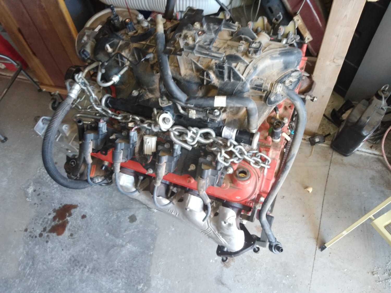

Had the engine out and the truck on the trailer by 12:30 today. The truck is back home at my house and the bay is clean where we made the mess at Bill's place.
The engine control harness came off of the engine easy but I still need to remove the ecm and the harness from the truck.
