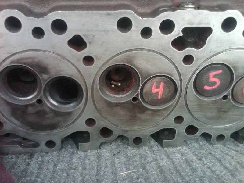

orings or firerings? firering sucks for street application.
for sure. my last 24v only had the cheap ARP 425 studs and orings. It held 80psi boost all day long.
the 24v and the 12v head :waytogo: orings.
fire rings..... :doah:

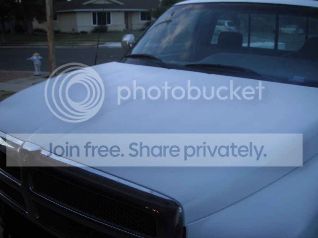

No more rainbow-fish as my sister has been calling it...

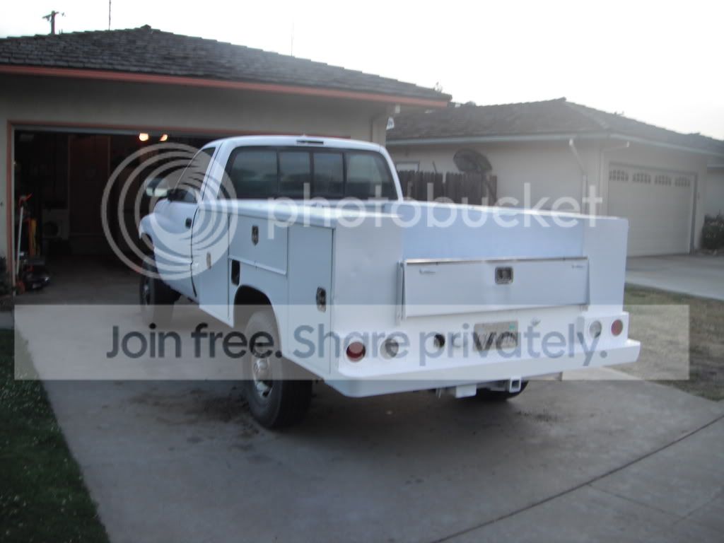

I like it, for about $100 worth of spray gun, paint and sanding pads I can definitely live with it. I like flat's so I went with a satin white.
I'm going to do bedliner on the bed/walls and rear bumper for better durability as well as some contrast. It kinda has that fridge on wheels look right now. :)
Nice did you paint it yourself??
Edit: Oops my bad didnt see the caption at the bottom lol. Looks great!!
Huge improvement over the "hillbilly camo" (one truck, with parts from 6 others on it :D) , the paint looks good from here :waytogo:.
Nice man. Makes me want to do mine even more.
Well out of nowhere it started raining today so I left the dodge in the garage just to be safe. I'm sure it's cured by now since it was fairly warm yesterday but just to be safe.
I was looking it over and started thinking about the service bed, what do you guys think about doing bedliner not only in the bed/rear bumper but on top of the boxes as well? They're going to take a beating (I noticed already I set junk on the top a lot) and it'd be like wrapping bedliner over the caps of a regular bed, it just has a really big cap. :)
I think the bedliner on top would look good, but it since you live in a blast furnace it might get really hot lol,
I would use the highest quaility one you could afford if you did. Out in the sun all day, taking a pretty good beating even when the truck is not in use.
But I do think that is a good idea
What he said. Herculiner probably wouldn't be the product of choice here.
