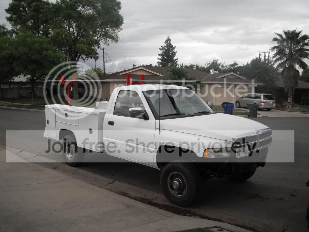

'94 Dodge service truck DD/Tow rig build
MMMM I love me some white on a work truck:thumb:
I agree that a pro job is the way to go on the top of the bed if anything.
Lookin good:D

Looks good Avery, and don't take this the wrong way, but for some reason if you decide to change directions, I would be interested in buying this '94 from you. I need another service truck.
I doubt you will, but if you did want to go a different direction, just letting you know that you have a buyer for the next 6 months or so.:thumb:

Oh sure now that I'm getting all the crap fixed now you want it. :D
Just kidding man, but in all honesty I don't ever see myself selling this setup. Once I'm done I'll have a solid truck with no payment, cheap insurance, cheap registration and I'll know all the bugs are worked out. Plus I think you'd have to fight my dad for it, when I'm ready to move up to something bigger I think this drivetrain will go in his '75 F250 Highboy and the dodge body will be sold/scrapped.

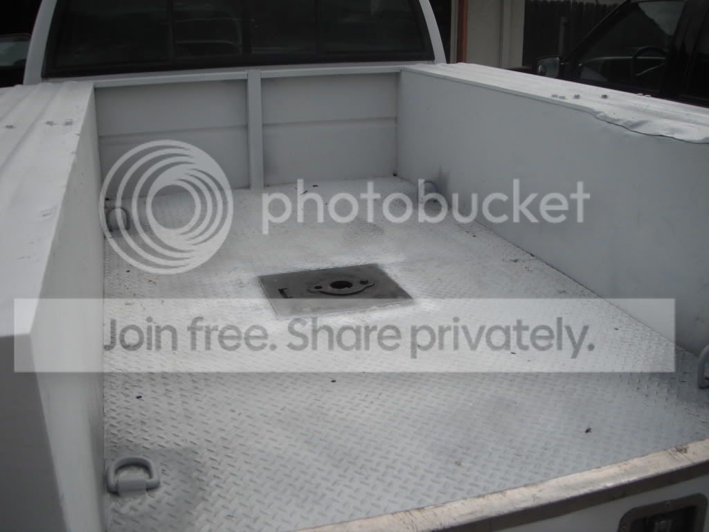

To keep things moving along on this truck I'm riveting new locks onto the service bed tonight so I can actually put stuff in there. I got one done to make sure it'll work then after dinner I'll put the other 5 on.

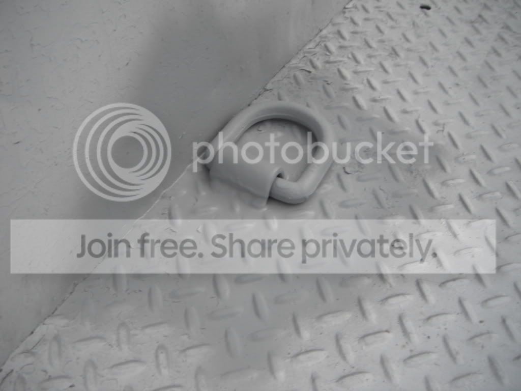

I started this afternoon by welding in some d-rings in the bed. I hate not having a strong/easy place to place a ratchet strap and figured these would do the trick.

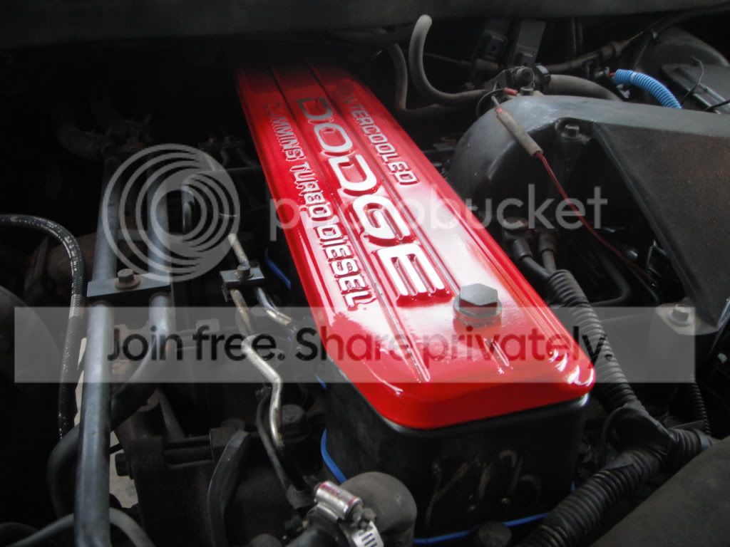

Next I pulled the valve covers off one by one and cleaned everything up and put new gaskets on. I figure it would have been an ideal time to adjust the valves but I didn't know how to do it so that'll have to happen another day. I couldn't put the old crappy cover back on so I did my best with some paint and sand paper then clear coat. :)
