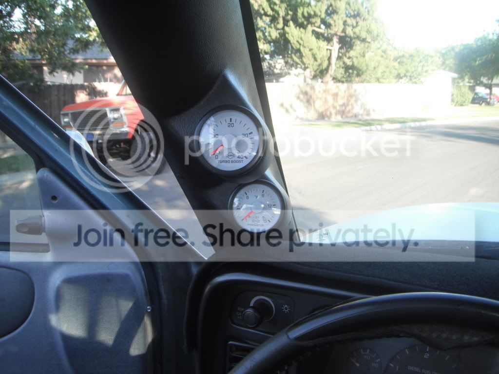

Ok onto the fun stuff. I got my gauges installed today. :)

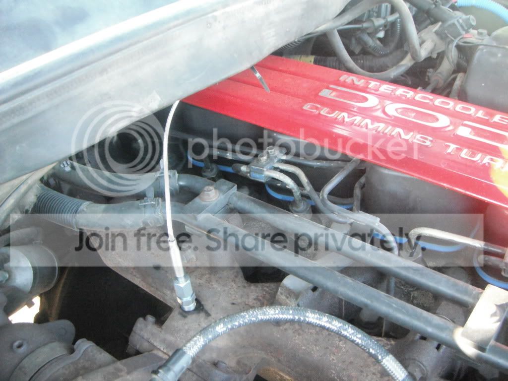

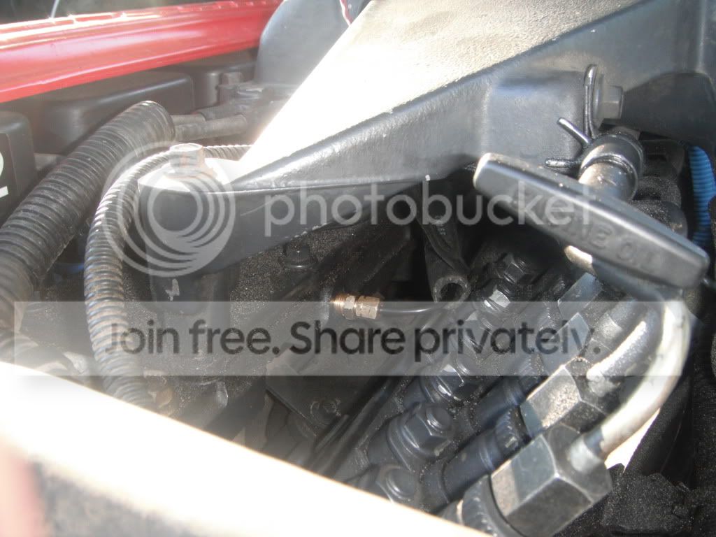

Isspro EV1's... just boost and pyro. I'll let the pic's speak for themselves...
I also got a fuel plate and boost elbow. I'll put them on this week sometime. I think all this truck needs to be "done" is a new windshield, a headliner, a good clutch and a decent stereo. Not too bad for where it started. :)
Looks like those gauges will be next expensive purchase too, they look awesome
I got my whole setup from Geno's Garage. If at all possible I'll continue to make all my diesel purchases from them. I got a new fuel shut off solenoid and a diode from them a while back and this order had my dash mat, gauges, pod and everything to make them work and it was priced very competitively and got here quickly.
They even included their own 3 page instructions/tips that were year and gauge specific that was kinda handy.

Since I last posted I installed a "0" fuel plate in the stock location and tuned the AFC housing.

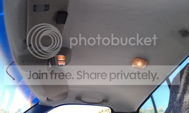

I tried my hand at a little interior work this morning. Nothing special but I had no headliner before, just the foam so I pulled it out, stripped the foam and covered it with some material.
Looks good. Need to do something like that with The Blazer's headliner.
LOL ok that makes sense! it looks really good what did you use to attach the new fabric?
Loctite spray adhesive. It was like $11 for a can but it worked great!
I got all the old foam off and scuffed up the surface then my dad and I laid the material out and folded it in half then sprayed that half and together laid it down and worked the creases out. Then we did the same for the other side.
I'm sure there's a lot of ways to do it but working from the middle out seemed to work pretty well.
I'm not sure what this material even is. I just went to the artsy fartsy store and looked around until I found something that matched and was really light weight. It's so thin you could stretch it and see daylight through it but I figured the lighter the better.
