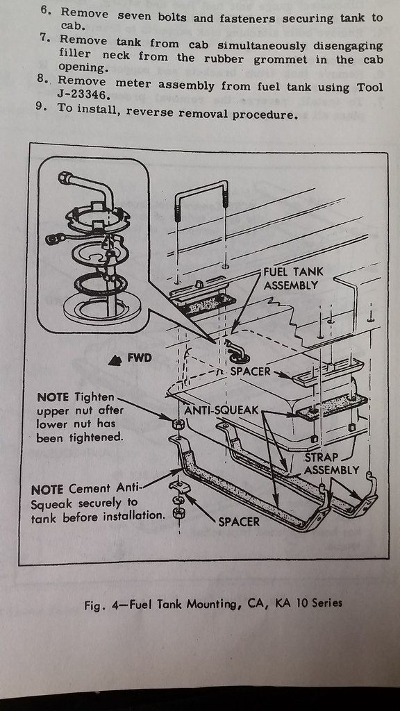

I wondered if the straps were integral to supporting the fuel tank. On a smooth road, maybe no big deal, but if you are flexing at all, I imagine there would be a lot of stress on the bolt locations and the tank itself if it is bolted directly to the frame.
In case you were interested this is how the original install was, before a new tank was put in:
The spacers and anti squeak at the frame might help you still. The way they have it bolted in the service manual also makes it so you don't have to get a tool above the frame to get the bolts off, so those U-bolts might be handy for you. I think I've seen guys make those, as getting them in the right dimension could prove tricky.
More than one way to skin a cat, as they say. I look forward to your progress!
That helps a lot. He just used standard hardware holding the straps so the u bolts would make it a lot easier for tightening up. Rubber isolaters would be nice too. I'll prob run the factory route then. Thanks.
