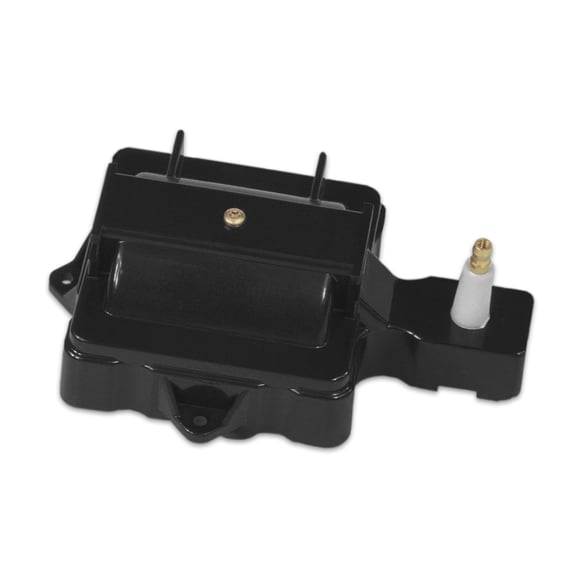

If you bought an external coil you need that little "cap adaptor" that you can plug a coil wire into the top of. It replaces the little coil cover so it has a coil terminal through it.

https://www.msdperformance.com/products/distributors/distributor_accessories/parts/8401MSD
