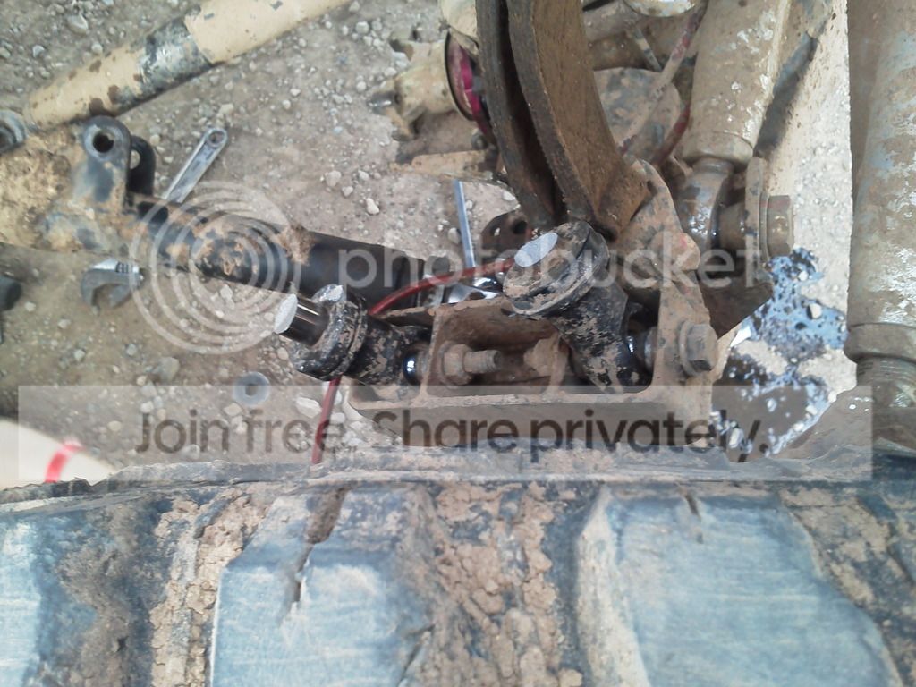

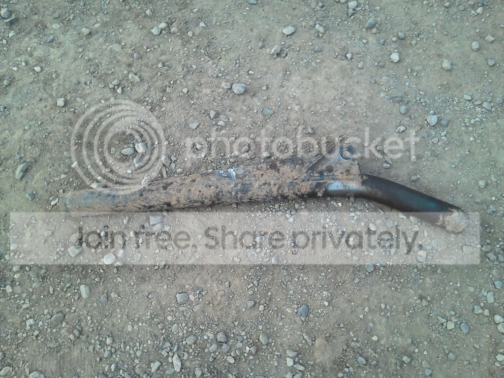

I am not a fan of radius arms in high speed stuff but they can work.
But sometimes they do this
And they result in this
build em STRONG
Wow that was a bad day there... blazing what would you build for links instead of rad arms? Thanks for the input I'll definitely build them as strong as I can fit.
